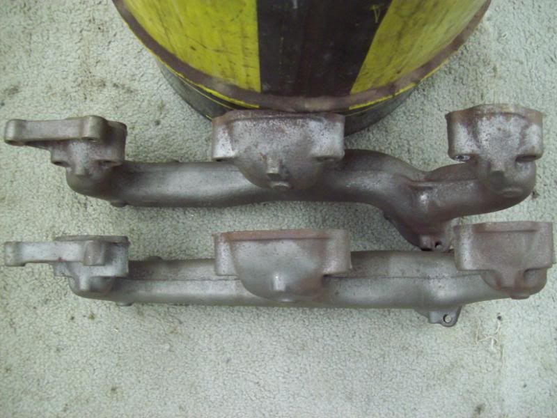

I went back to my earlier replies and re-posted the pictures. For some reason, Photobucket went through a period of crazieness and older pictures no longer could be seen.

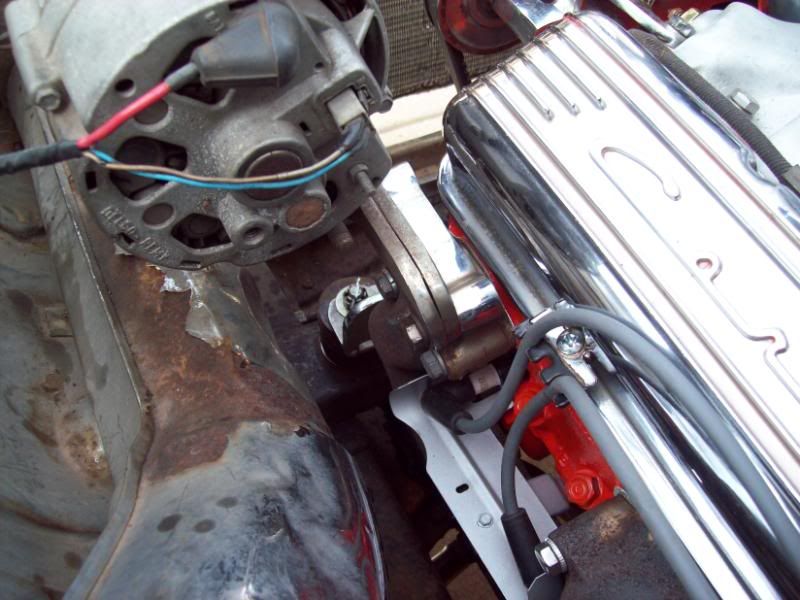

the later style manifolds, as shown above will work just fine. BUUUUUUUUUUUUUUT, I prefer the early Chevelle/Camaro style manifolds, ESPECIALLY the left side, because of two reasons.
First, the early Chevelle/Camaro style manifolds will allow easier access to spark plugs and routing of the plug wires.
Second, the 64-68 LEFT side Chevelle manifold has a bracket cast onto the front of the manifold for mounting an alternator, which makes installing an alternator SOOOOOOOOOOO much simpler.
I installed the first V8 in the 51 in 1967, and used the Chevelle style manifolds and they still work fine. I also installed a much earlier style air cond with a big under dash unit. It still works fine.
