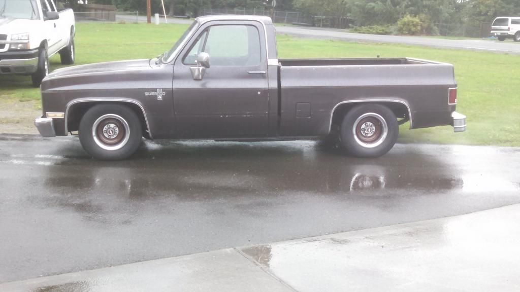

Hi All
I'm new the MC Forum. I just picked up a 71 Monte with a 2004 LS swap. I've had a couple of 70 montes back in the 80s and lowered the front by cutting the springs. I'm looking at lowering this one with 2" drop spindles.
I want to run 15x8 corvette rallies. Has anyone had any wheel clearance issues? I know on the Square body trucks I've done I had to grind the lower a arm to clear the 15" wheels when using drop spindles.
