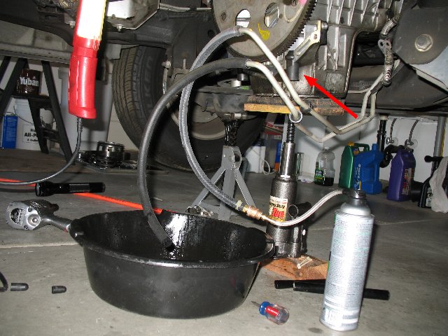

I have a 2000 Blazer, 2WD with the big V6. it has dripped small drops of oil for years. but now is it is getting worse. I cant tell if it is the rear pan dripping or the rear seal. very tight area, hard to determine.
does the pan have the 'O' ring style gasket? what are the black tubes at the rear of the pan. they have the most 'leaking' oil.
any help will be appreciated.
Thanks Rod in AZ

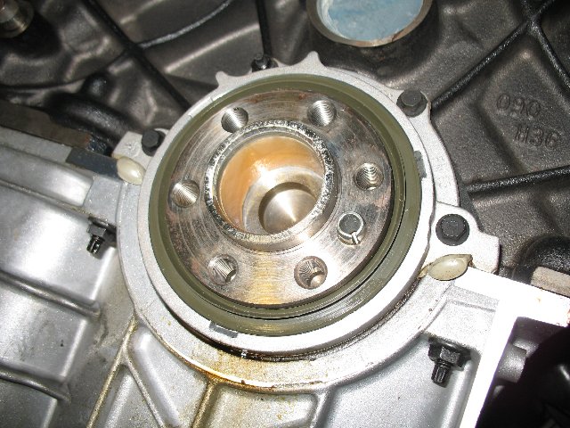

Is it over the transmission top? If so, then there are other possibilities. Check valve cover rear areas. The upper intake rear area. Finally, the oil pressure sensor. Over time, these areas are prone to leaks too. I've fixed a few. The 4.3 has a one piece rear oil seal. Usually they don't leak. However, old ones do.

If the oil isn't coming from the top, it could be coming from the pan gasket, rear main seal or the gasket that goes between the engine and the rear main seal "cap".
Those rubber plugs fill the access holes for the oil pan retaining nuts; there's no engine oil behind them. Unless there's a leak back there.
You might try removing the round, metal plug from the bell housing and/or try to remove those rubber plugs (they look kind of hard to remove), and/or remove the starter and use a mirror to get a look back there.
