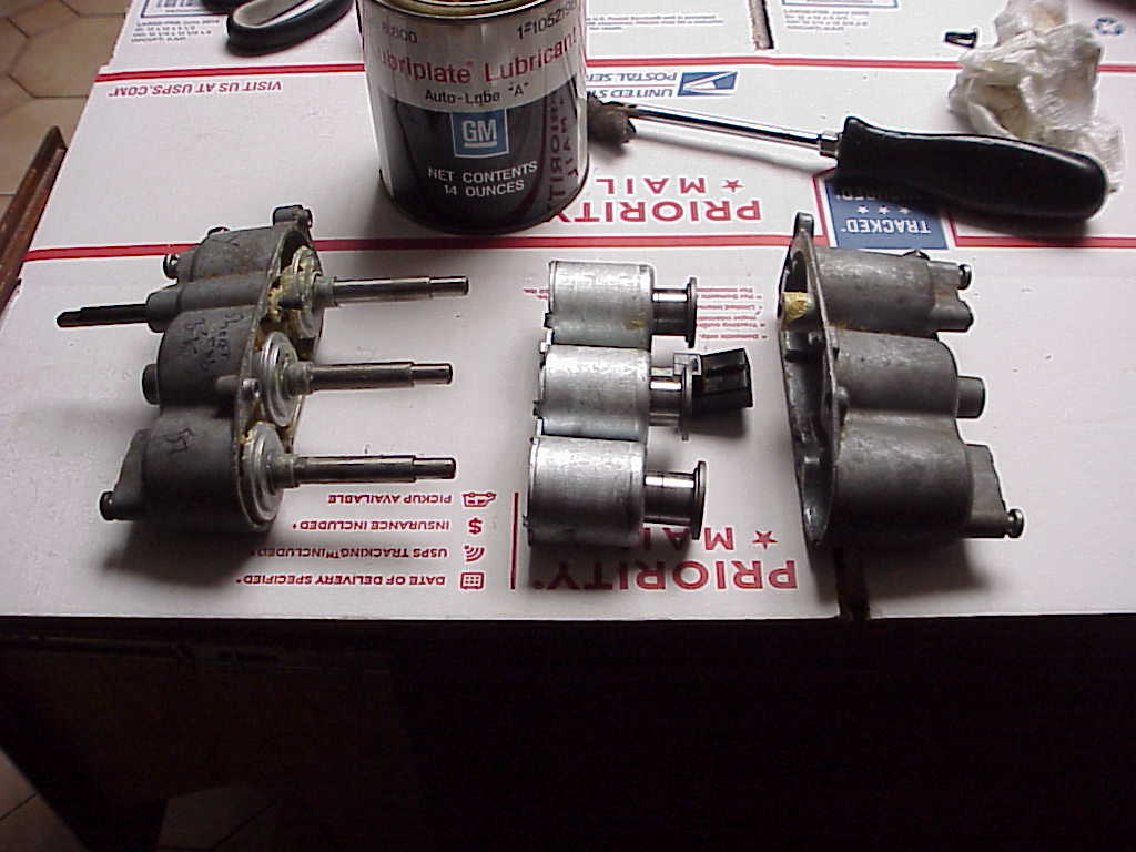

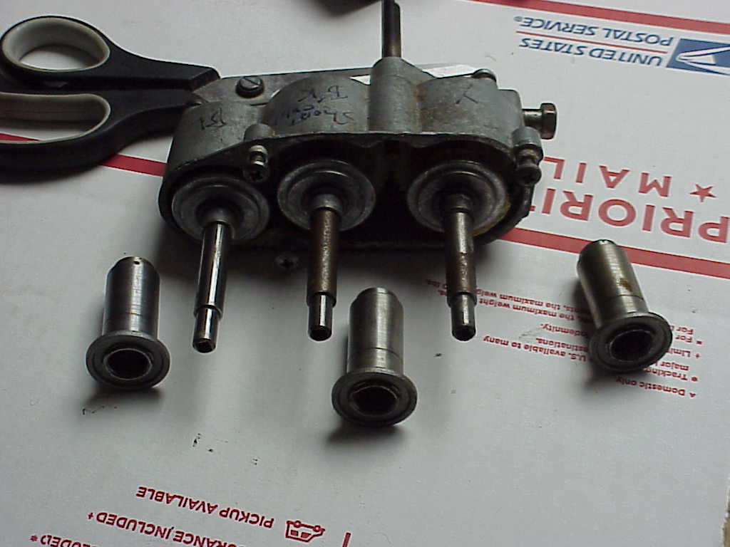

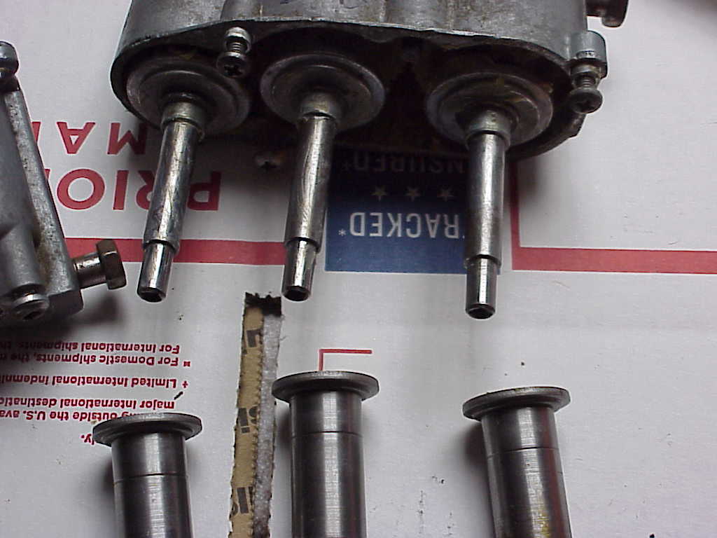

This particular transmission is out of a 1962 Chevrolet BelAir with bench seat. Upon opening it, I found that the steel shafts have rusted, causing the unit to malfunction.

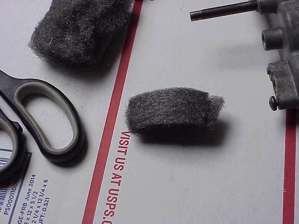

Since I had to remove the rust inside of the tubes that the shafts go through, I used a cut piece of 000 steel wool. I wadded it up, and pushed it into the tube with a twisting motion, and rotated it till it came out the other end. This dislodged most of the rust. I think that a better way to clean the tubes might be a gun cleaning kit.
Once I had the tubes cleaned, I then attacked the shafts with a Brillo steel wool soap pad, and got them clean enough to work. I also put a light coating of grease on these shafts. On this transmission, I found that the original white lithium grease was still working, so I used the same grease on the cleaned parts.

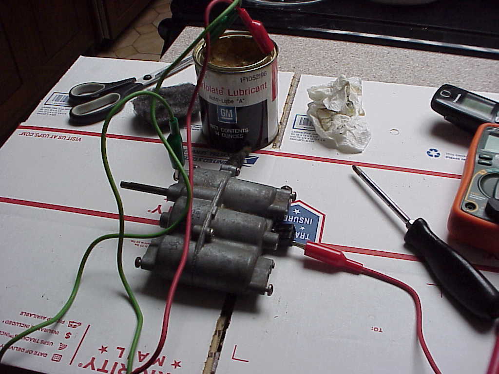

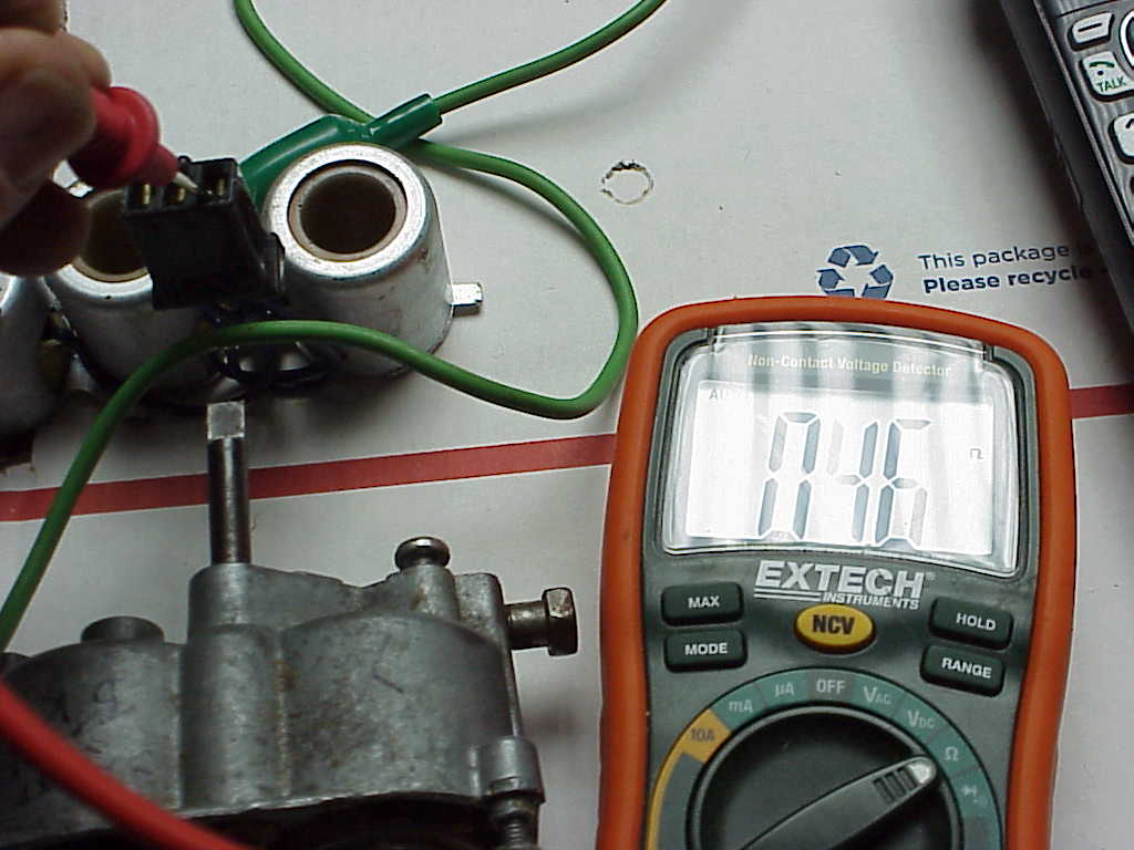

Once I had everything cleaned and lubricated, I turned my attention to the heart of the unit. The 3 electrical solenoids that cause the parts to move when power is applied. For this, I used an ohm meter. I am less concerned with the total resistance, then I would be with an open in the solenoid. When you have a bad solenoid, it needs to be replaced, since repair is seldom successful.
This picture shows the unit right before I screwed it back together.
Finally, comes the real test. Putting power to each solenoid. I had to do this out in the garage, and it is difficult to do this when the temperatures are in the 20's. For this reason, I have made a simulated "battery", and show how I tested this.
I hope that this tutorial will give you the confidence to tackle the power seat, and restore it to just like new. Need help, just PM me, and I will give you whatever assistance you need.
