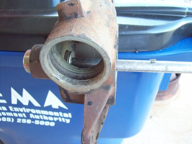

This is a rebuild procedure I learned to do long ago without any particular special tools or a scale (as illustrated in the service manual). The adjustments and preload on the bearings and sector roller are all done by “feel” and I’ll explain how it is done and what to feel for.
For a holding fixture, I use an engine stand with an old rail road tie plate drilled and tapped for attaching the steering box. A good vice would work just fine, but with the column mounted to a stand in this manner, it is mobile around and the box can be rotated to multiple positions during the rebuild.

After initial cleaning with some industrial strength degreaser and a power washer, the first thing to do is remove the sector shaft/roller by removing the four bolts on the side cover.

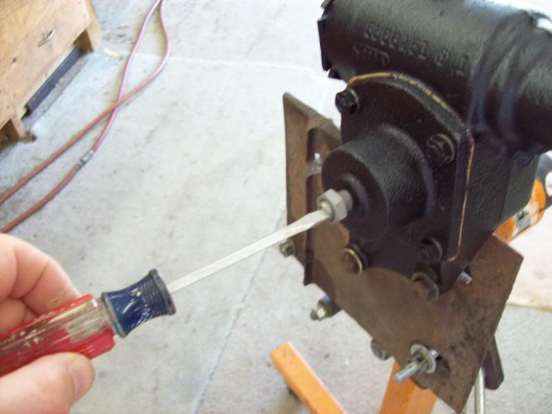

Once the sector and side cover are removed as a unit, loosen and remove the lock nut from the adjusting screw. Then screw the adjuster out of the side cover.
http://i65.photobucket.com/albums/h219/DZAUTO/Fr on...

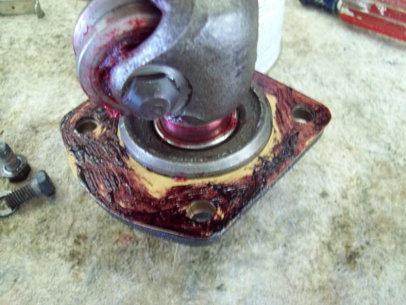

Loosen the big lock nut on the end of the steering box then unscrew the end cap from the end of the box. This will allow the worm gear and steering shaft to slide out as a unit.
At the upper end of the steering shaft is a bearing and horn contact unit, along with a split retainer which puts preload pressure on the upper bearing when the spring and steering wheel are installed. DON’T LET THE SPLIT RETAINER FALL TO THE FLOOR AND GET LOST!

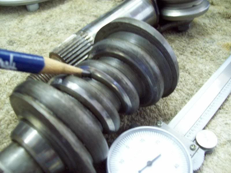

Also, look VERY closely at the contact surfaces of the worm gear and the sector roller for wear, chips or pits. If there is any detectable wear, it’s going to be a personal decision as to whether or not the parts are re-useable.

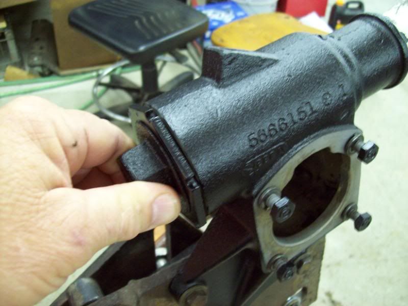

After blasting, the box, column, side cover and end cap were thoroughly blown out, flushed several times with brake cleaner and blown dry to assure no debris or blasting media were remaining inside the box, inside the steering column tube or in the bearing areas.
Once everything was clean enough to eat off of, the end cap and side cover were installed and the entire box was painted with a rust preventative satin black enamel paint (your choice of paint).

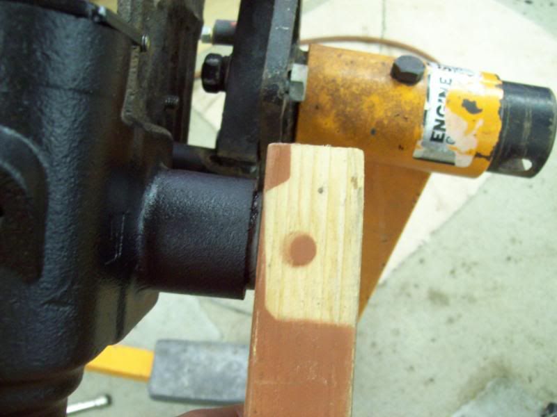

I positioned the bearing in the bore then started it in the bore with a block of wood and hammer.

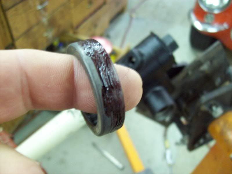

The new seal is now installed. I like to put a VERY light coat of sealant on the outer edge of the new seal. I use the Permatex in the large can with a brush in the lid.
I use a block of wood and hammer to install the new seal.

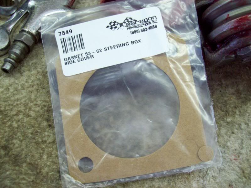

New side cover gasket.
I like to put a light coat of gasket sealer on both sides of the gasket, slip it over the sector and position it on the side cover.
