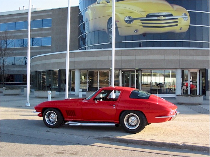

By the way, even though it's not a B-Body, I too favour the 15" wheel approach.
Although my '67 originally came with 15"x6", I am now using 15"x8" (front) and 15"x10" (rear). However, I am using the original '67 centers along with '69 trim rings.
The temptation has been there to try something newer, but newer usually means 17" or 18" which I won't do. I like the classic look.
