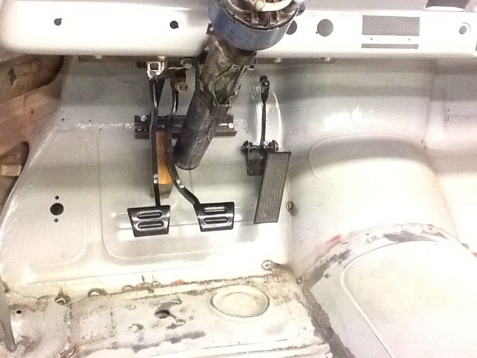

As you guys know, I am frugal to,a fault.
I found a Dodge Dakota pedal worked well. I did have to cut and weld one leg of the pedal to get the right geometry but it and a GM accelerator cable cost me a total of about 35 bucks.

Posts: 27764
11-13-17 03:52 AM - Post#2714214
    In response to 40grit
John, that looks good. What did your clutch and brake pedals come out of?

11-13-17 06:58 PM - Post#2714295
    In response to raycow
'69 Camaro. Believe it or not I stumbled across a fellow selling a complete after market changeover new in the box on Craigslist. 50 bucks got me pedals, rods, Z bar and bracket.
I was looking for the Nova/Camaro set up because the pedals both hang on the left hand side of the steering column. My thought was I could move the assembly toward the left to clear the big block if necessary but the truth is it was a non issue.
I also liked the period correct look.

Posts: 27764
11-14-17 10:57 AM - Post#2714349
Good catch!

11-14-17 06:21 PM - Post#2714389
Hi 40 Grit, John, that is a great example of thinking though the whole pedal assembly. It looks right and I am sure it will work right.
