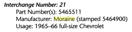

07-12-17 06:22 PM - Post#2699852
    In response to bigbowtielover
Appreciate the additional replies!
Booster's only stamping is a 5511 on the tang, definitely a Moraine design though. I jumped the gun and painted it but not a problem as I simply didn't want to apply a finish that would stand out as non-OEM. I did strip the booster and it doesn't seem to show any sign of plating but if I understand correctly it wasn't originally a bright and shiny plate. Guess it could be a replacement but doubtful.

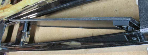

While the center console lid is not unacceptable I would like to massage her flat if at all possible. I'm assuming it's pot metal therefore probably very little that can be done with confidence to successfully straighten it. Anyone ever tackle this situation with positive results short of sourcing a new lid?

Posts: 26701
07-26-17 12:06 PM - Post#2701542
    In response to chlkorg
Does pot metal respond to heat? I mean can pressure be applied (without breaking the part) while keeping it safely below its melting point?
There's a line between good and evil no wider than a razor's edge - D.S. James Hathaway quoting from The Night Keeper

07-26-17 01:01 PM - Post#2701549
    In response to raycow
Thanks for the reply!
My understanding is that pot metal is much like your signature ("There's a line between good and evil no wider than a razor's edge.") in as much as there would, at best, be only a few degrees between malleability and melting. Was contemplating using the same method that was successful on the carb choke housing earlier in this thread. Sheepishly though, barring a tried-n-true fool-proof method of straightening, I'd be more inclined to live with the bow than chance breaking the lid.

07-27-17 07:36 AM - Post#2701633
You can heat it to straighten it . I do that often to repair bent potmetal parts at the plating shop I work at. It is tricky to do.

07-27-17 04:49 PM - Post#2701733
Thanks for the reply bigbowtielover.
You know I'm going to have to ask -- What might be the "trick"? Is it the heat level, rate of bending, total amount of bend, etc?
I was thinking to lay it on an open jig with screw pressure being applied evenly across the affected area. Slowly and incrementally increasing pressure while heating from below with a heat gun (or diffused torch if higher heat is required). Pretty much let it sag by itself as opposed to forcing a bend. I'm just really wary of the granular structure of this type metal and its propensity to crack.

07-28-17 12:43 AM - Post#2701790
I just grabbed mine and bent it by hand. Nothing to it.

chlkorg

chlkorg
Posts: 32
Loc: Maryland
Reg: 01-24-17
07-29-17 06:19 PM - Post#2701988
Mission accomplished.
Laid it on two parallel pipes with a flat backer on top. While heating the lid nice and hot using a heat gun it was slowly compressed flat by clamp. Left to cool it remained perfectly flat after removal from the jig.

07-29-17 10:44 PM - Post#2702014
It's softer than you think!

08-02-17 08:49 AM - Post#2702470
    In response to 6T5
The spring that helps raise the lid is what makes the lid bend....and/or having too much shtuff in console and hinge gets jammed. Most of my cars have had the spring give out and door still straight but hard to open.

"13th Year" Platinum Supporting Member & Moderator
Posts: 14378
08-03-17 03:14 PM - Post#2702697
I should of added that my spring was broken when I bought the car back in the early 70's. I bent mine with a slight underbow so that when the lock button is pressed, the front side of the door pops up. Of course, this is a non-permanent fix since the door tries to become flat again after time.

08-04-17 07:42 AM - Post#2702769
    In response to 427SS65
That was frugal ingenuity. More cojones than I possess! On the bright side, It's likely that 40 years ago you may have been able to walk into the Chevy dealership and purchase a replacement lid if the bend went boom. Offered you opportunity to build confidence in the process. My current wariness was driven by having read that pot metal becomes even more brittle over time.
