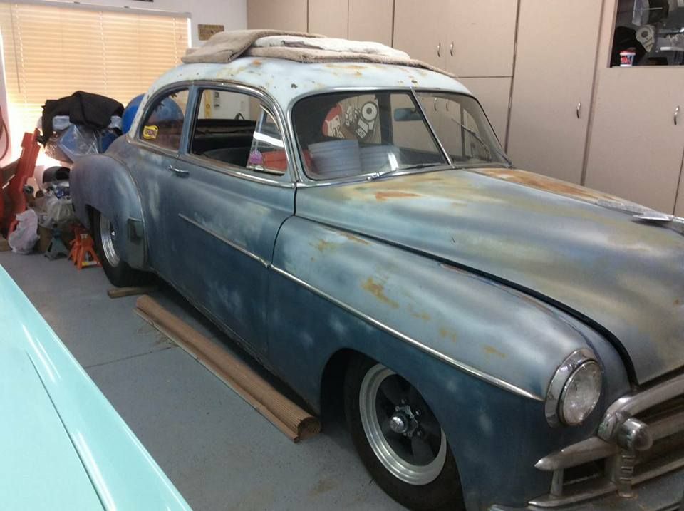

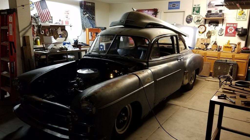

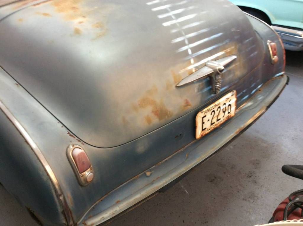

I picked up a 50 Styleline Deluxe a few weeks ago from the wife of the fellow who had started the project as a street/rat rod. HE installed a MustangII IFS, Ford rear end out back with new springs, a 350 Small block with a T-10 4 speed. I'm slowly going over the car and figuring out where he left off, as he passed away before completing the project. So far I have bought a replacement gas tank, aluminum radiator, HEI ignition, fuel lines, and some back up gauges while I get the others working. The car is in pretty good shape with minimal rust. The front floorboards were replaced, but the rest of the car is solid. I will be getting it finished up and on the road so I can drive it and take the previous owners widow for a ride in it, as she has a sentimental attachment to it. I will try and document my progress and post pictures when I can. I love old Chevys and I'm looking forward to learning and helping out as much as I can.
Picking her up.
She sits a little low I might have to put some bigger springs in it or get rid of the drop spindles. I'd like 2 more inches of ride height.
As she sat when I first saw her

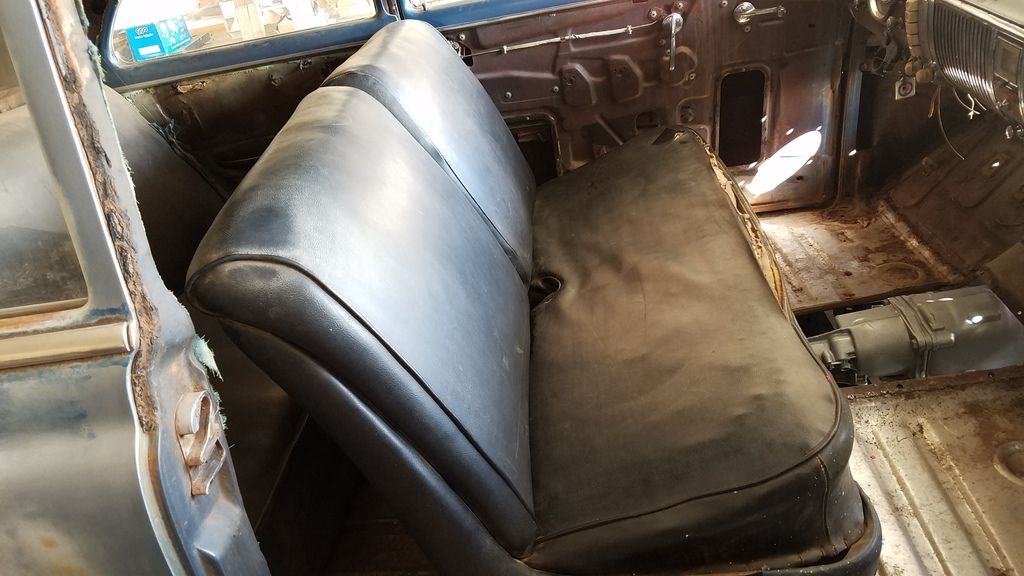

Interior: Dirty and a little worn but usable. Nothing seat covers can't fix for now.

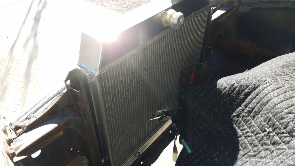

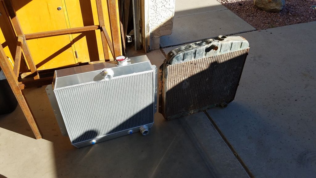

New Radiator versus old. Should cool better and save a few pounds. I had to trim the bottom of the support for it to fit properly, but other than that it was an easy swap.

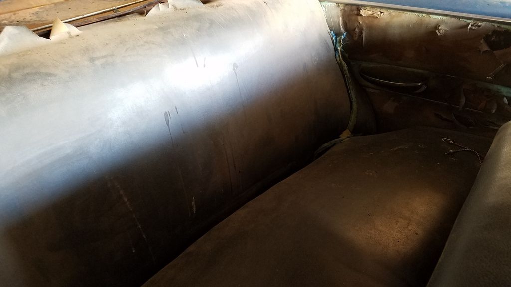

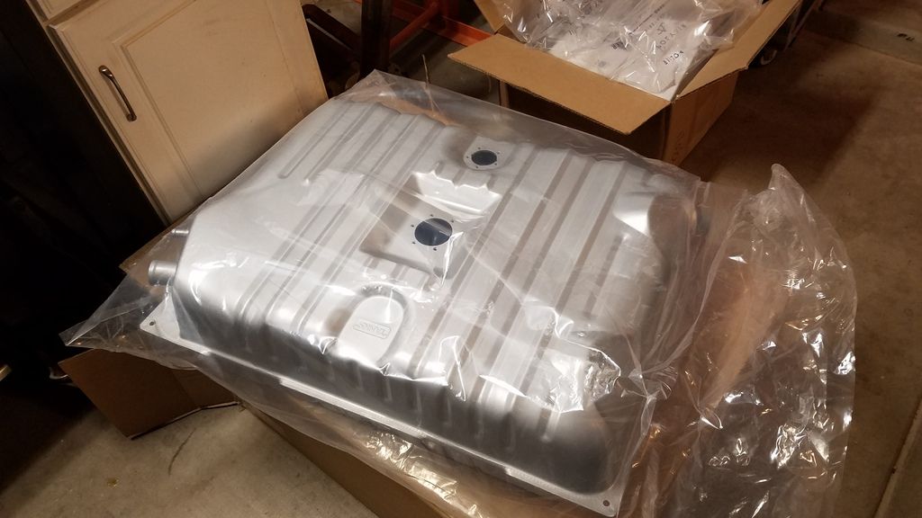

Shiny new gas tank. For the money its not worth messing with old rusted junk, plus its more capacity.

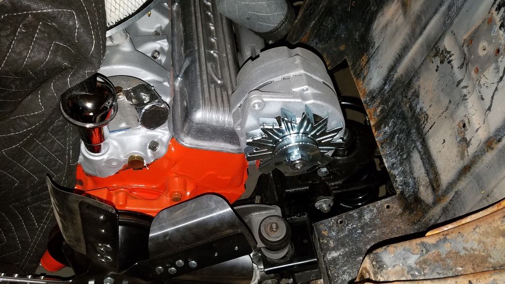

One wire alternator.

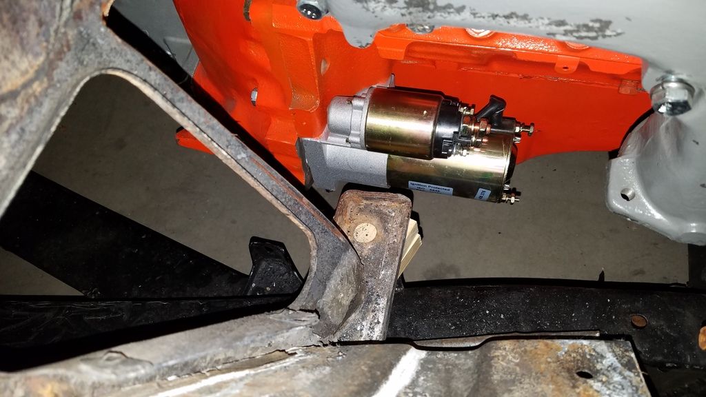

New high torque starter.
Stainless fenderwell headers

Hi Junkman, Re radiators, Alloy doesn't cool any better than the old copper brass radiators. Their coefficent of thermal conductivity is very similar.
Its just that alloy ones are lighter and cheaper because of the raw materials. Be very choosy about the brand as there is one Chinese made one that is a one year special. I think it appears here branded as a Fenix or something, but just rubbish.
Also I suggest you loose the flexi-lite metal fan as they are known to blow apart with age.(Metal fatigue.) There are plastic ones and OE ones that don't do that.
A shroud will buy you a lot of extra low speed cooling as it increases the fan efficiency about 10% for the most basic ones. A 63-4 impala drum one is simple and easy to mount and they are being repro-ed.
You may find something that works at a breakers yard but its also simple to make a fiberglass custom one.
What you tend to find with V8 conversions is the fan sits low on the radiator so its not in the optimum spot. The shroud wlll help with that if you find or make a tapered one.
What I like about the very basic Chevy one is it only aims to deal with the fan losses so doesn't cover the whole radiator which is a minus at speed. Also it looks easy to rework the sides to mount it where it needs to go relative to the fan.

If you haven't got the tank in have a think about putting a sealer product in it before its used.
Modern gass with alcohol added absorbs atmospheric moisture and is mildly corrosive so tanks corrode quicker.
I know POR15 make something but there will be other brands.

I have removed the fan already and will be going with an electric one.
Thanks for the info on the gas tank. I installed it last night, but I could easily remove it to coat it. I will look into it for sure.

Got the tank and new straps installed. I will be dropping it down to wire the sender as soon as I get the fuel lines plumbed in.

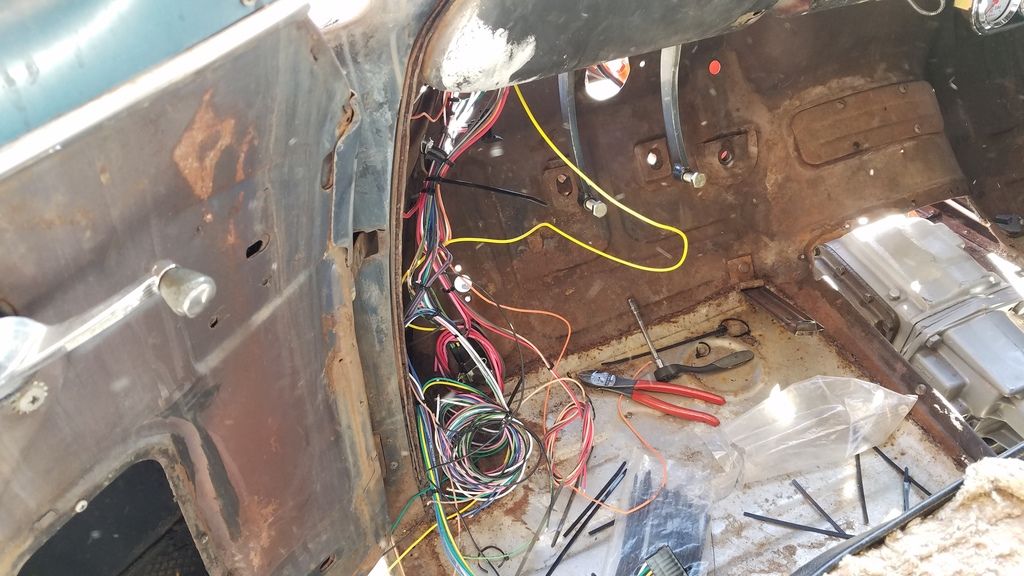

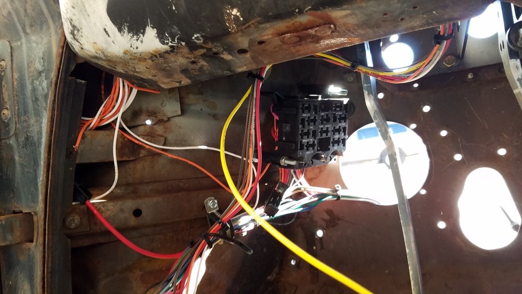

Received my wire harness from American Autowire and began the install. I am very happy with the quality and completeness of the kit. Although I won't be using a lot of it right now, its nice to have the capabilities to expand later.

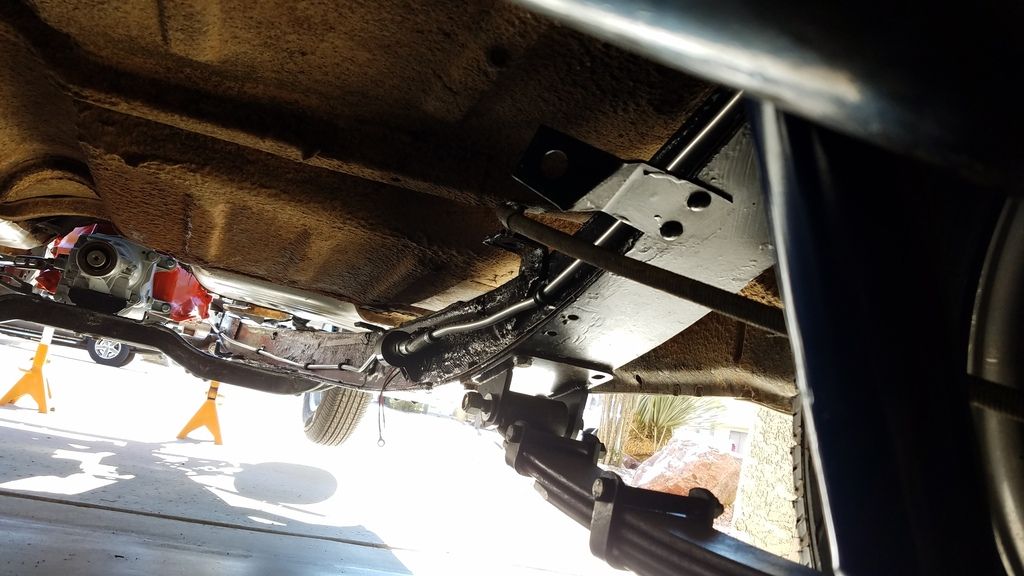

I also messed with the ride height. The PO installed these lowering blocks. I am going to remove them and start from zero. I may add a portion of the block back in depending on how it looks. The front needs to come up about 2 inches or so as well. I may ditch the drop spindles (not sure how to tell if they actually are dropped) or add a height adjustment of some sort. I found poly spring seat spacers I may try to see if they will work or build my own. I can't see spending $200 on spring adjusters that I am going to set once and never touch.

Hi Junkman, Good idea to loose a lot of those spacer blocks, that's a very unstable way to set ride height and if you want to drive further than the parking lot, not very practical.
You fender-well headers will nicely solve the starter motor BBQ issue many have, and probably steering clearances as well.

I have never been a fan of lowered cars. I am going to go with a height that looks good and is stable. I may have to scrap the drop spindles and raise the front a few inches to make it the way I like it. I will ditch the blocks and go from there.

Any chance you have an interior shot for the shifter and bench seat?
