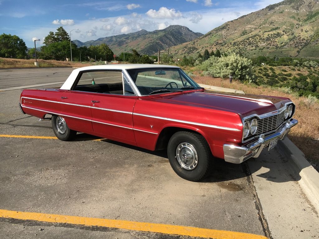

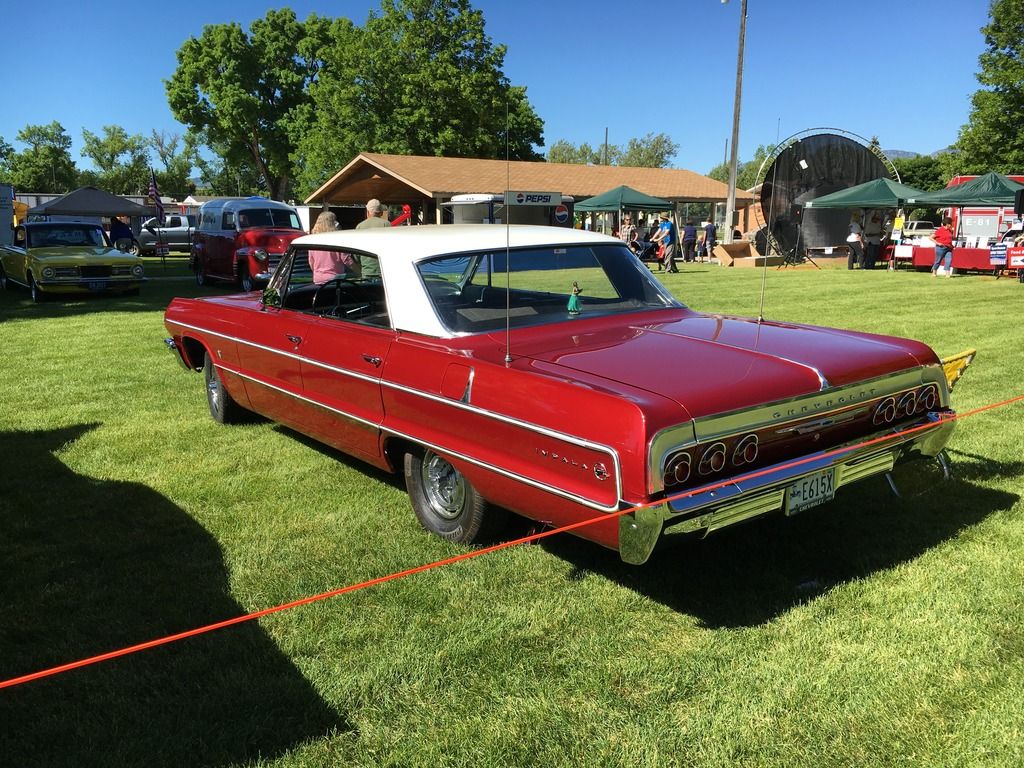

I bought a 1964 Impala Sports Sedan (4-door hardtop) almost 4 years ago. I say "fix-up" in the subject line because my car wasn't in bad enough shape to need to restore. However, when I think about all I've done maybe a restoration is somewhat accurate.
Anyway, I will post a before and after pic. Then please let me know if anyone is interested in what I have done to it. If so, I'll post some more and we'll see where it goes. I've done almost all of the work myself (mostly body work), so I've learned a few things. But it's a non-SS 4-door, so....
Before:
After:

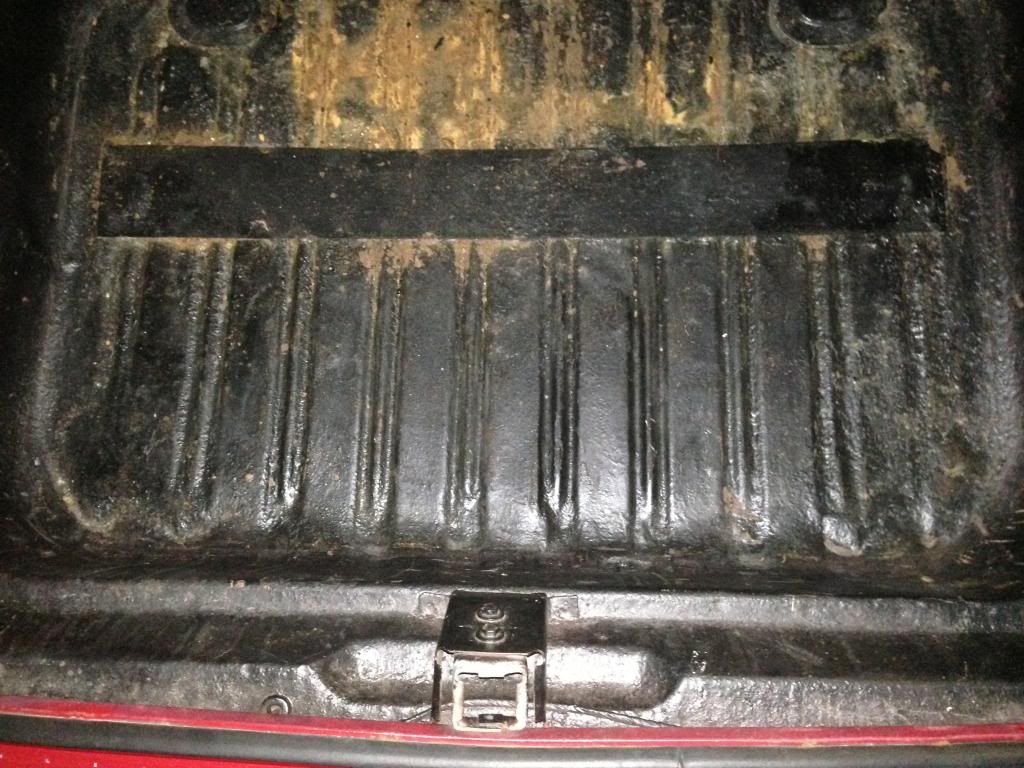

Like the 3 speed. It also has an overdrive, and with the help of Ray (last name?), I learned how to drive an overdrive. It's a 283 with manual everything. Maybe the best thing would be for me to respond to questions and describe things I did occasionally. The car when I bought it had a rusted out trunk and all the rear sheet metal was rusted. Also the lowest 8" of the quarter panels on either side were rusted. I found over the years that I avoided checking for rust and admitting to myself what was really there under the Maaco paint job. Finally saw it all when I stripped all of the paint off last year. MK
After:
Trunk when I bought it:
Mike Kuhns; 1964 Impala 4 Door Sport Sedan, 283, 3 Speed.

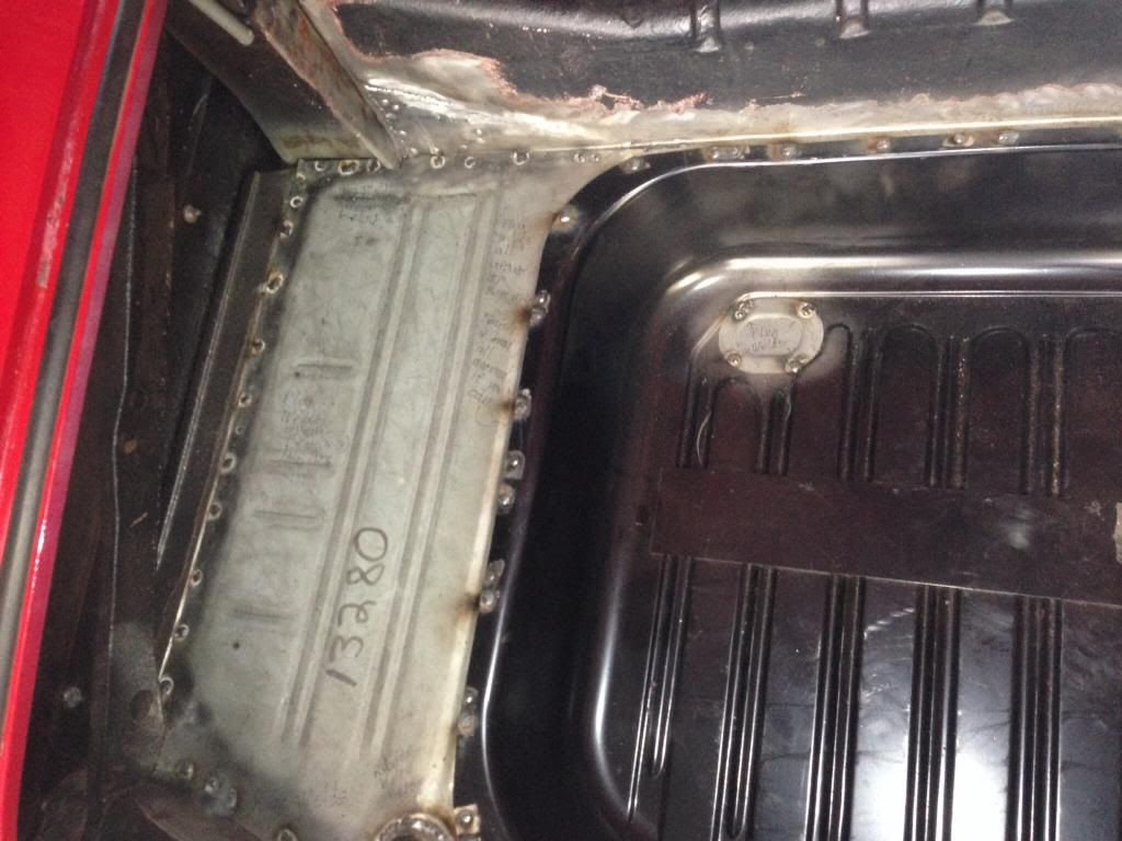

01-09-17 10:26 PM - Post#2670393
    In response to MRKuhns

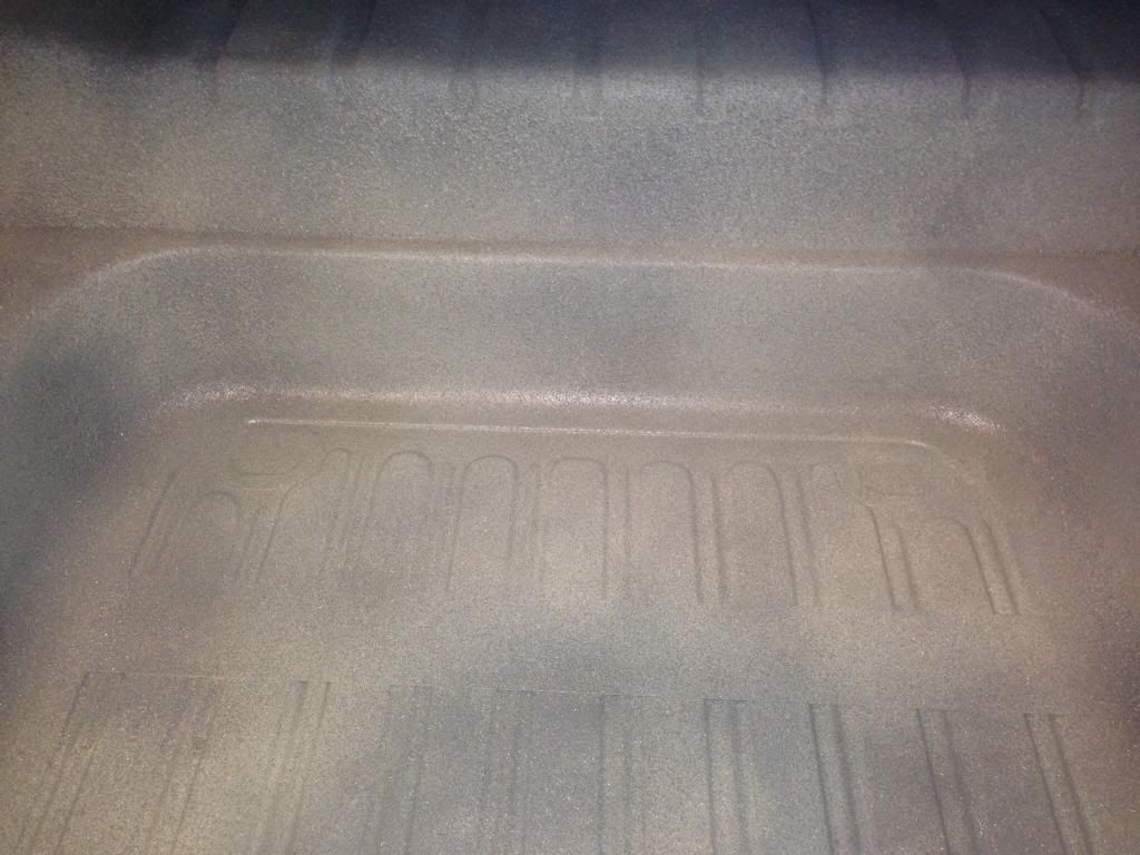

Trunk after replacement and paint. I used rattle-can spatter paint I bought at O'Reillys. Unfortunately it's no longer available. And no matter what anyone says, the paint is water soluble, and it needs a clear coat to be stable. The pictures were before I had a completely covering coat. The 3rd picture is the repaired trunk before some filler. I cut out the trunk floor, screwed in the new pieces, and had a body man weld in the pieces. Finally I smoothed the seams with filler and painted it. A year later I learned (admitted) that the tail light surrounds and the other rear sheet metal was also rusted out. But I fixed it and now it's good.
Notice the diagonal brace on the left side of the 3rd photo. Only found in the 4 door hardtop.
MK
