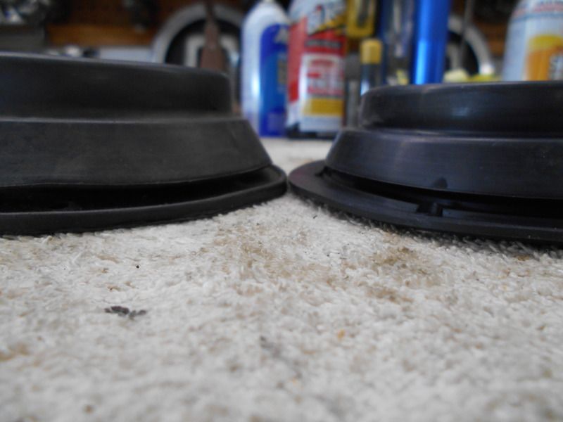

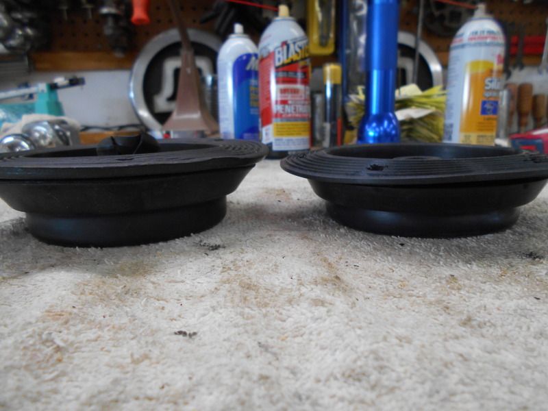

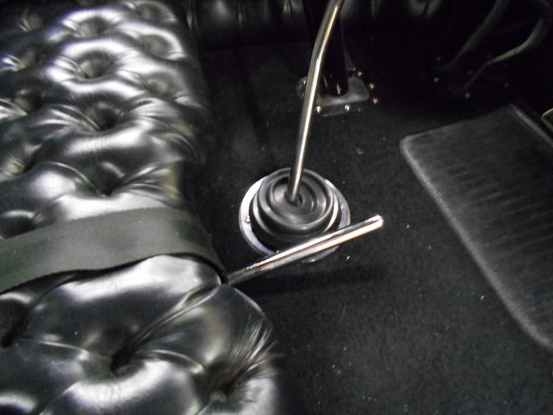

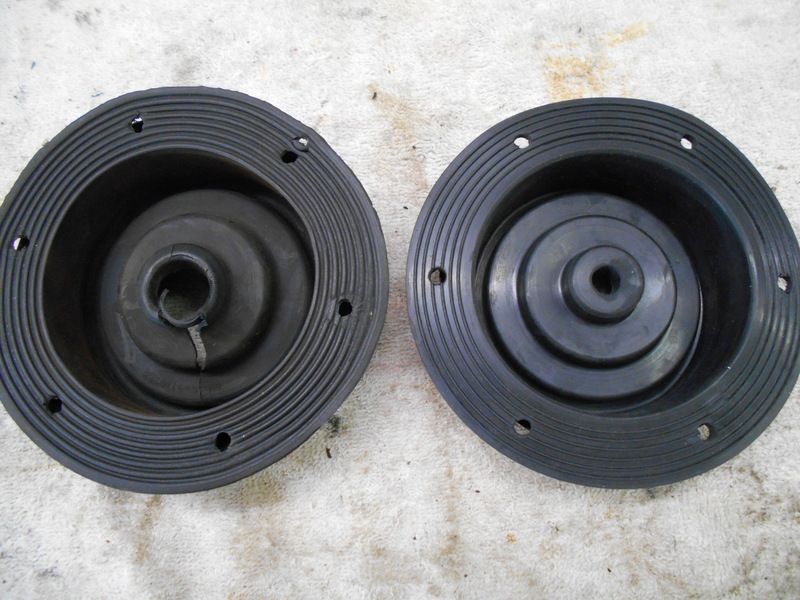

01-12-17 05:54 PM - Post#2670816
OK, the new boot (from Eklers Late Great Chevys) is in, and the quality is disappointing ------------------- BUT I NEEDED A BOOT because the old one had a 2in split and you could see the ground through it!
This is the boot that was in the T-bucket and as can be seen, the old boot has a flange which covers the retainer ring and 6 screws.
I thoroughly examined the old boot and could not find any kind of embossed/raised part number nor any GM logo. The old boot is on the left and as can be seen it is a thinner,flimsier material. We'll see how long and how well it holds up.
This is the new boot, installed, and as also can be seen, it does not cover the retainer ring and screws like the old one did.
Again, I'm not real happy with the new boot ----------------- BUT I HAD TO HAVE A NEW BOOT!!

Maybe, just maybe the new one is made from a tougher rubber than the old one. I guess you'll find out.

Tom, in a 63, the rubber boot and ring was bolted to the metal pan, then the carpet came down over the metal plate and covered it. It is tricky to get the hole in the carpet in the right place and the right size.
BTW, that gauge you can see the corner of is one gauge with both temp and oil pressure. Its a Smith and in the 62 Chevy it fit in the stock location for the clock. This is my Pontiac, dash has no easy place for the gauge, so it's hanging there for now.
For people wanting one gauge instead of 2, the Smith is a very well made unit.
