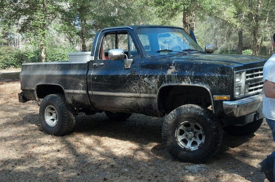

Background. My sons 1985 K-10. has a mid 70's 4-bolt main, moderate RV cam, edelbrock 650 carb. Engine has run flawless until a few weeks ago. he was just a block or so from home when he heard a loud "pop" as he called it. Obviously the engine backfired thru the PCV. Large black sooty area on Edelbrock carb base where the hose from PCV goes in. Tried to crank and no luck. checked gas and it was good. Checked for spark and none. Had 12 volts going into (new) distributor. removed cap and checked coil, coil was bad. replaced and truck still would not crank due to no spark. replaced ignition module and truck cranked up. idles fine but starts to skip when you idle it up (just guessing I'd say around 1800-2000 RPM's) Plugs look dirty, not oily or overly sooty, but not whitish to gray as they should be. Would the backfire thru the PCV screw up something in the carb?
