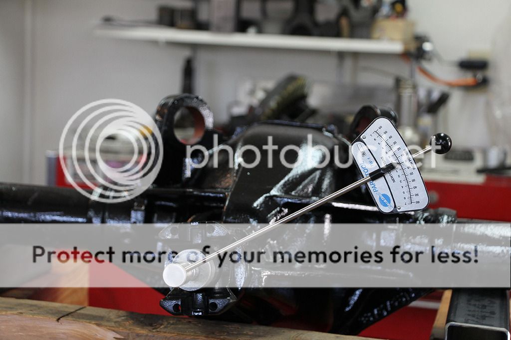

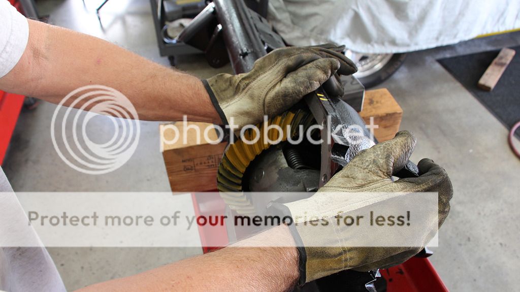

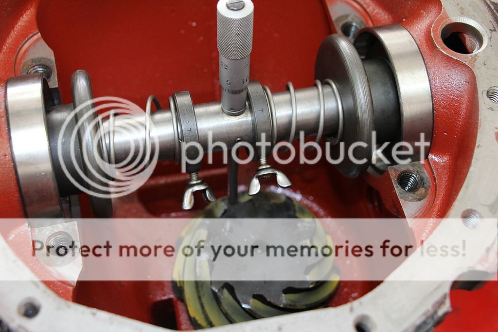

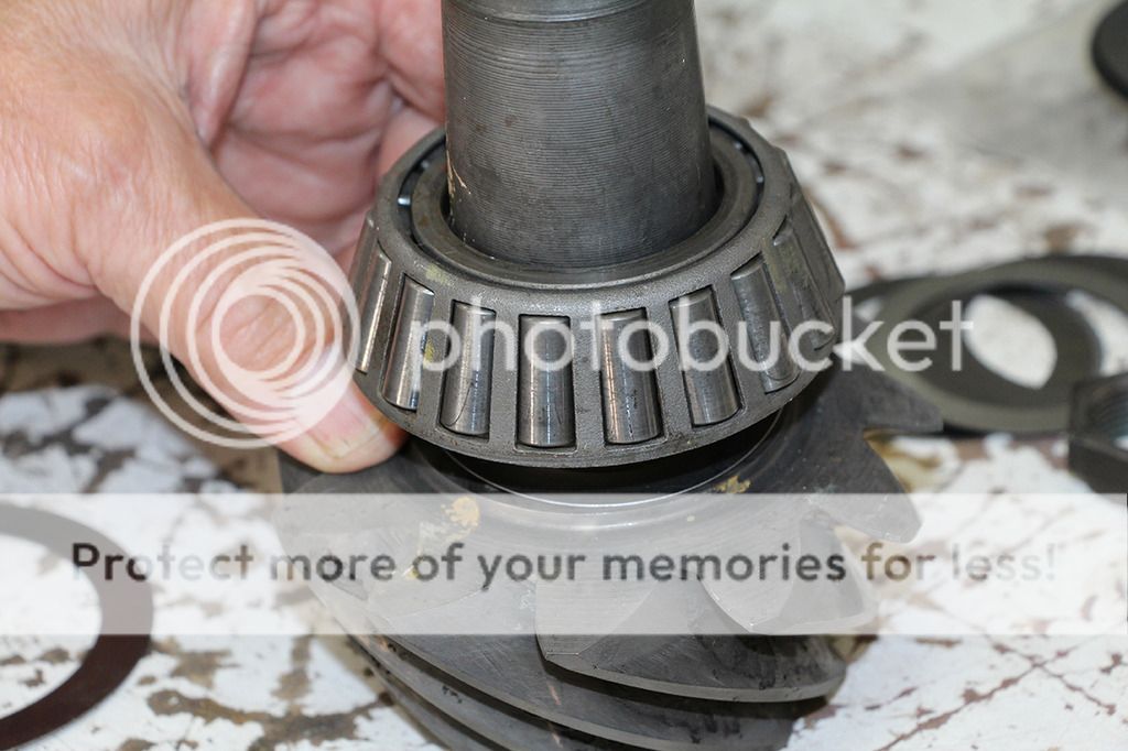

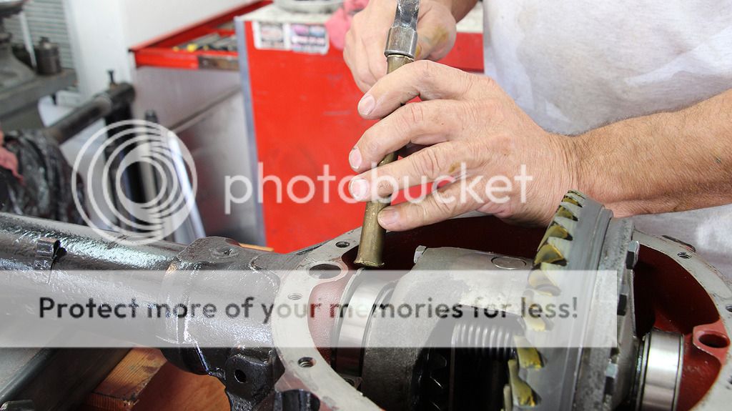

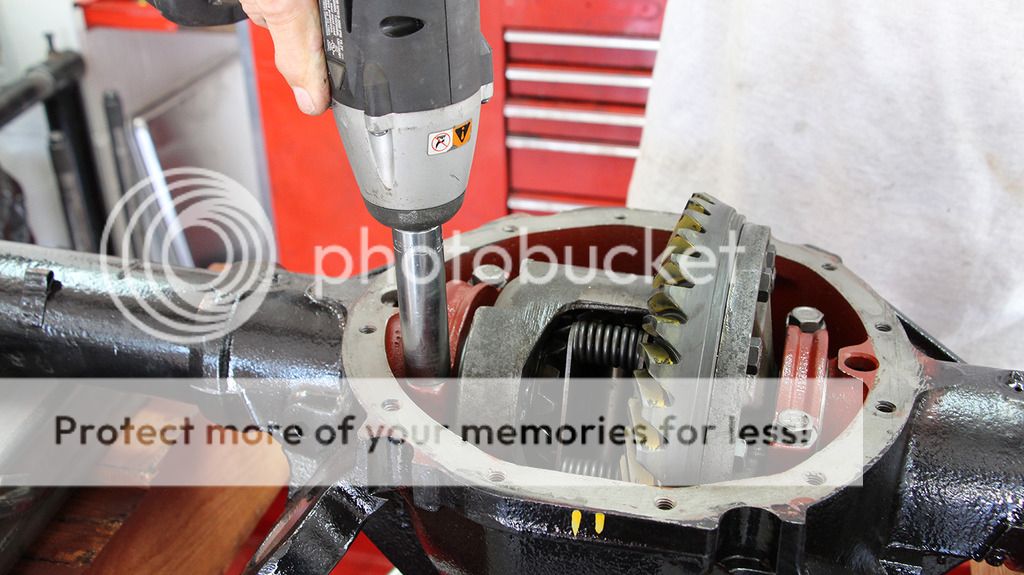

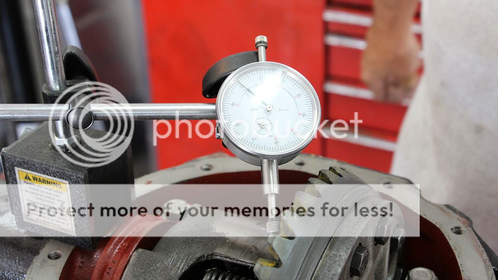

So this past week I got my 12 Bolt set up. Figured I show you guys how easy it really is. I end up setting these up for my friends because they think its some special magic but it really isnt too tough and if you want to do your own its a great excuse to buy some new tools
So your pinion gear is the first thing that has to be set up. They are lapped with the ring gear from the factory and so they should come with a number stamped in them which is your measurement from the end of the pinion to the center line of the ring gear.
To get the center line of the ring gear you need a special tool like this one. I've had this for 30 years at least but they still sell tools like this that will do the job.

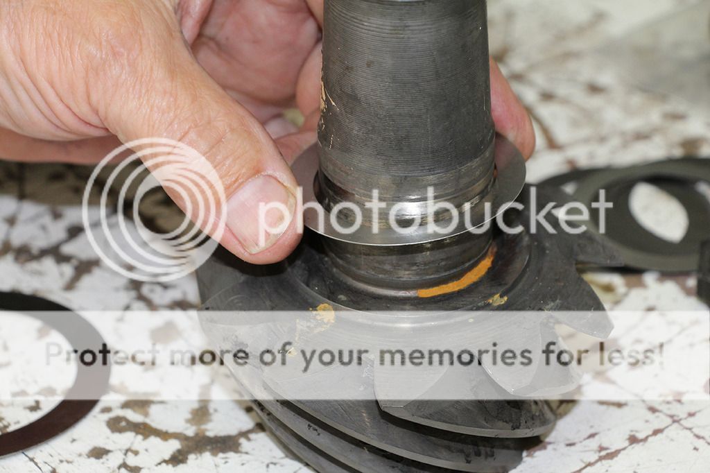

Before you set the pinion gear in you have to add shims and the bearing. I dont like using a press to get the bearing on and off so I take a sander to the inside of the bearing and knock off the black oxide and any imperfections so I can slide it on and off. I do this to an old bearing but once I get everything set up I go back and press the new bearing on.
I will guess on the shims for the first time to get a starting point and then go from there. The shims go on then the bearing.
Then you set the pinion in the case add the bearing from the outside and tighten it up so the bearing is preloaded.
The preload on the pinion bearing should be set between 20-25 inch pounds

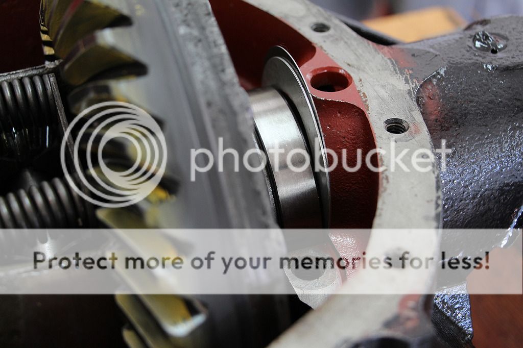

Then use the carrier bearing sleeves and your centerline measuring tool to figure out your depth
Then you just shim the pinion accordingly to get your depth. Once your depth is right place the carrier and ring gear into place.

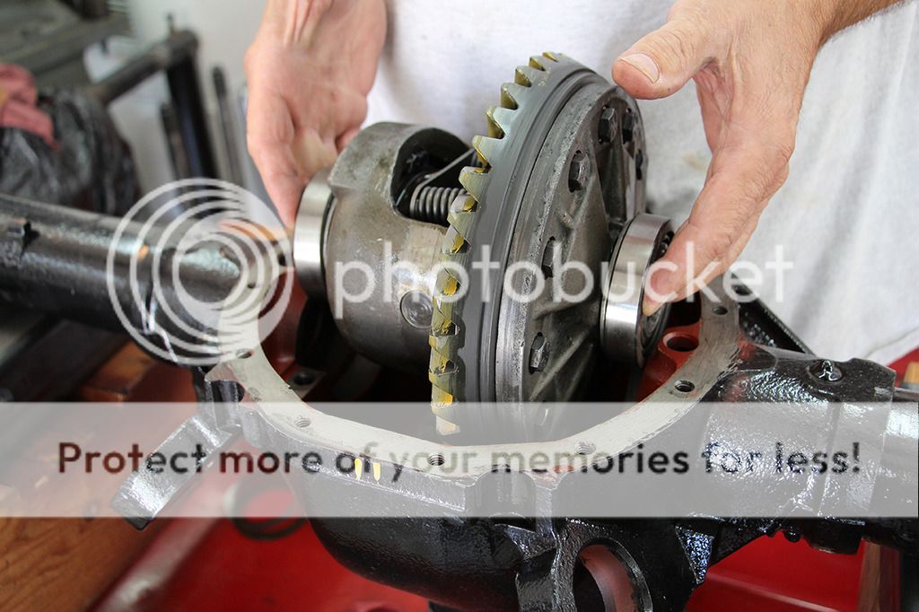

From here i needed to set the backlash which is the distance from the ring gear teeth to the pinion gear teeth. I did this by just spinning the ring gear back and forth with a dial indicator in place. I set mine to .008 to .010"
To get the backlash correct you just use carrier bearing shims on the outside of the bearing case to get it positioned right. These shims are also used for taking the slack out of the carrier bearings
You also have to tighten the carrier bearing caps before checking

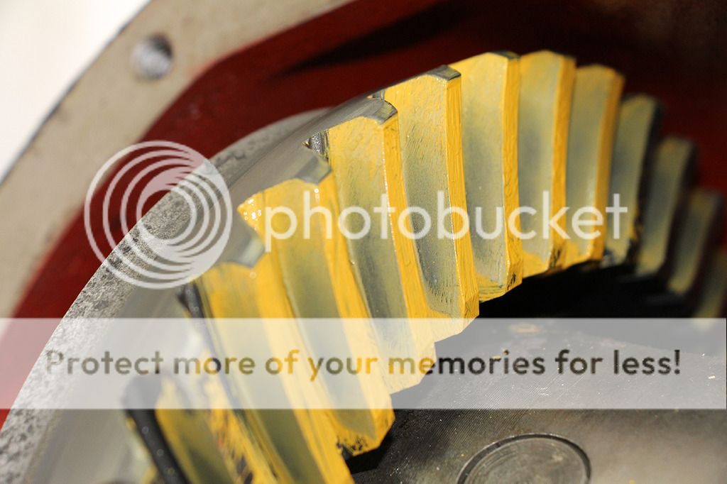

Once everything is tight I use a drill to spin the gears so I can see the wear pattern.
I also have someone hold pressure on the ring gear to simulate a slight load. This keeps the gear from bouncing back and forth on the gear and makes the pattern more accurate

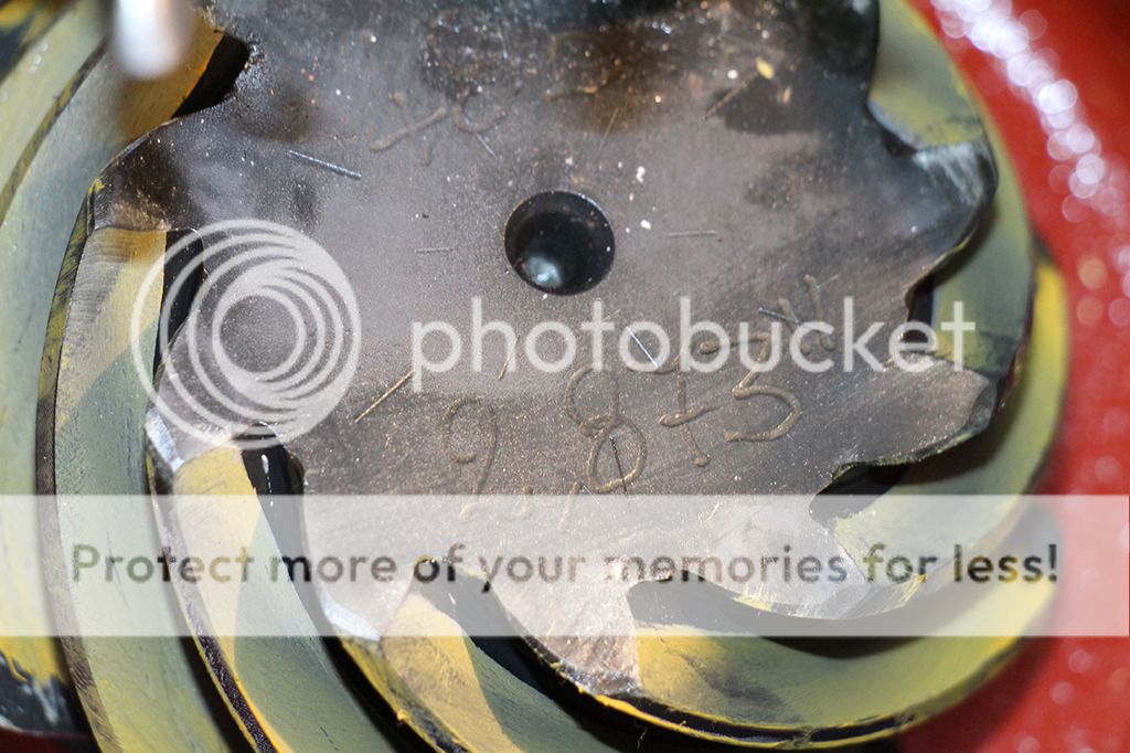

Heres the pattern I got after the first try. This is the back side of the ring gear and this is a great pattern
And heres the front side which is also good
The gears came with instructions on what the pattern should look like and how to shim to get what you want. So they make it easy to adjust from here. I've found if Im really carefully with setting things up up to this point I usually get it the first time.
Once its all set up I take everything apart making sure that I keep the shims in their proper place and I replace the old pinion bearing I used with a new one thats pressed on. If everything goes back in the way you had it then it will stay set up correctly
