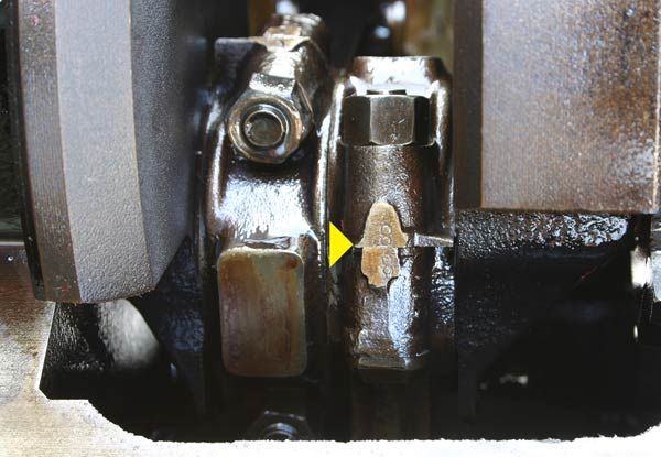

Before removing any components from the rotating assembly, you first need to stamp and label the parts in relation to each other. This will simplify the installation process and guarantee proper fit. Mark the connecting rod cap for each cylinder to its respective rod with a scribe. Each cap must be reinstalled on the correct rod in the correct direction. At this point, loosen and remove the rod bearing cap and the rod bearing.
The connecting rod and its cap is stamped with their proper cylinder designation.

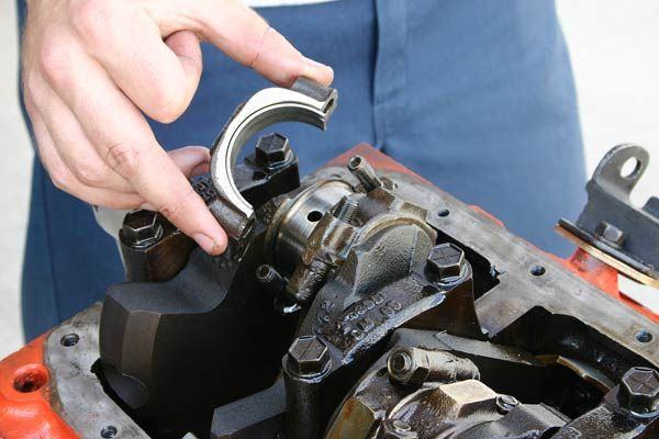

Once the nuts are removed, the rod bearing caps can be pulled off the crankshaft journal.
The bearing shell slips right into the recess of the cap.

Now it’s time to replace the rod bearings. The connecting rod bearings consist of two halves or shells that are interchangeable in both the rod and the cap. With the bearings in position, the ends will extend slightly beyond the rod and cap surfaces to ensure proper seating when tightened down.

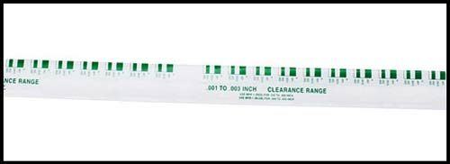

The best way to check for the correct rod-to-crankshaft bearing clearance is to use Plastigage. After cleaning the bearing shell and the crank journal, place a piece of the gauging material lengthwise along the bottom center of the lower bearing shell. Install the cap with the shell and torque the nuts to spec. Be careful not to turn the crank while the material is in the bearing. Upon removing the cap, the material will be flattened and stuck to either surface. Using the scale provided with the product, measure the material at its widest point (in thousandths of an inch). Check the manufacturer’s specifications for the desired clearance for your motor. Keep in mind you may need to purchase undersize bearings in order to achieve the specified gap. When this is accomplished, re-clean the journals and install the new bearings.Be sure to coat the bearings, the cylinder walls, and the crank journals with clean engine oil prior to re-installation.
