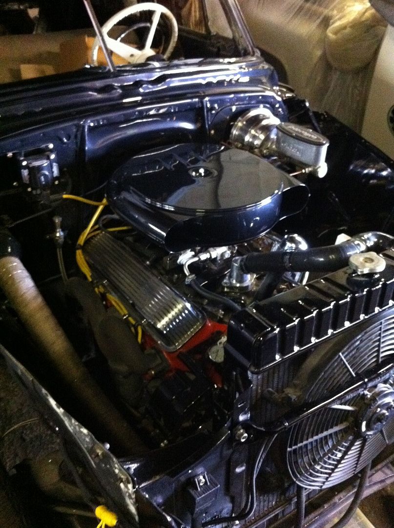

Hello all, ive been restoring/rebuilding/modi fying my '51 for about 14 months, i have a build thread over on the hamb but I am going to cut and paste it over here as the Hamb seems to be changing and i fear my build thread may disappear lol. So ill bring it over here as i prefer this site to the hamb anyhow.... here goes.....
Attachment: photo4_zps13c3baa6.jpg (44.44 KB) 126 View(s)

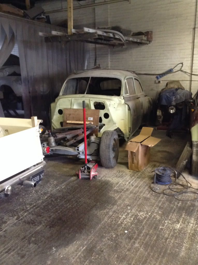

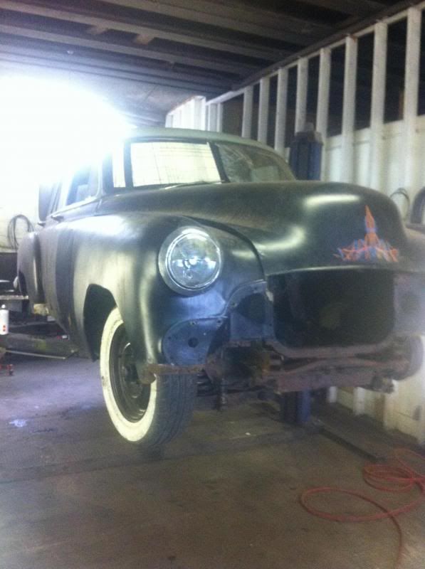

Well ive had my '51 Styleline 4 door sedan for a couple of weeks and have got it in my head where im going with this project, im happy with the look of it (what we call over here Ratlook), not sure what its known as over in the States. shes got dropped front spindles up front, air shocks at the rear which im happy with for the mean time, i will be notching the rear chassis and bagging the rear later on in year but first want to get it up and running. The only way I could afford it was to let the previous owner keep the stock 6 and manual transmission as i want to fit an 8 anyway. Im not bothered about the condition of the body at the moment as just want to install a 350 sbc, turbo 350 and camaro rear axle.
Heres how it was a couple of years ago...
And how i bought it
As you can see it had been vandalised by some little poopsbut luckily not too badly, I had it transported down to my mates garage where i put it up on ramp and had a good look over it to see what i had got myself into lol...

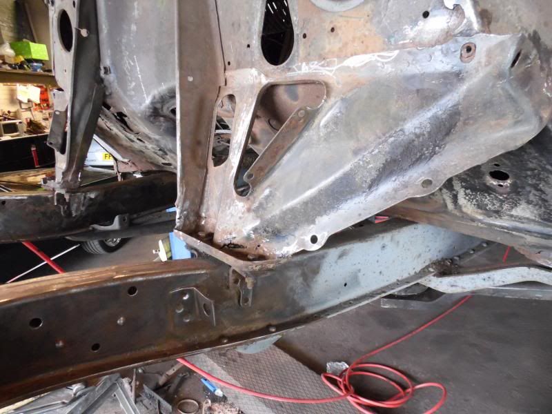

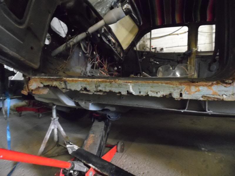

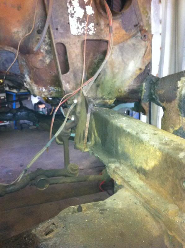

I was glad to find that the frame is solid, with only one previous repair patch and only needing a small plate at rear...
The inner sills do need work tho, but nothing to worry about..
So after a good look over it the first purchase is going to be a set of sills/rockers from the USA, and to get a camaro 10 bolt rear fitted which ive located over here.

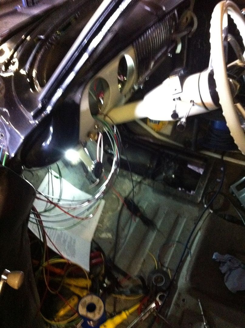

4) Complete rewire as whats here is not to my liking so really needs redoing to make reliable.
5) get a column and convert it back to left hand drive as at the moment its been converted to right hand drive but the steering box sits on the inside of the frame rails in the engine bay and will hit a sbc as thats wider than the 6 cylinder.

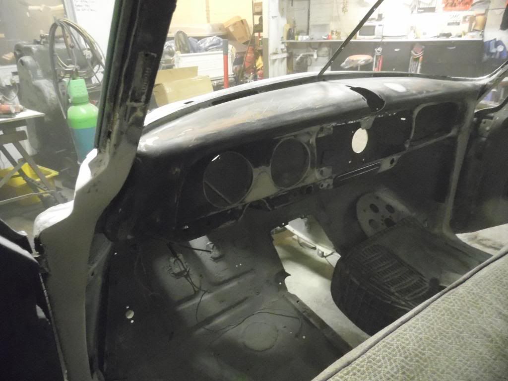

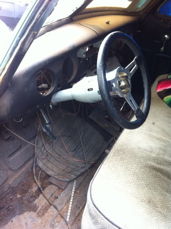

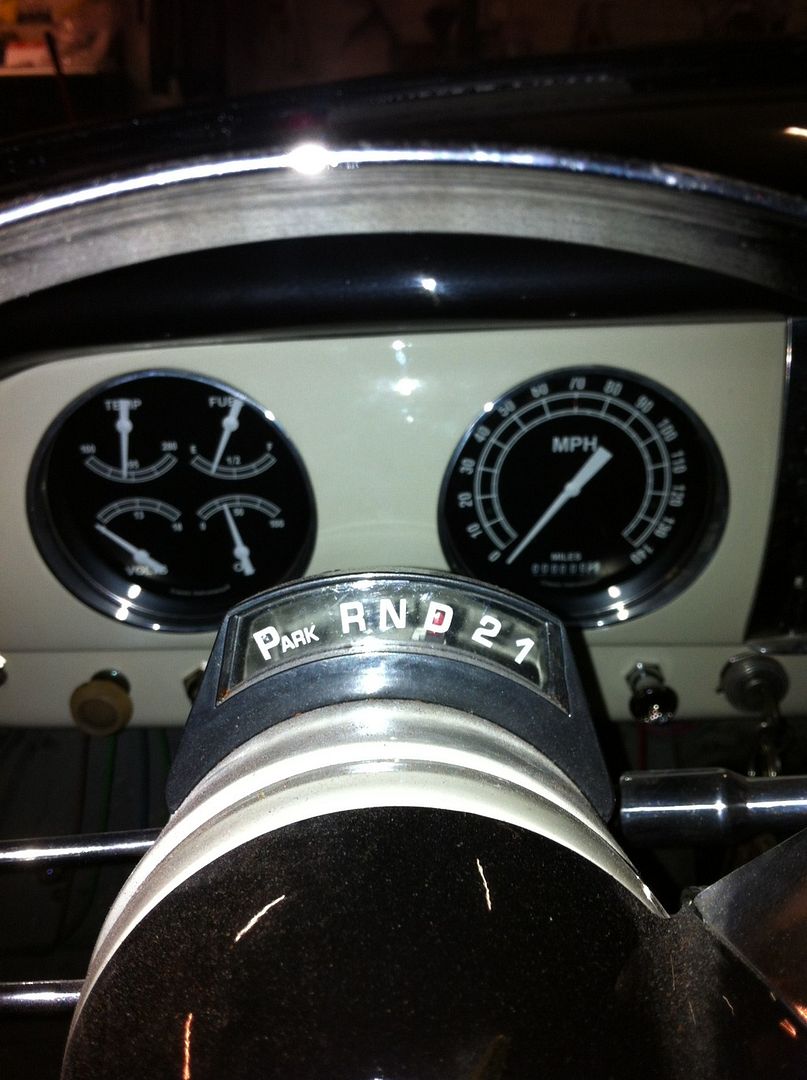

This is a citroen steering wheel and column thats been used to convert it but unfortunely I cant use it because it will hit the engine..
well thats enough for me to be getting on with but im sure new jobs will surface as i go!

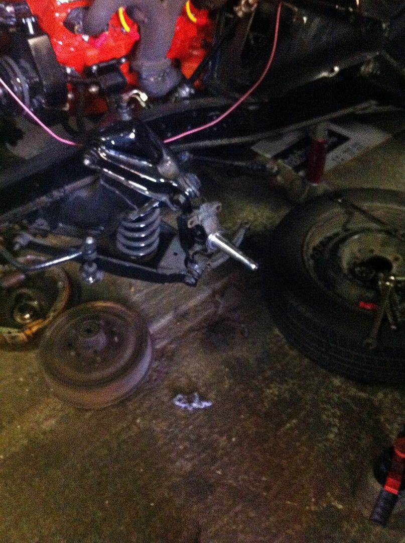

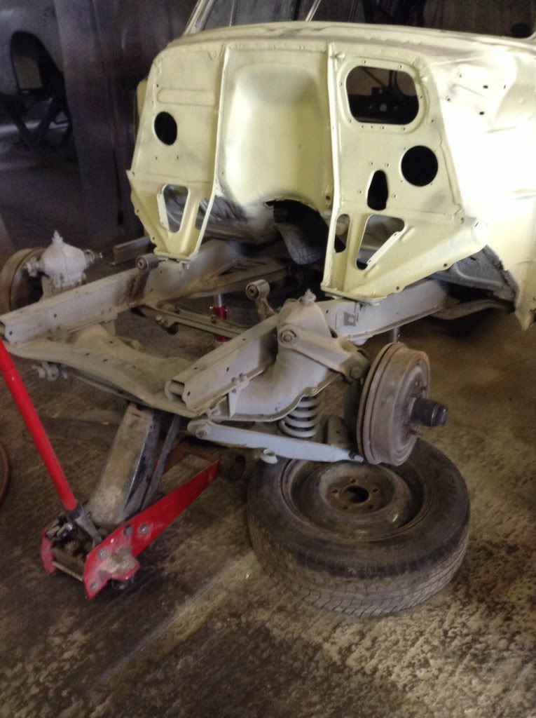

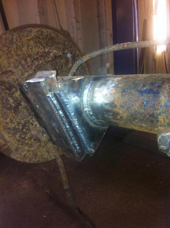

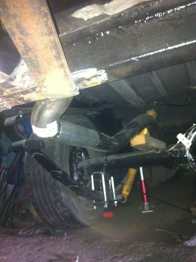

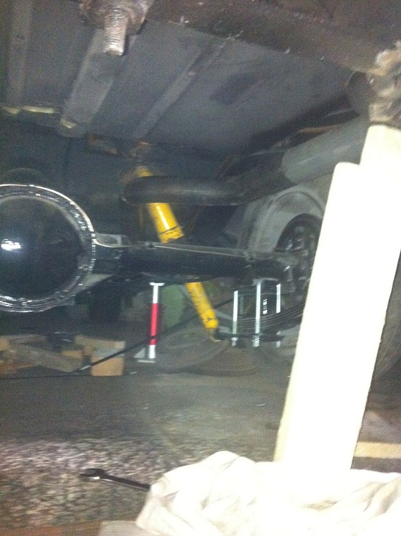

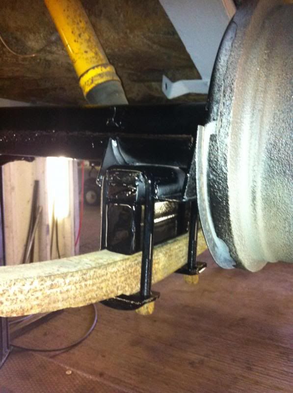

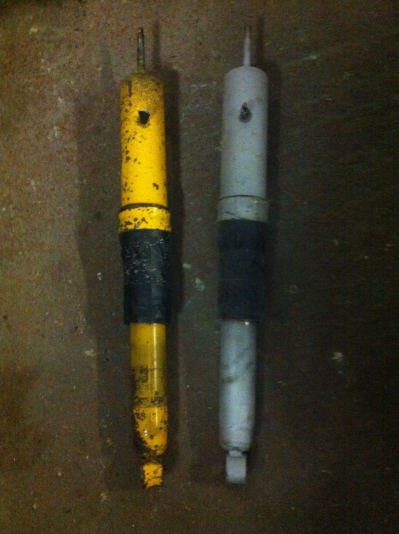

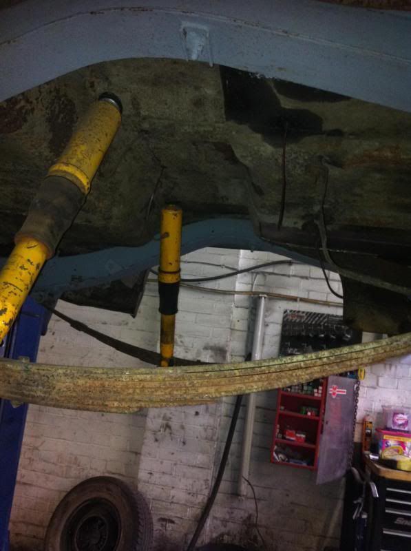

Ok spent the day fitting my 2nd gen camaro axle in, had to use original u bolts because camaro axle didnt come with any u bolts, i dont have pics at the mo as left camera at home, but ill take some snaps tomorrow. Ive had a good day at it tho, and very pleased, doesnt sit ever so low with no air in shocks but does sit nicely, tomorrows job is to remove axle and strip it and prime, then remove front fenders and hood ready for engine install after my power rack and pinion comes over from the states, ive managed to get an ididit column and a mopar radiator that was missing. so got a busy few days but ill get some good progress done this week
1951 Chevy styleline four door, getting the 350 sbc treatment....
chevyjay
Posts: 128
Age: 41
Loc: Margate , Kent, UK
Reg: 11-20-13
03-20-14 06:12 AM - Post#2437209
    In response to chevyjay

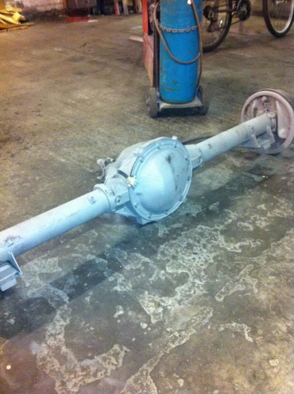

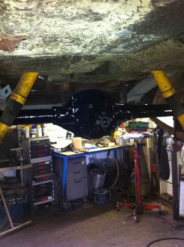

Ok next i removed the torque tube rear end and got the 10 bolt camaro fitted, it was quite straight forward not causing too many headaches, unfortunately i cant seem to transfer the pictures over ill try and edit a few over later but now on with the build.....

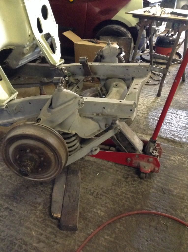

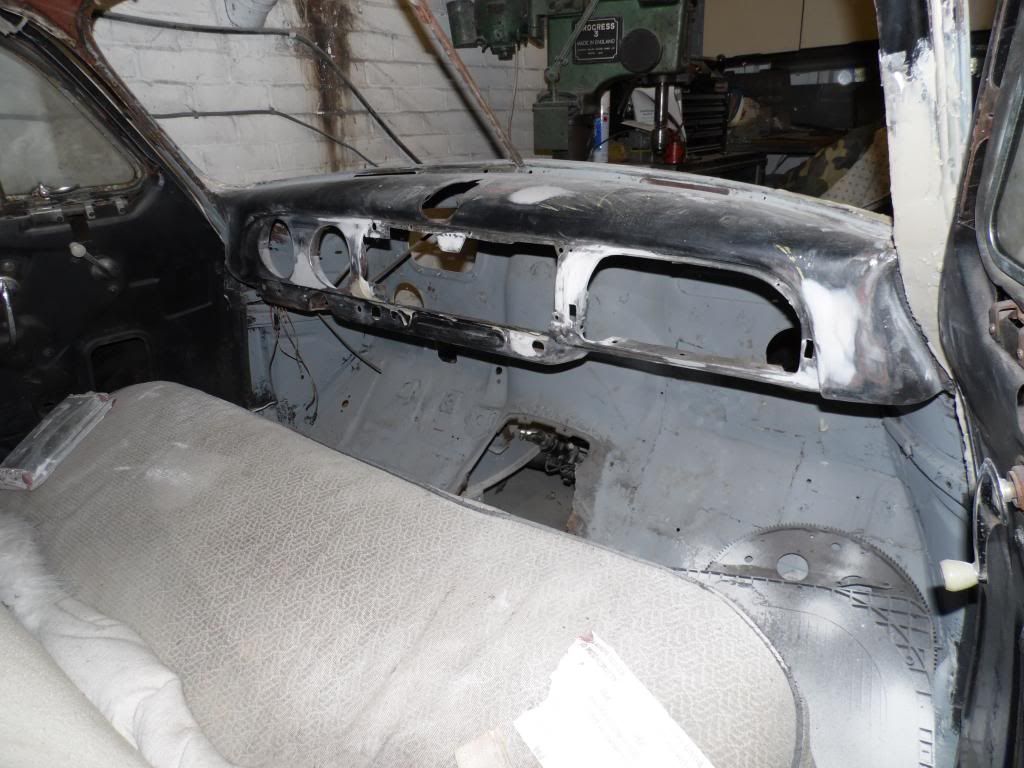

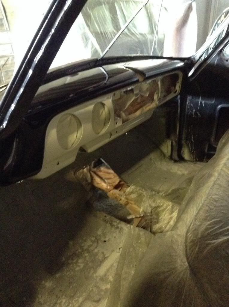

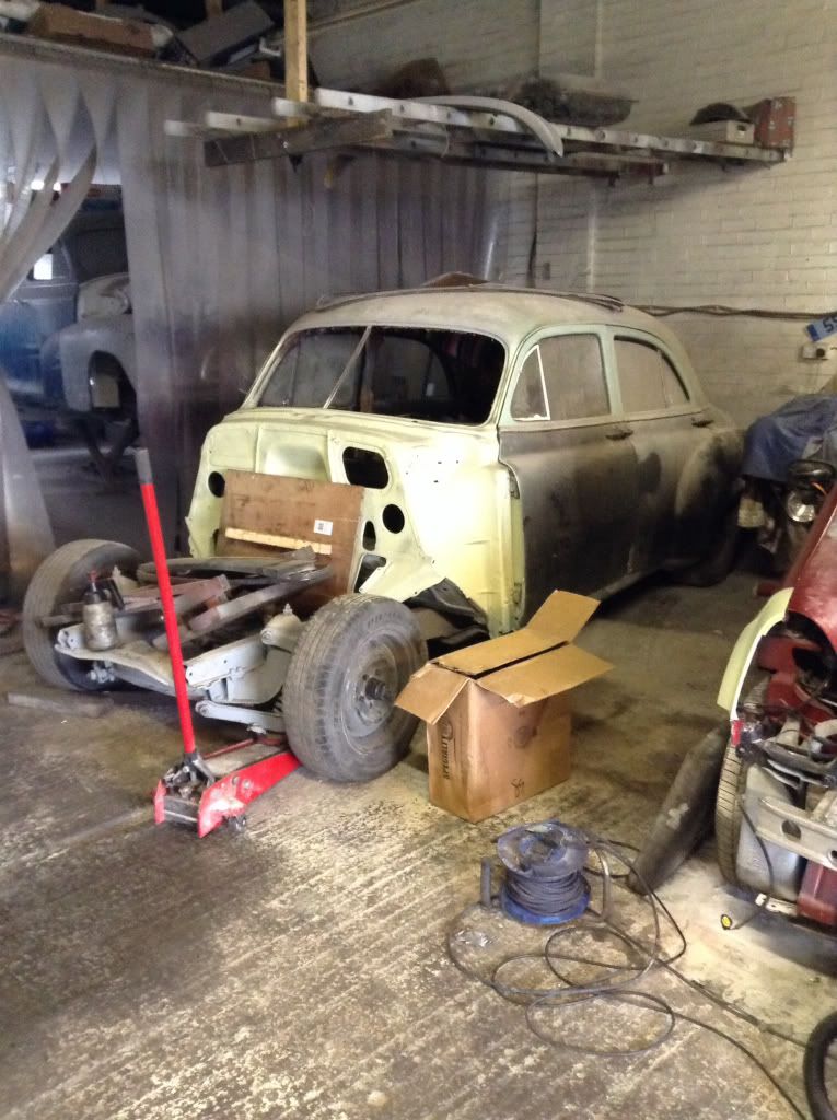

next job was to strip the front end out, get all the bodywork off so i could see what i had to do, pictures dont seem to be coming over again so just have to take my word for it lol....

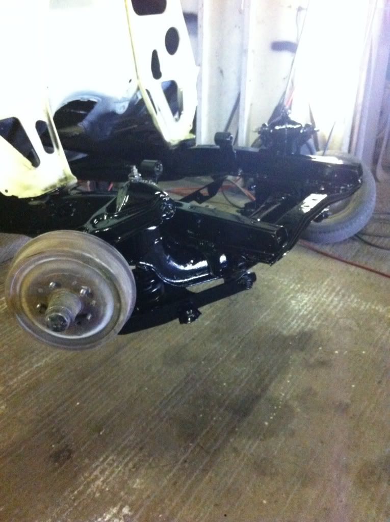

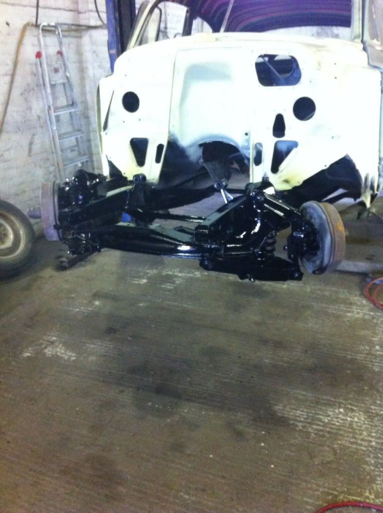

next job once i had the axle fitted ok i got it sandblasted and gloss blacked, it now sits nicely at a good height...

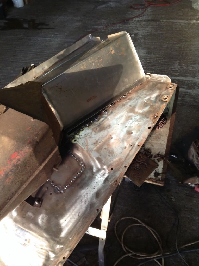

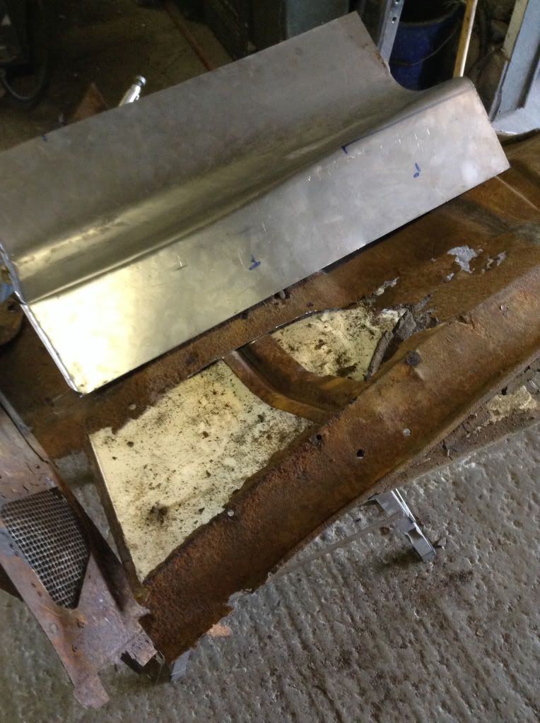

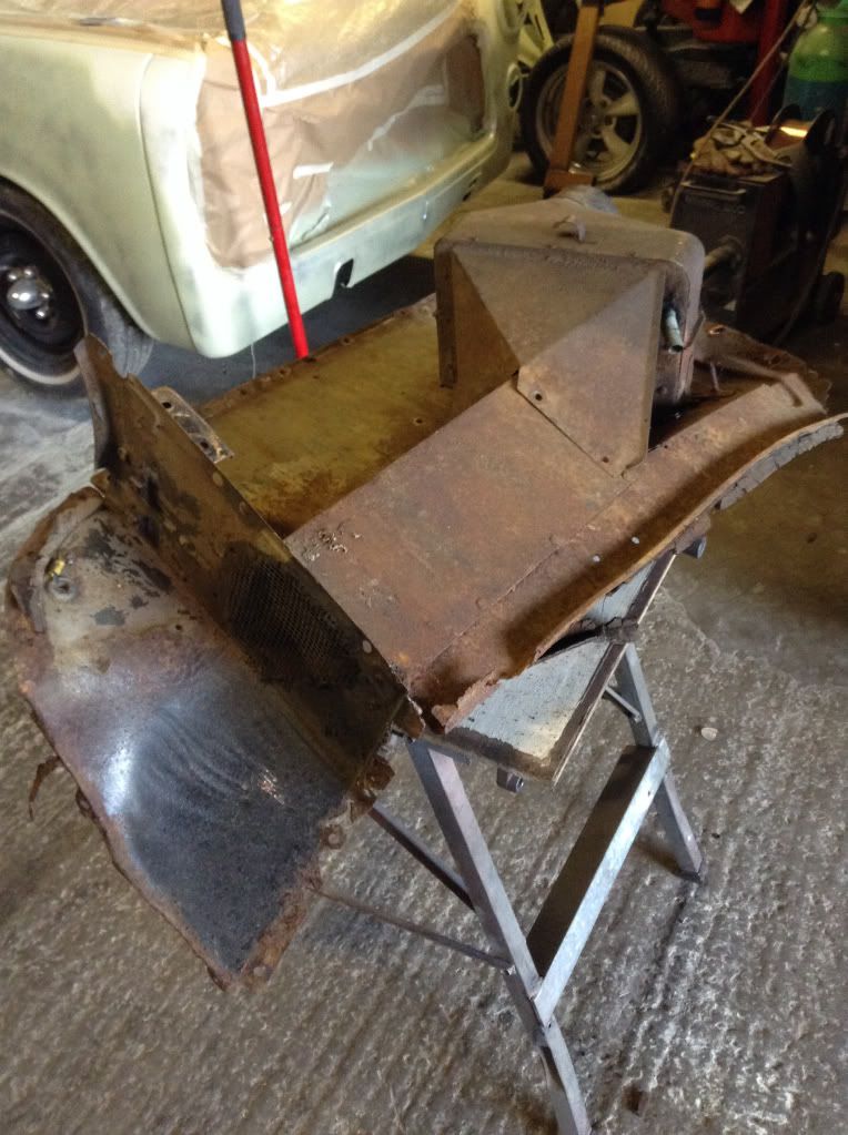

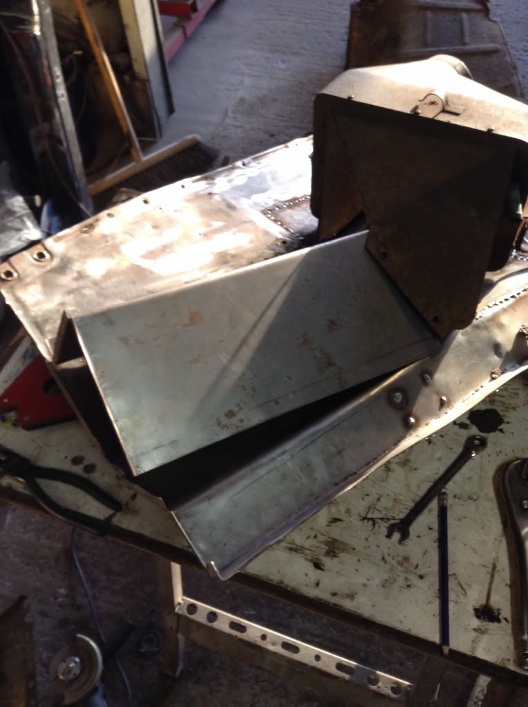

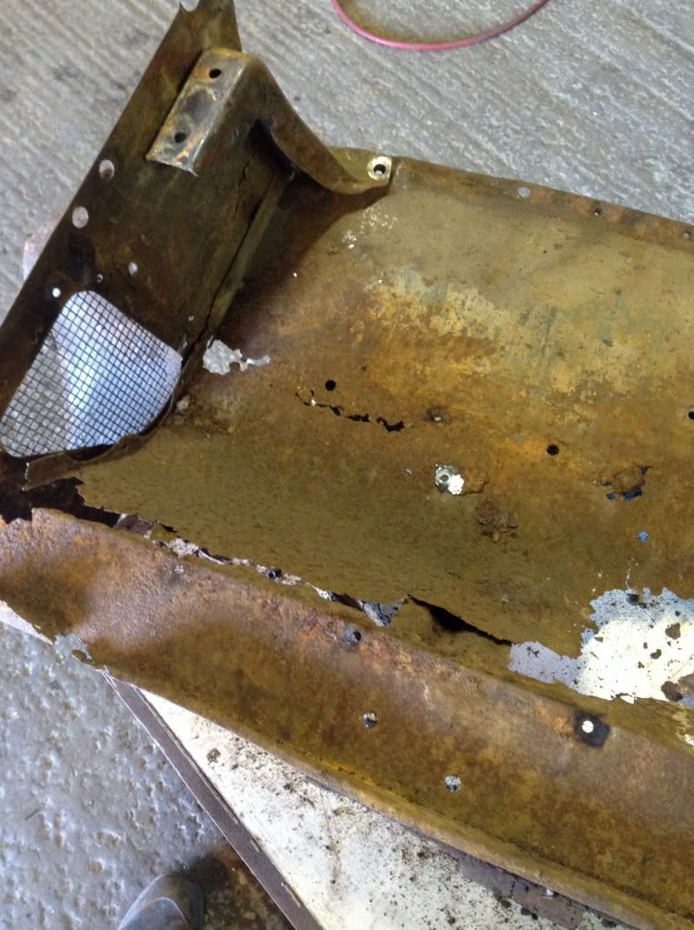

Next job was to start on the trunk floor, it turned out to be a pretty major job but i got there in the end...
Edited by chevyjay on 03-20-14 06:25 AM. Reason for edit: No reason given.

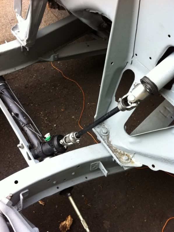

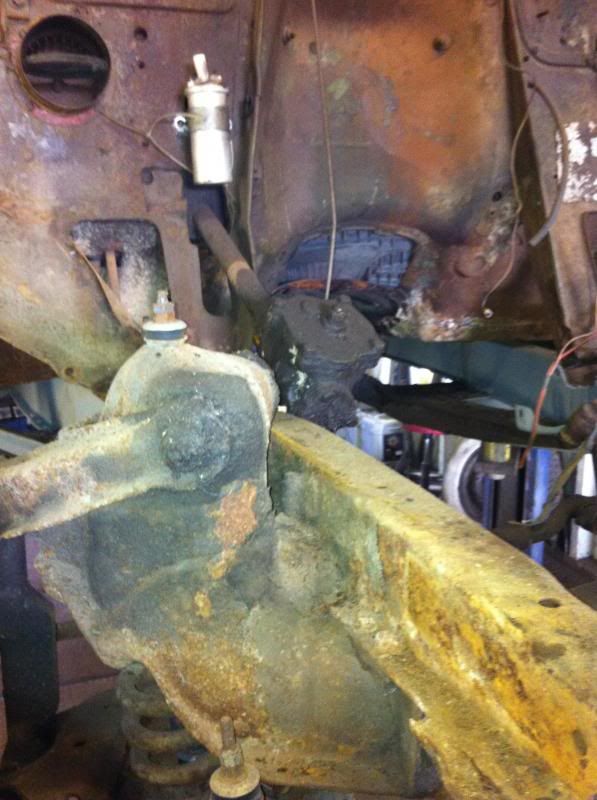

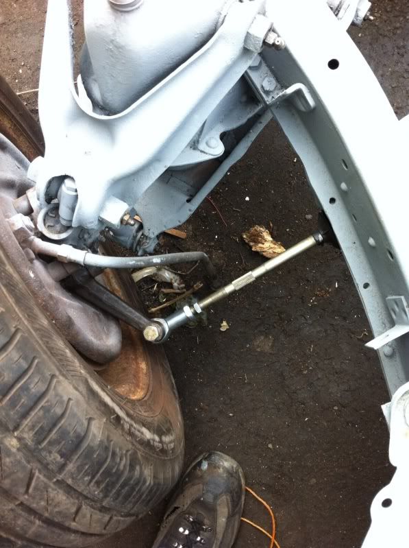

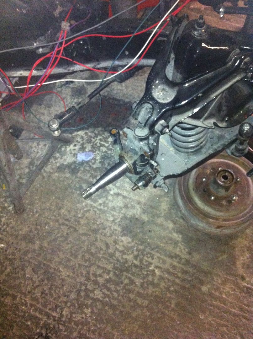

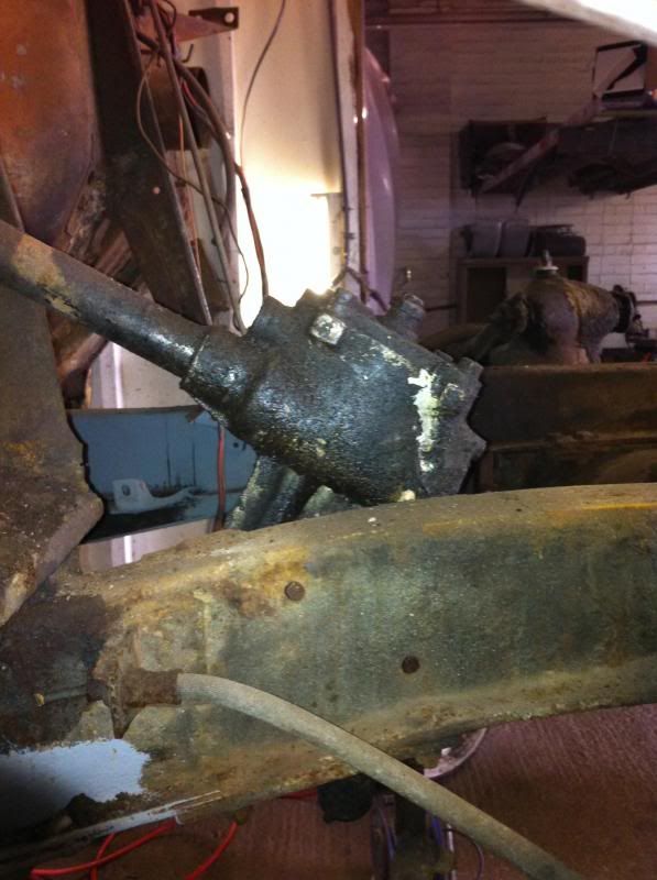

Next job was to tackle the front end and sort out the steering gear....

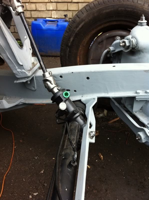

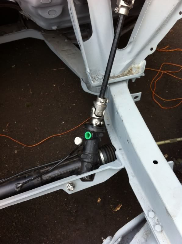

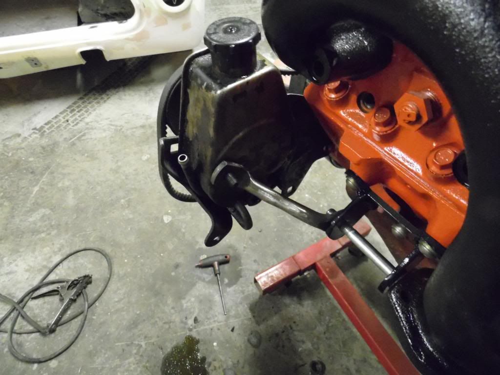

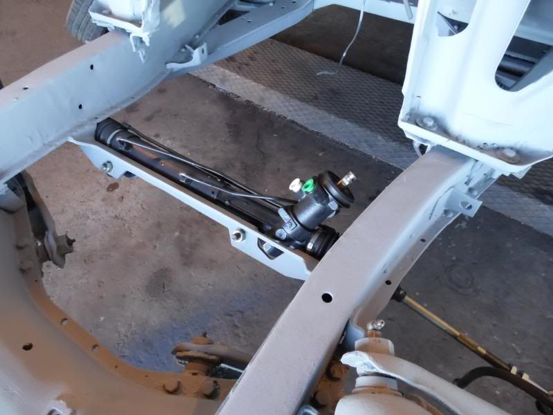

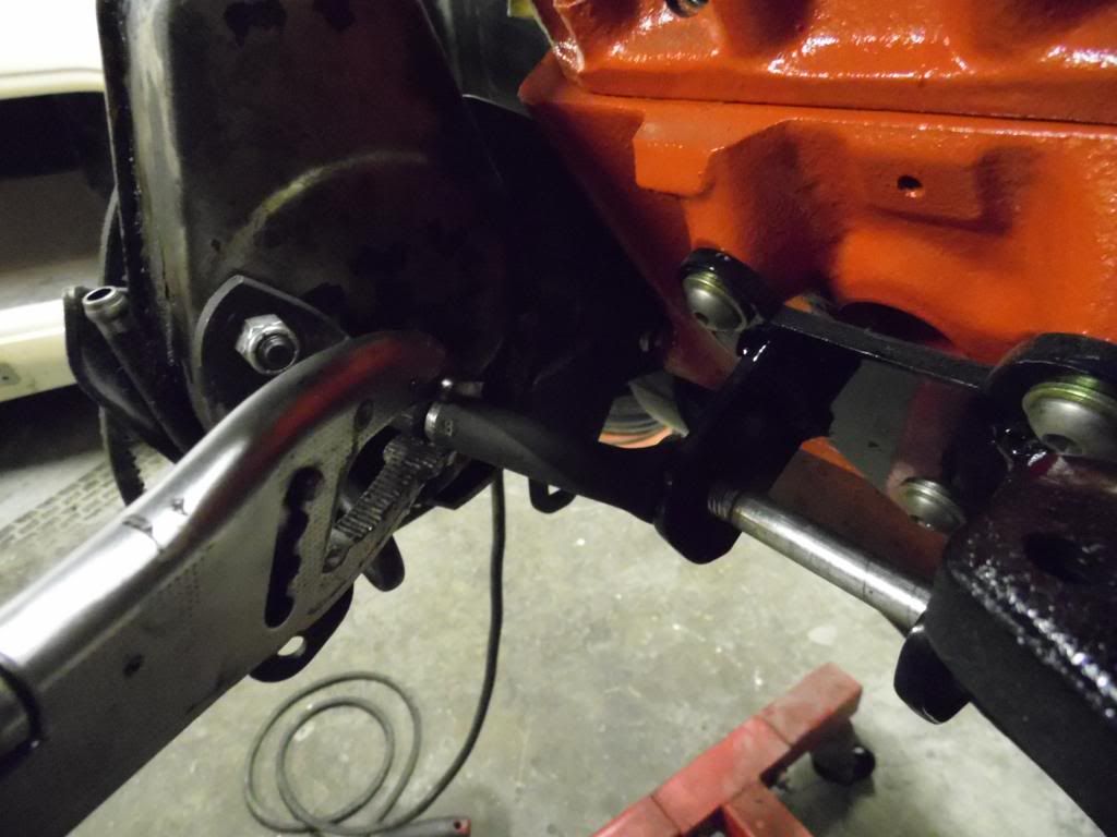

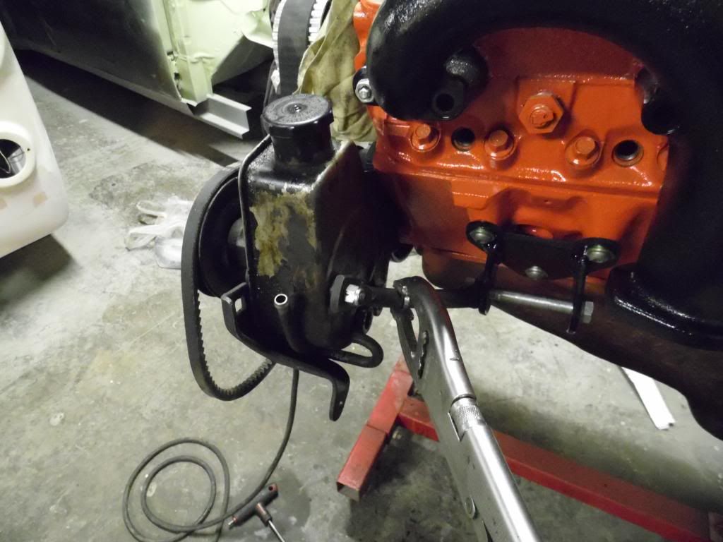

next job i started to mount the power steering rack, making up a cross bracket out of angle iron..
Edited by chevyjay on 03-20-14 06:29 AM. Reason for edit: No reason given.

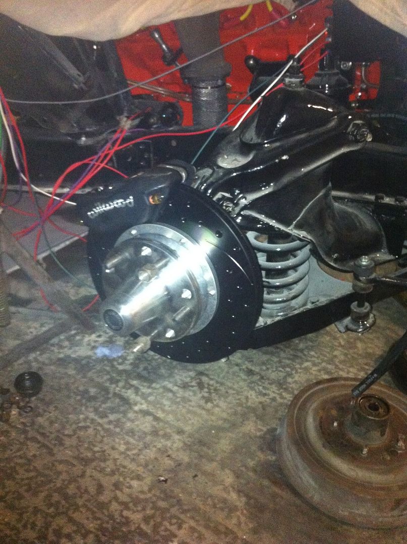

Once all the welding and rack bracket was in I gave it all a coat or rust preventative primer, somehow it makes it all look 100% better when its all bright grey lol....
Edited by chevyjay on 03-20-14 06:30 AM. Reason for edit: No reason given.

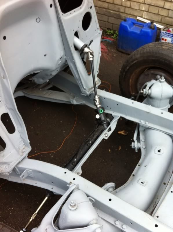

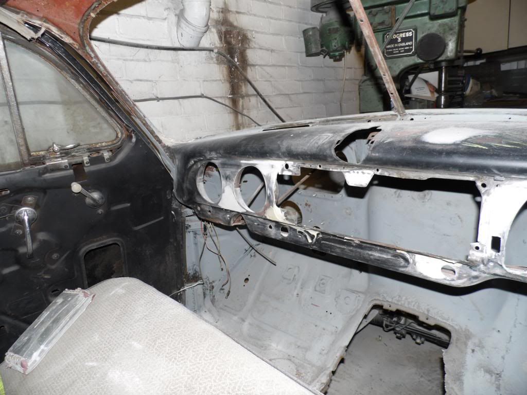

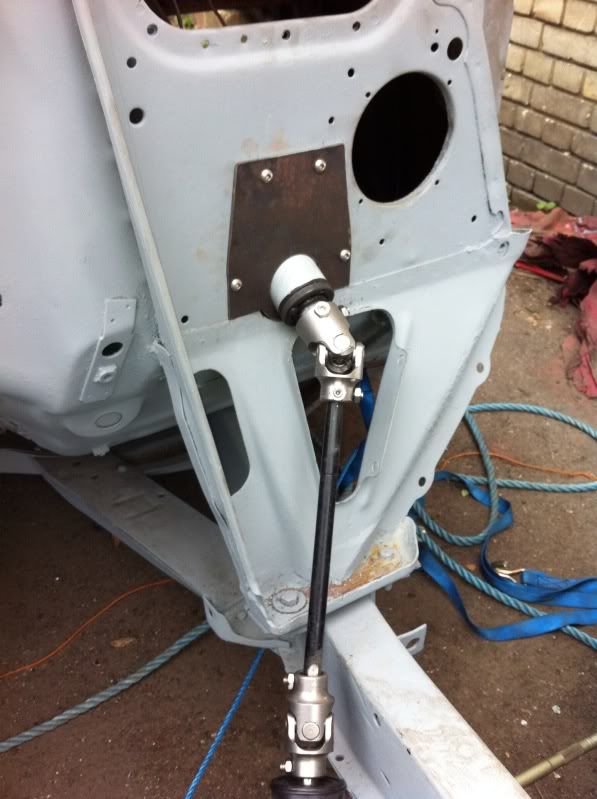

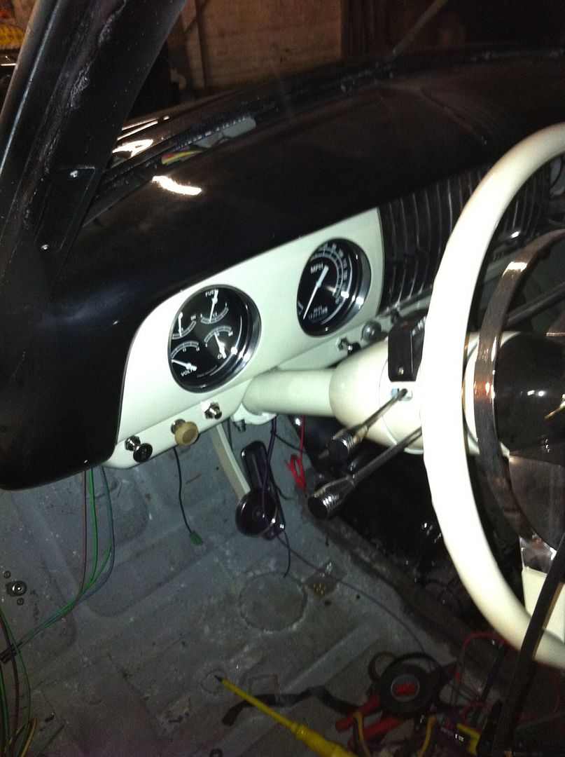

I mocked up the column and made a plate where it comes through firewall to support it at the bottom, im very pleased with this as i think it suits the look im after...
It all worked out really well, turns fine with no tight spots so im glad with the way it all went!
Edited by chevyjay on 03-20-14 06:32 AM. Reason for edit: No reason given.

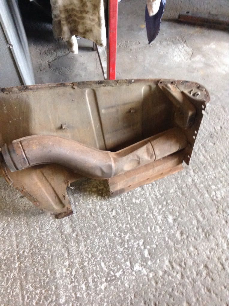

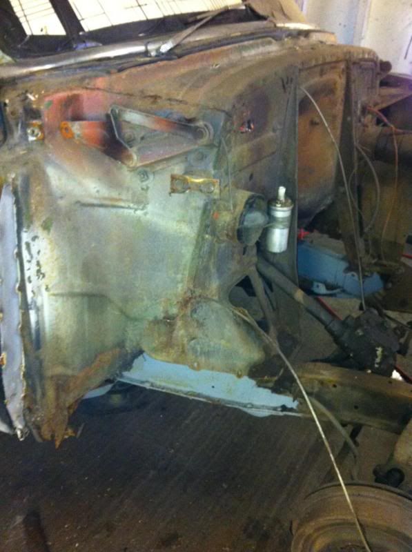

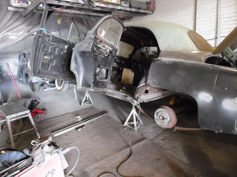

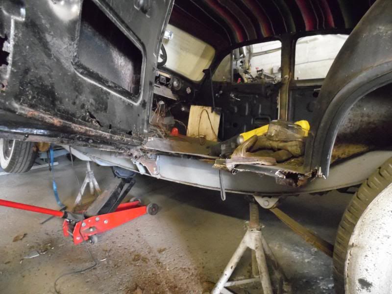

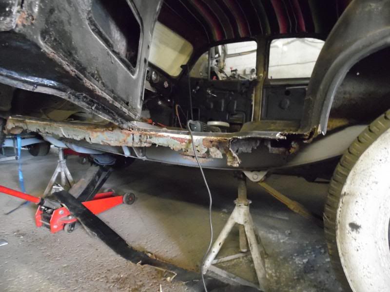

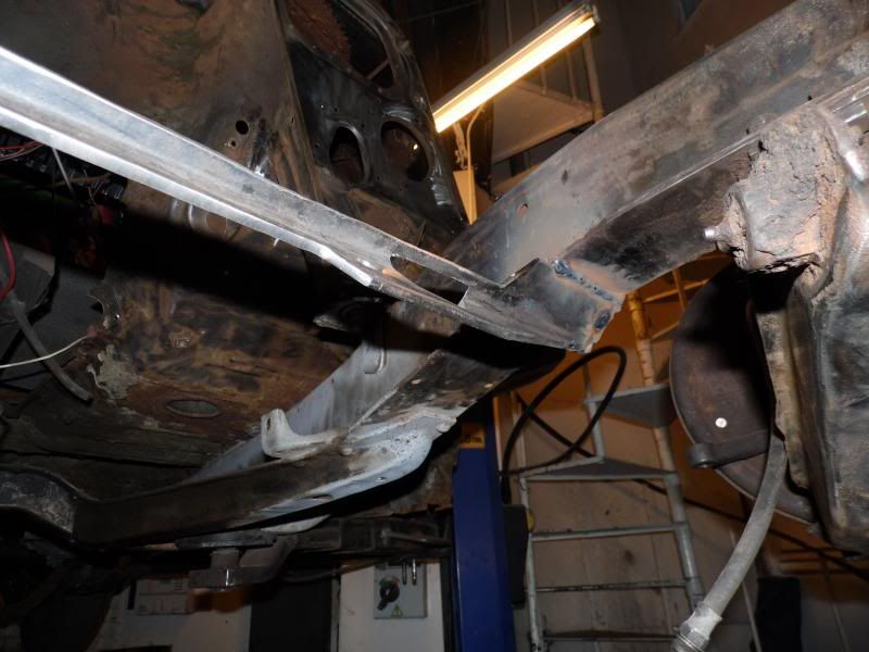

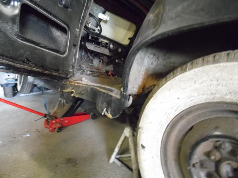

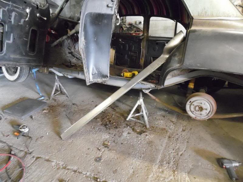

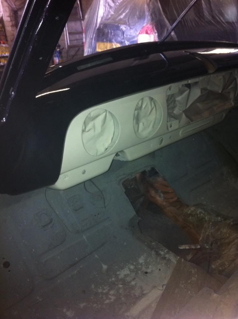

Ok the next big job i had planned was to replace the inner and outer rockers, i knew this would be a soul destroyingly dirty job but one that had to be done lol, I took a week off work and plowed on with it all....
Edited by chevyjay on 03-20-14 06:34 AM. Reason for edit: No reason given.

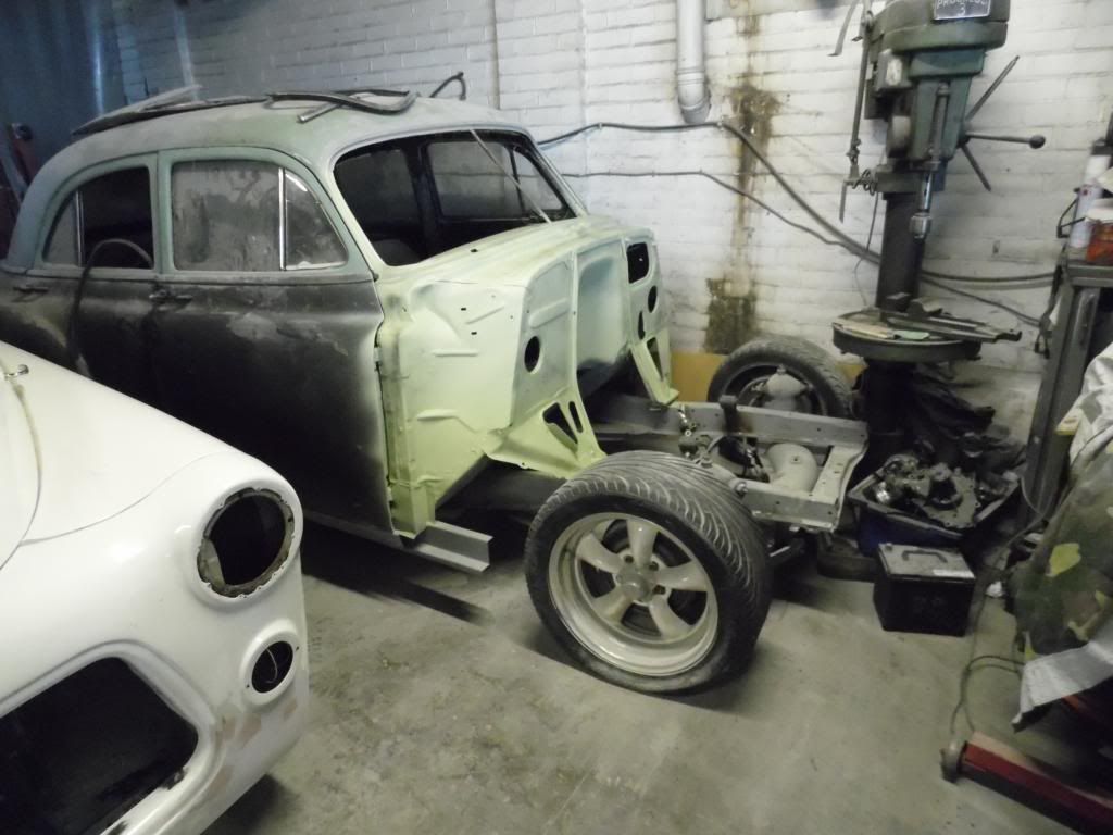

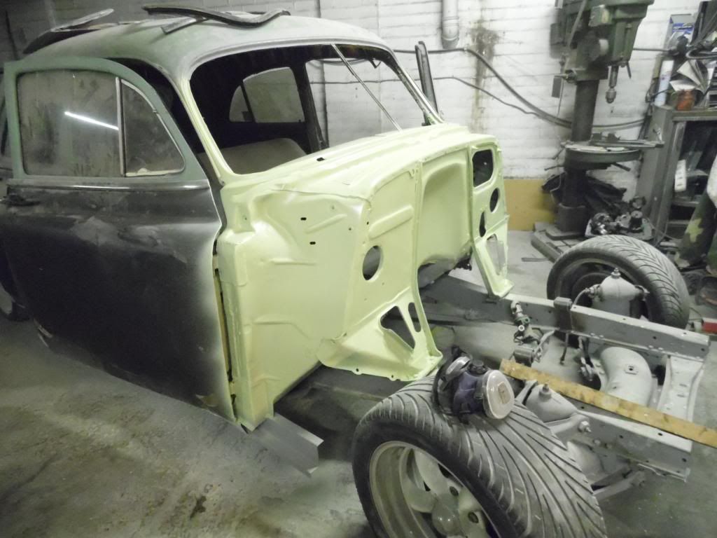

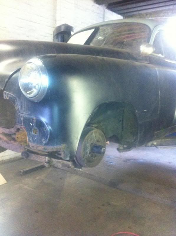

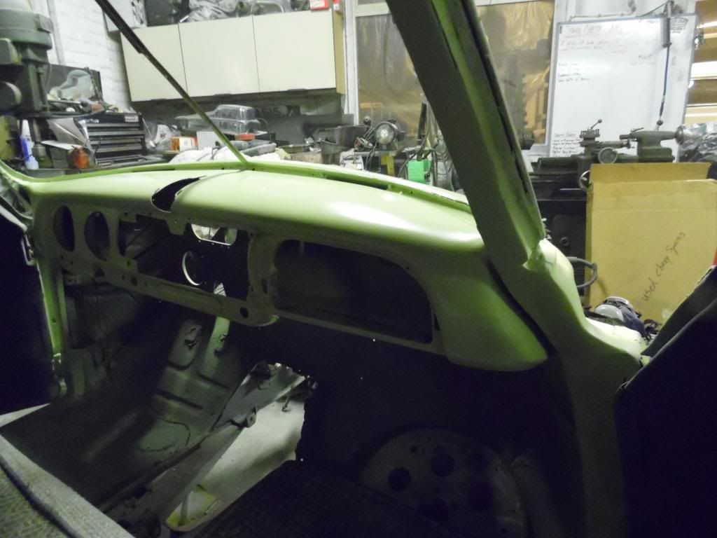

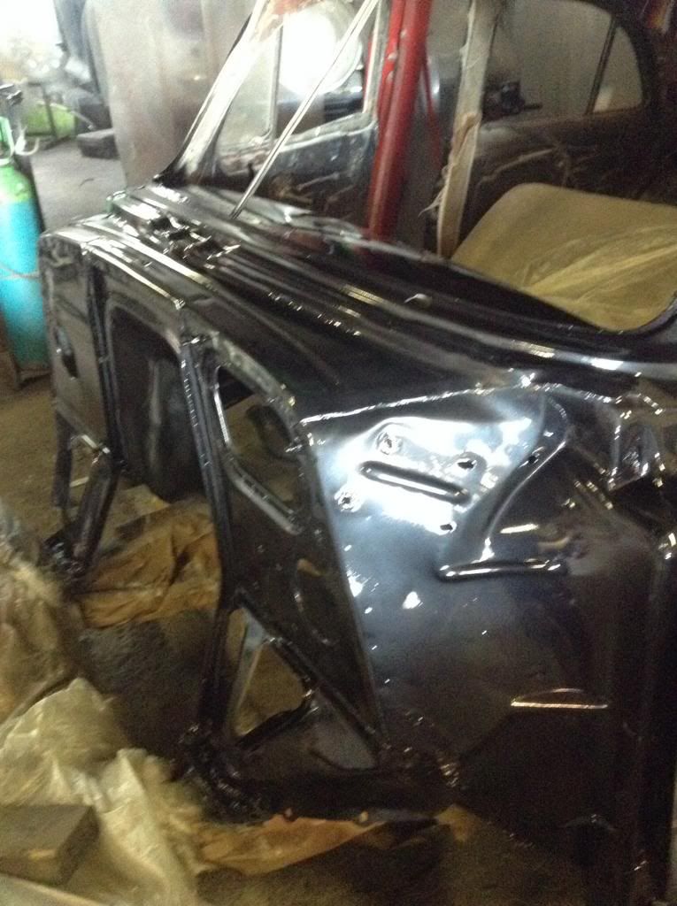

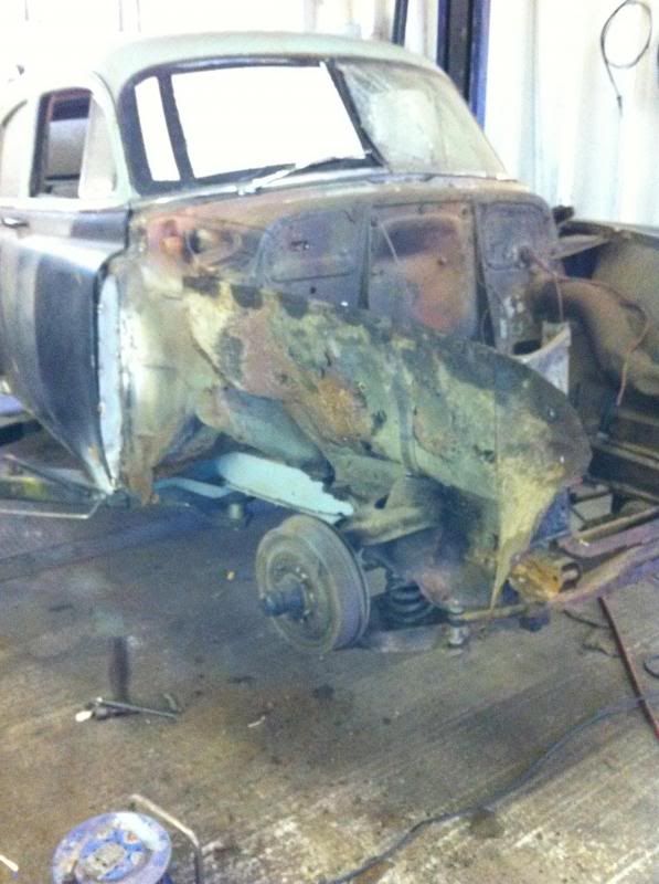

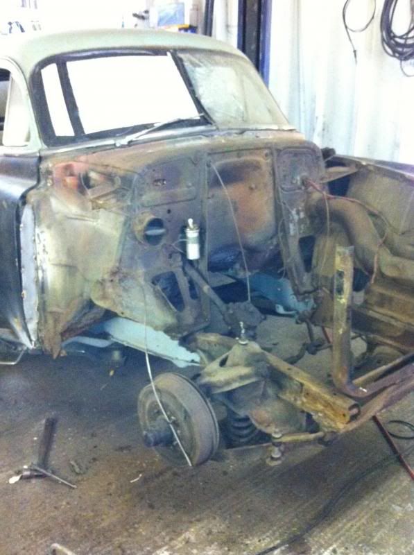

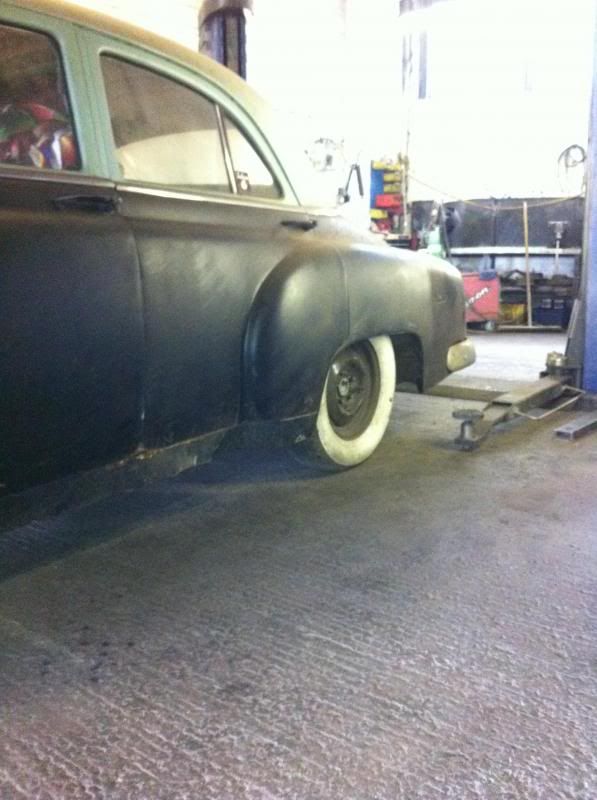

Well ive had a week off work this week and made a nice bit of progress, my mission was to attack the rust around the windshield and if I had time look at the rear panel and maybe mock the engine in the hole, well heres how I got on......
Firstly I borrowed a set of wheels to move my car into my mates workshop, and was surprised how good they looked, give me some feedback as I may be able to buy them, and yes I know I have the front ones on back because the rears are 9" and slightly rub the inner fenders on rear....
slightly artyfarty shots...

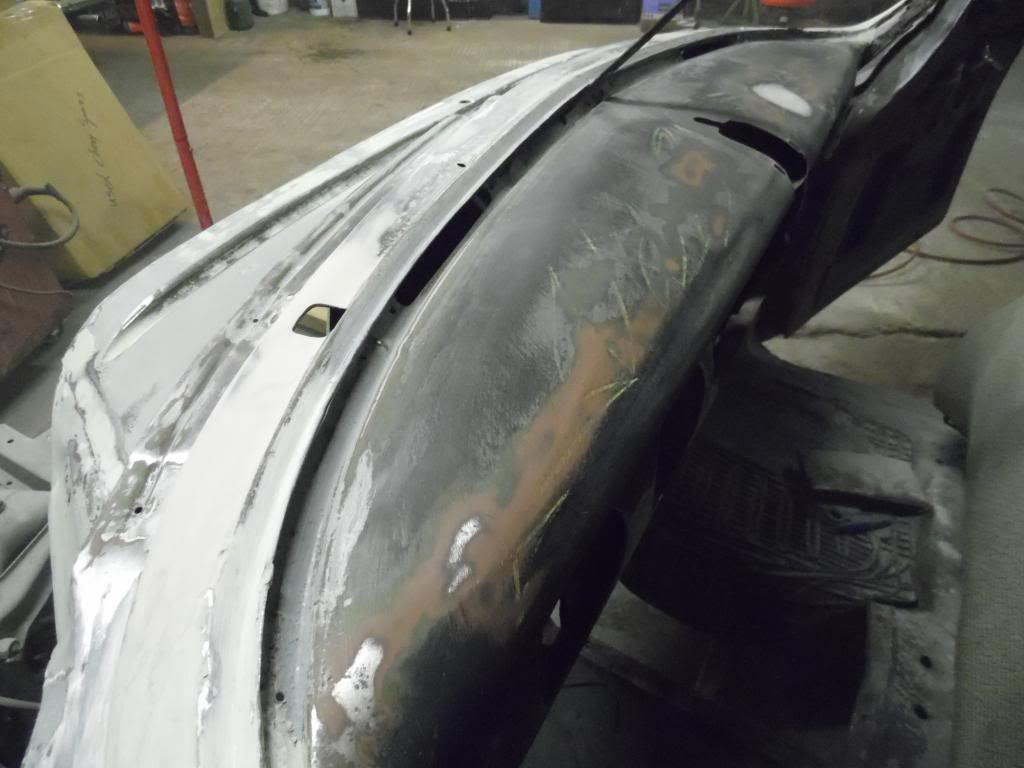

First job I removed the broken windshields and straightened the centre bar, then I had to push up the wiper spindle holes where the bonnet hinge was loose and before I owned it it went to a car haulers yard and the workers opened the hood to look what engine was underneath not knowing you had to pull the hood towards you when closing it, so the weight of the hood hammered the wipers into the scuttle panel....doh.....
still got that done ok...
next I run a wire wheel around the inside of screen aperture to get the rust out of way...

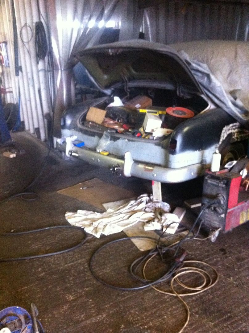

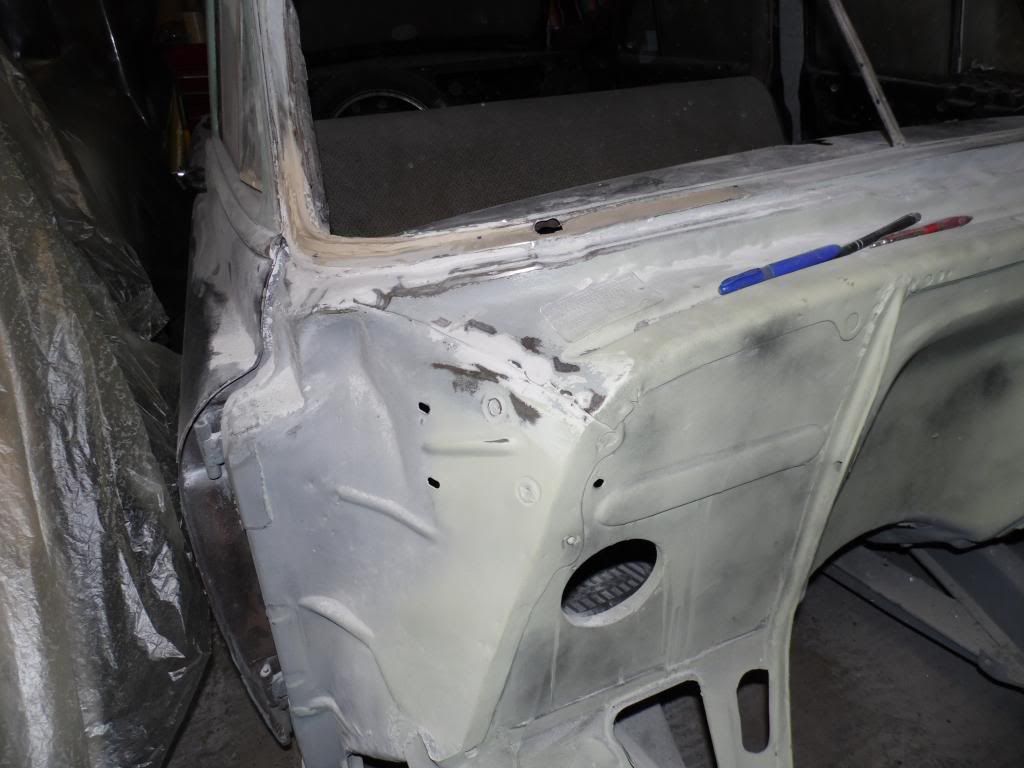

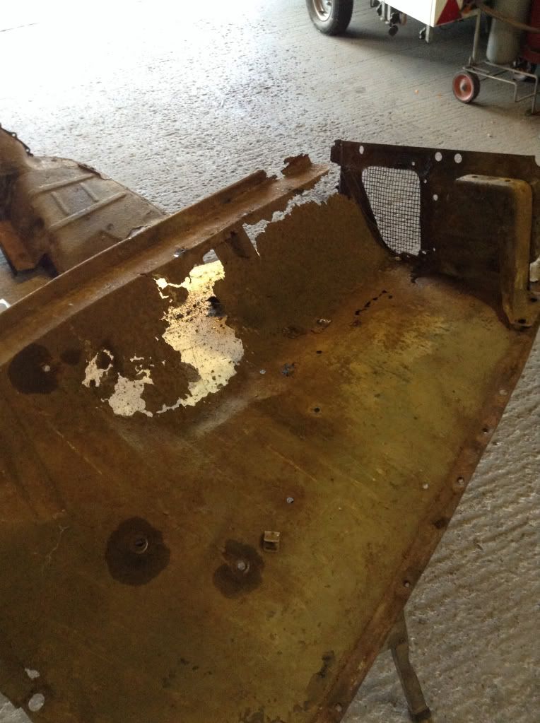

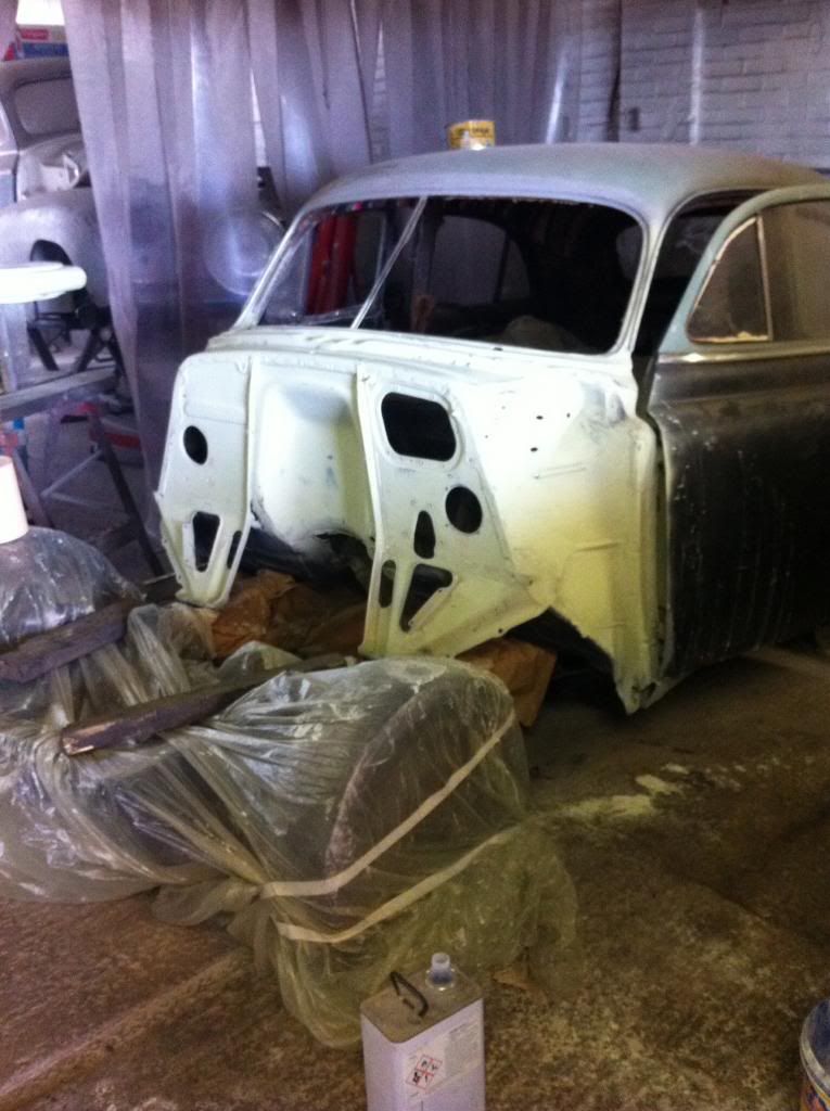

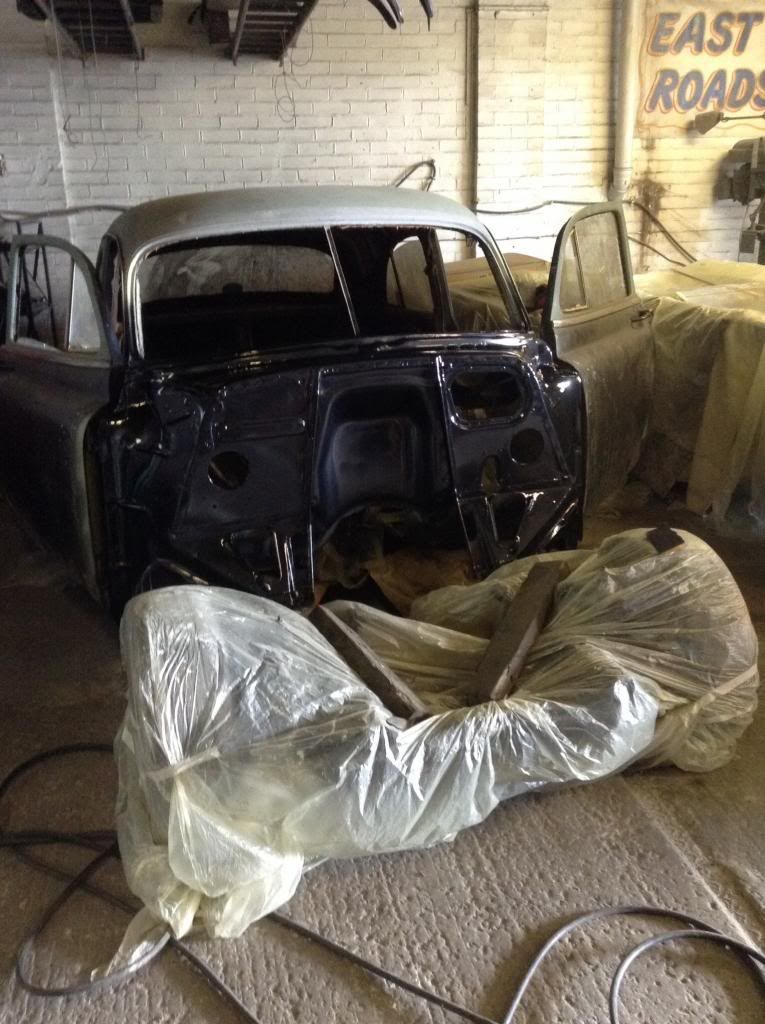

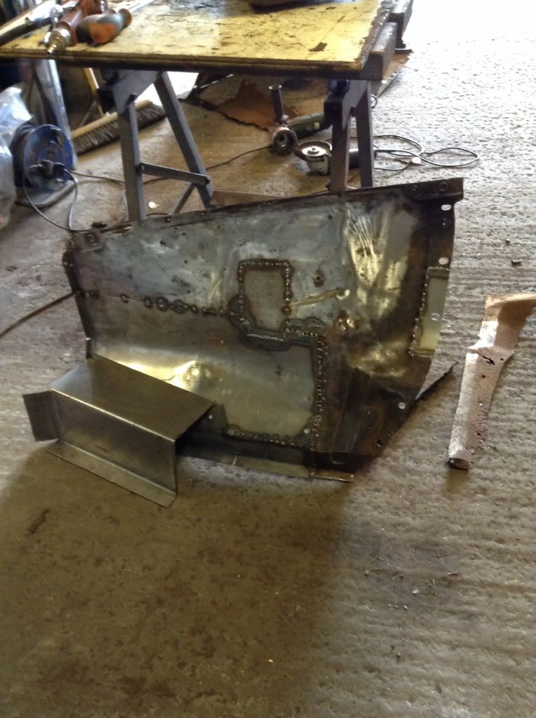

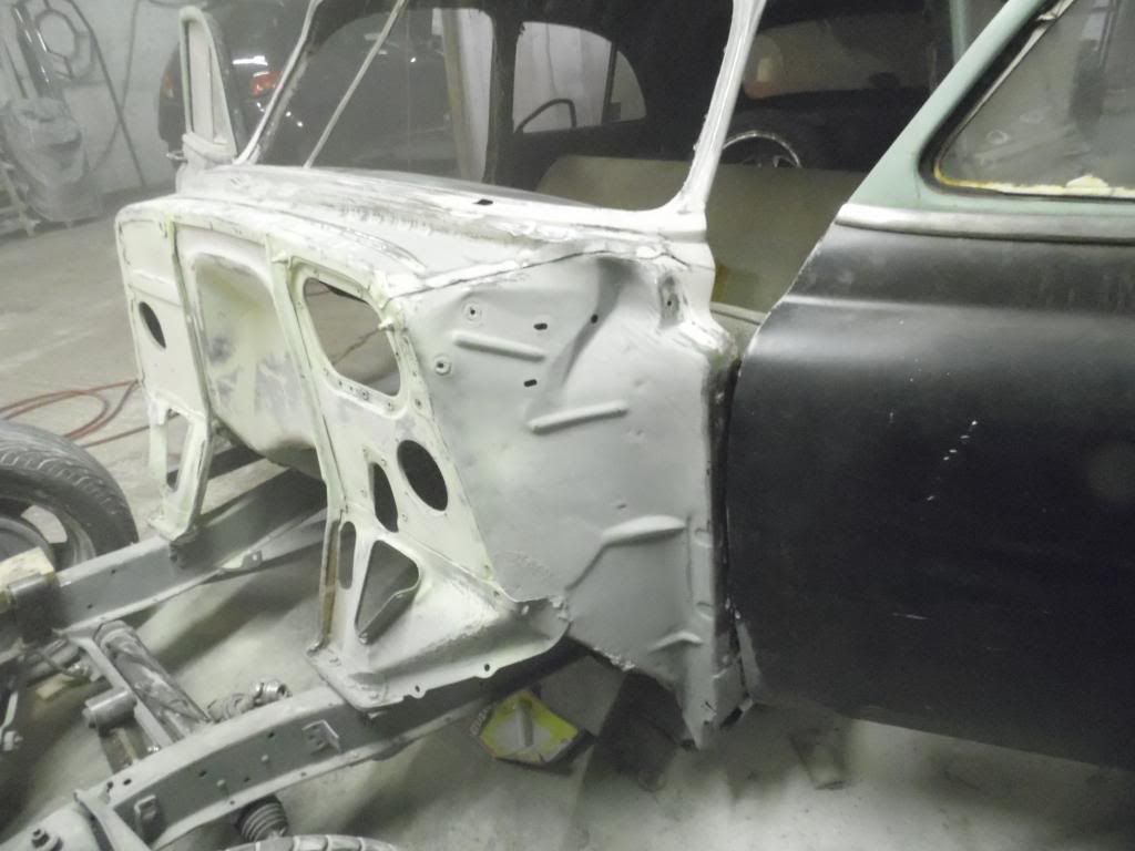

Next job I cut out the rust around screen corners....
Then it was the long job of making plates up to repair the holes, these are only temporarily tacked into place but I think they will do the job...
I spent Monday and Tuesday this week doing the screen, next job was the rear panel below decklid...
I attacked it with a hammer and chisel and as I guessed a lot of filler and not a lot of metal has fallen out lol....
I run a grinder over the lower rear quarters to see how bad they were too...
then I drew a line line across above the rot and below the new trunk floor I made and welded in and then cut it out its somehow very satisfying cutting out rotten metal knowing it will never infect the car again lol...

Next I fabricated a rear panel repair section, it wasn't too hard to do just working out the length and followed the lovely shape of that rear!!....
next I cut out the rot in the lower rear quarters and plated these....
This is how it stands tonight, tomorrow my good friend Jon is going to be welding all the plates properly and ill give it all a good coat of anti rust paint to keep the rot at bay lol.....

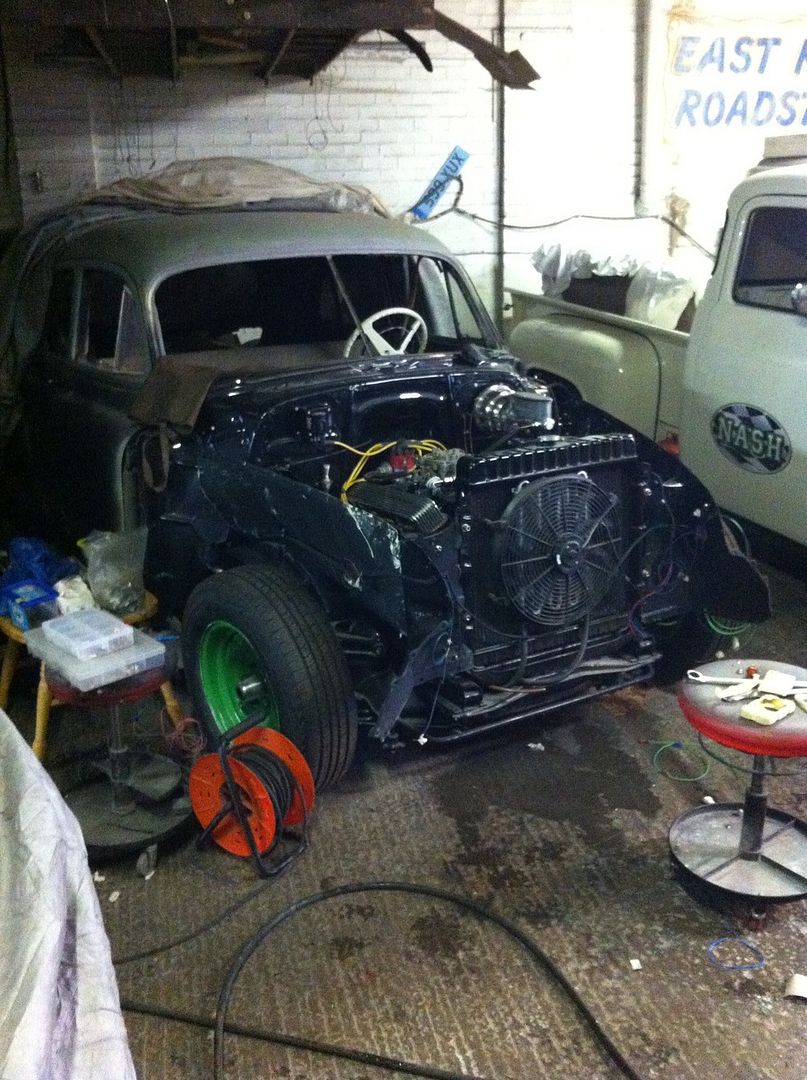

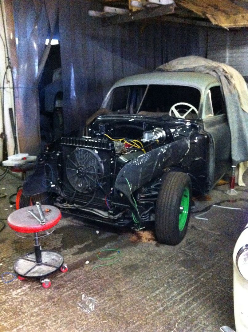

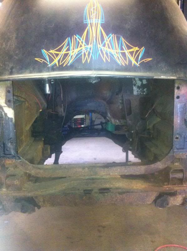

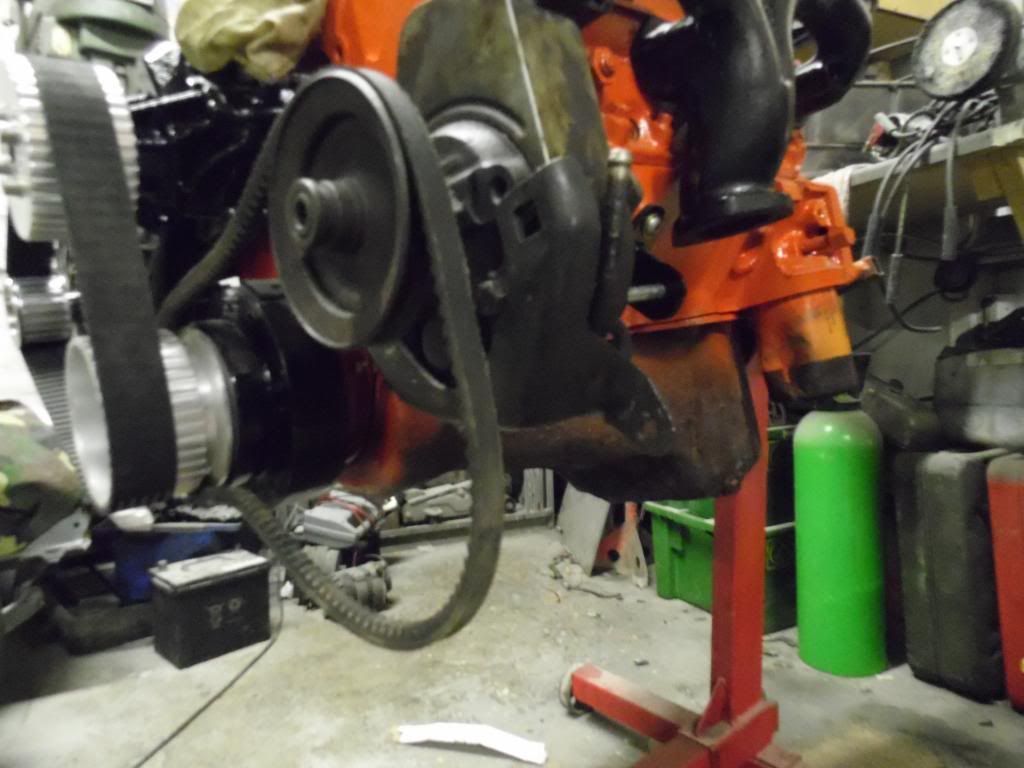

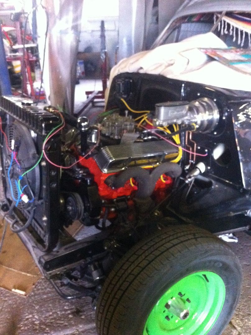

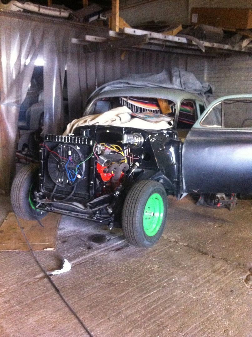

Anyway ive had a chance to do a bit of work on her today only laying the engine and dummy box in the hole to make engine mounts and make a rear crossmember to drop the rear of box slightly....
Well im pleased I got a bit done today had to trim the uprights on the firewall just mocked in the hole at the moment, but pleased ive took a step closer to her becoming a V8 lol

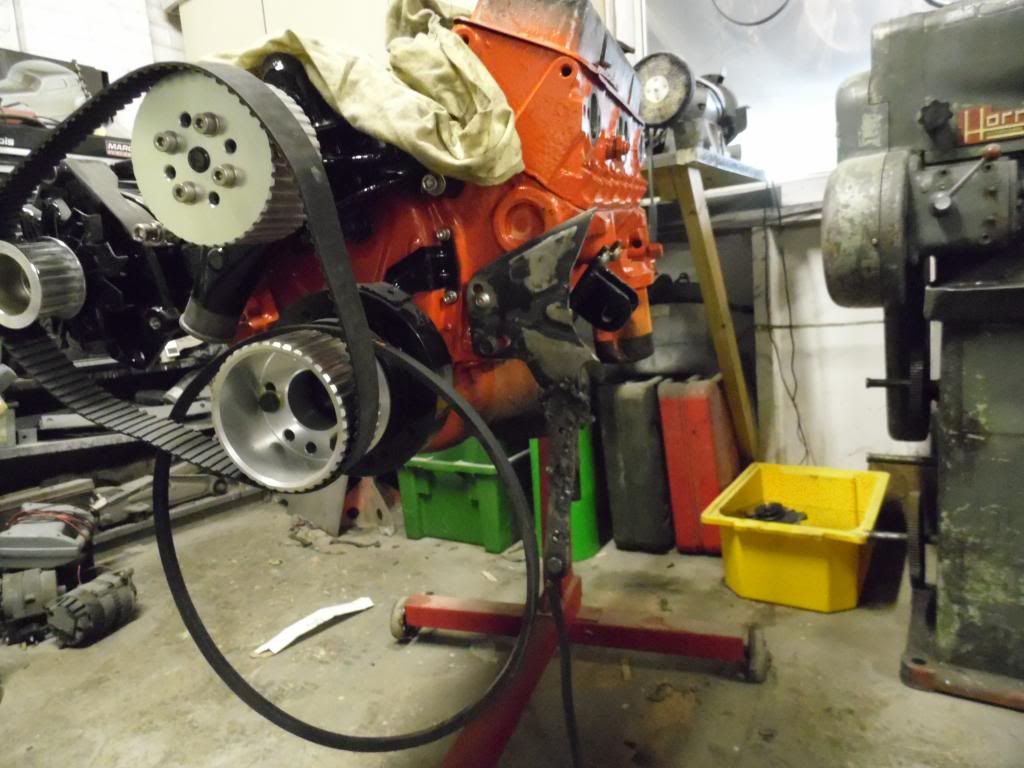

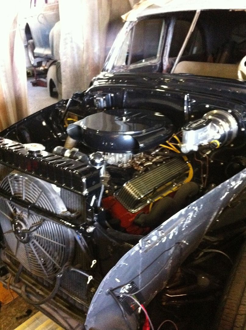

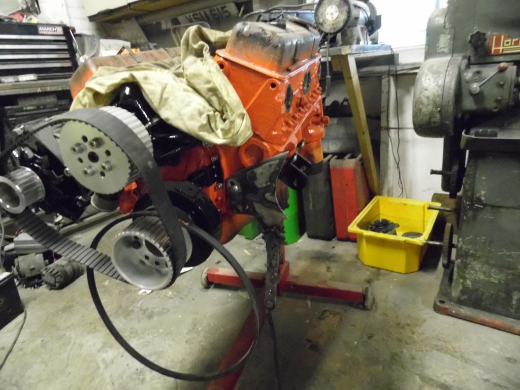

Ok been a few months since I had an update to do, but been busy on it as and when I can!!, apologies for poor photos but kept forgetting my camera so they are from my iphone...
First job was making the motor mounts and gearbox crossmember, I got this done over a couple of days...

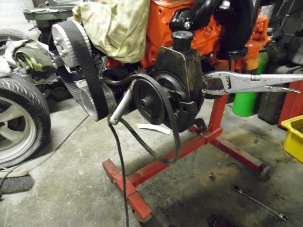

Next job I refitted the engine and transmission and then realised I had to alter the pinion slightly, I did this with metal wedges and got it so I was happy, I then measured up for the propshaft and had a local firm make this for me (well done JW Engineering), while I had the axle hanging I rebushed the rear springs and painted them...
then I refitted it all ready to put it away for a few weeks while I decided what to do for a brake pedal....

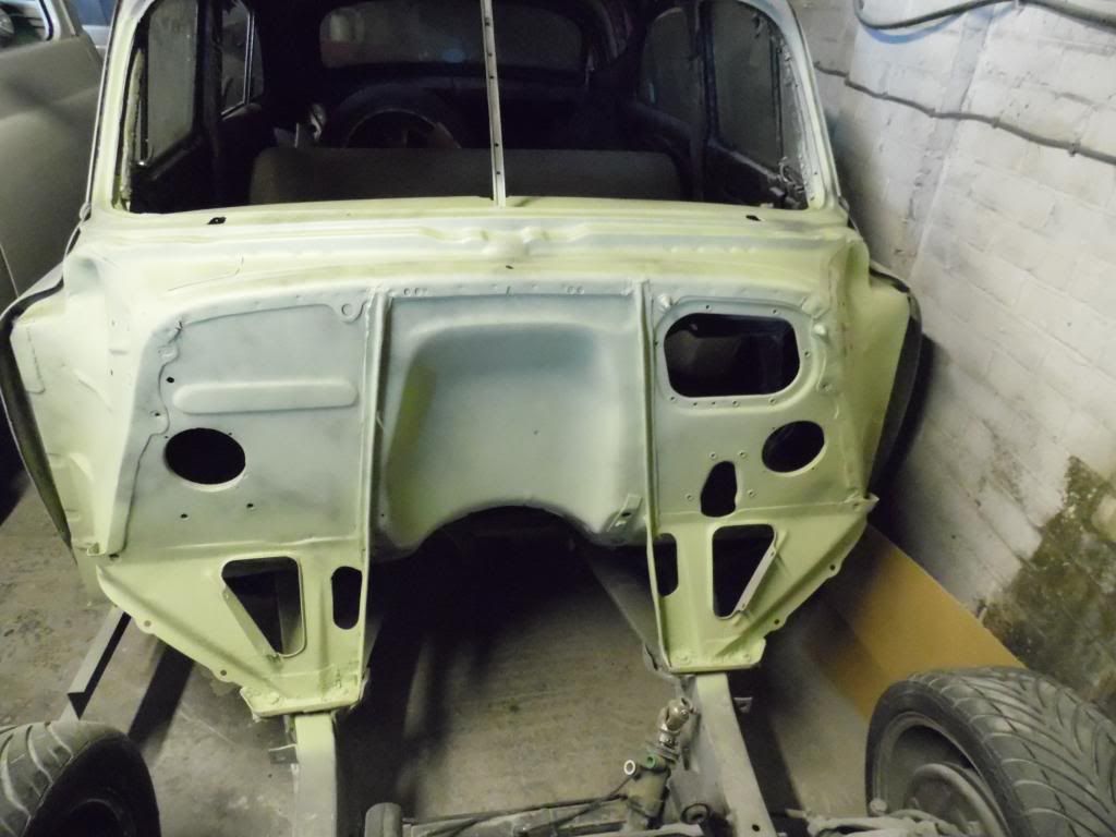

While the engine and box were out I decided to tidy up the firewall by getting rid of the many holes that were there...
I also trimmed back the bits on the firewall that were a bit close to the motor now I have fitted the v8..
I tidied these with some 6mm steel bar...

Ok like I said I've been very busy with my build it's come on leaps and bounds, here's a few pics of what I've been up to....
Firstly I overhauled my engine gave the heads a slight porting job, gasket matched them etc,

Steam cleaned and dried then degreased ready for paint, still needed to get a new oilpan at this point...
Next painted block Chevy orange to make it look like a 67-69 corvette/Camaro/chevelle. Had this in mind for the end result...
Next mocked up water pump and made bracket for the alternator, big Thankyou to my mate Jon for the help in making up the following brackets for the alternator and power steering pump.
Excuse the fat hand lol...

03-20-14 06:50 AM - Post#2437233
I got the alternator bracket made up and painted, also painted alternator and water pump gloss black and fitted a gilmer pulley drive....
And this is how it is now with the rams horns mocked up

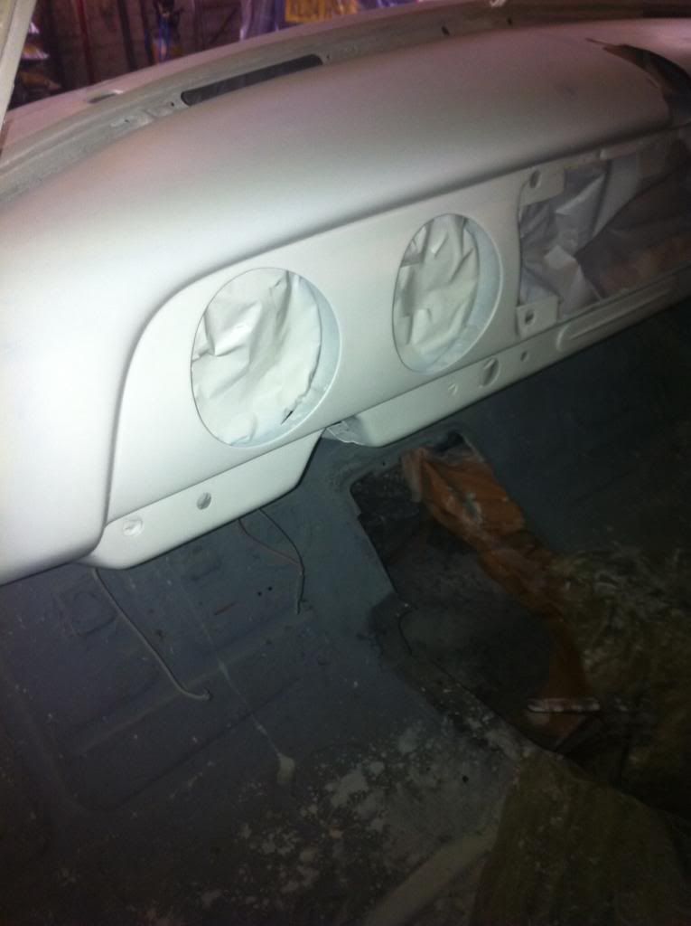

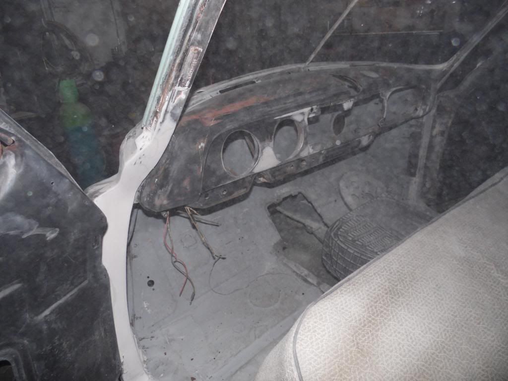

Next job I did was to repair the dashboard as where the car had been converted to right hand drive the glovebox had been cut about and looked terrible....
She is now in primer and ready for colour on the firewall and dash, but I have a few other jobs to do before I start doing topcoat.

03-20-14 07:18 AM - Post#2437241
Stripping front end and converting steering...
chevyjay
Posts: 128
Age: 41
Reg: 11-20-13
03-20-14 07:25 AM - Post#2437243
Next job was steering
old axle out and new one in...
sitting nicely...
pat59
Posts: 420
pat59
Loc: Philly
Reg: 11-17-12
03-20-14 08:00 AM - Post#2437255
Jay,
Good to see that you got the rear centered in the wheel well. The earlier pics showed it more offset. Nice job so far. Keep up the good work!
-Pat

03-20-14 08:03 AM - Post#2437257
    In response to bobg1951chevy
hey thanks for the comments, yes i am lucky my best friend has a great workshop that i can use. its coming n really well, i would like to get her ready for the shows this year, im not going to be painting the outside leaving her ratty just getting the driveline and underside all in order

03-20-14 08:04 AM - Post#2437258
    In response to pat59
Hi cheers Pat, yes it was hard work getting it centred but i got there in end, just found a couple more pics of what ive been upto last couple of weeks..

03-20-14 08:24 AM - Post#2437263
Few more pictures of where i am now, just a few getting power steering bracket built and few of dashboard before and after primer...
got pump mounted but needed a staybar as it moved a bit with a belt fitted.
ok firstly heres the firewall and dashboard getting sorted out..
next a bit of highbuild primer...
next job was to fit my power steering pump...
lined up with front pulley
just needs a bit of trimming then a coat of paint, im well pleased with this tho all worked out well, got to say another big thanks to Jon, who without him i wouldnt be so far on with my project!!!

03-23-14 12:40 AM - Post#2437980

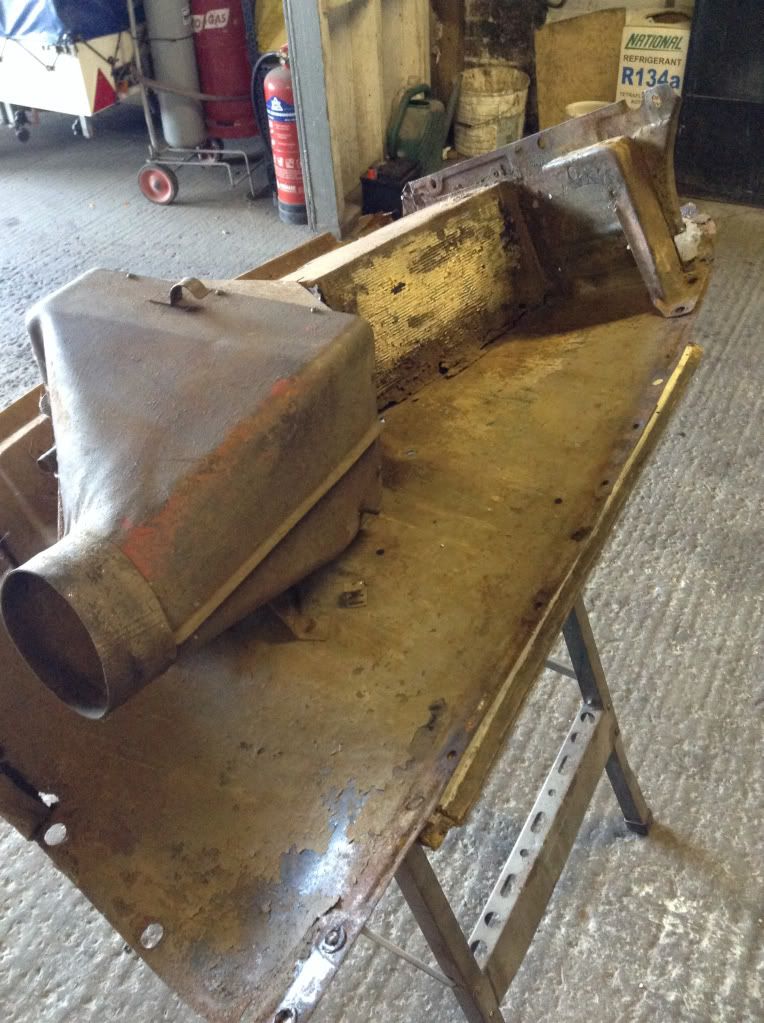

Ok I spent Friday and Saturday working on my car, now I decided to tackle the inner fenders which I have been dreading, and cannot seem to find any for love nor money over here, firstly I got them from my storage unit too see how bad they were, they didn't look too bad on first look....
And to be fair the drivers on is very good compared to what happened when I took the heater unit out lol...
When I flipped it I could see it would be bad
Once I had assessed how bad I had to start making new sections of the fender,
I then tacked them all into place for my mate Jon to weld properly as I'm not that good at welding ( seem to blow more holes than stick the metal together lol),
And how it looks now, I'm pleased with the result and when welded fully will have plenty of strength back in it.

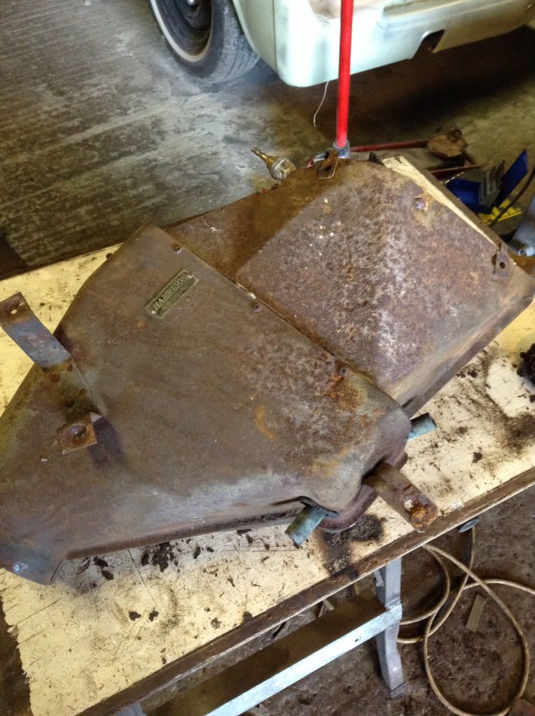

Next job was to strip and repair the heater unit, it needed a bit of welding but now a lot, I found a makers plate round the back, it's a Harrison which I think is quite common on Chevys of the 40s-50s.
I have stripped the core out and cleaned it up and done one small bit of welding that needed doing, it's now ready for zinc primer inside and out!
Well that's what I've been upto this weekend all in all a productive one

Ok the next job I had seems I had a long weekend was to get the chassis painted and do the last bits of welding under the rear, I'm not the best welder in the world so I made the plates and I got my good friend and fellow rodder Jon to stick them in, when I had them welded and ground up ready for paint I cleaned and got it ready then run out of time so had to push it back in its resting place for the week while I went off to work
Ok so a week has gone by and I managed to get it on my friends ramp and get the frame gloss blacked
Well that's all I did this time round but so glad I've got past this big hurdle, next week I have to repair my rear arches and then that's most of the welding done!!!

Next job I did was to repair my rear arches, only got one pic of this but it did take me all day to do both sides
Next job I have is to get my firewall and dashboard painted up and then I can start to get it back together which will be a big relief as it's always nice to start bolting bits back together and start feeling like you are over the brow of the hill and on the way down lol...

05-03-14 10:30 AM - Post#2449730

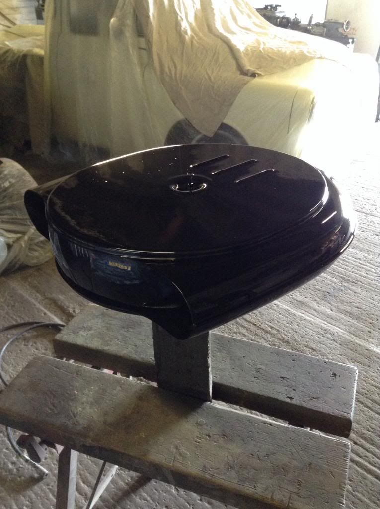

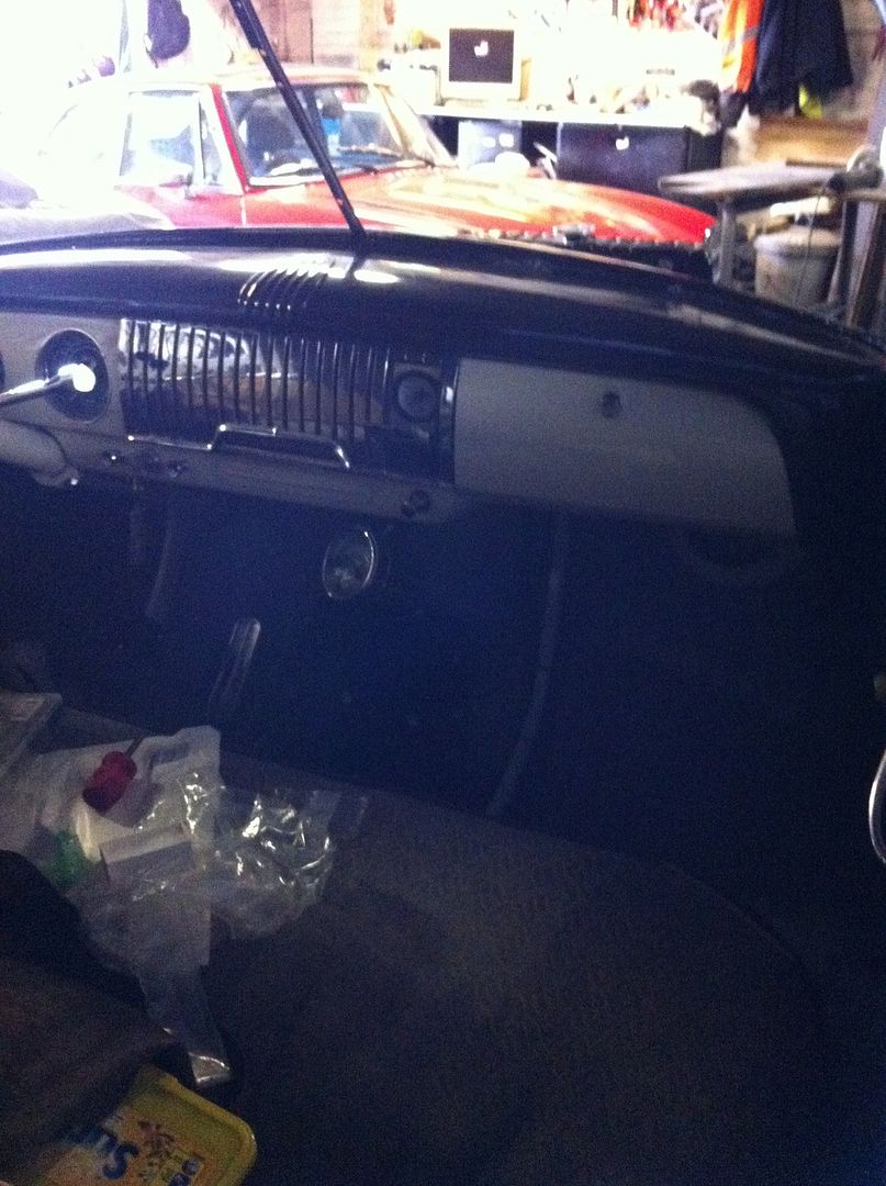

Well I've had a good day today finally got my firewall and dashboard in paint so again made a nice bit of progress,
And also painted my caddy airfilter the same colour
All in all a nice productive day so I can move onto the next job which I think will be to rebuild my th350 ready for install...

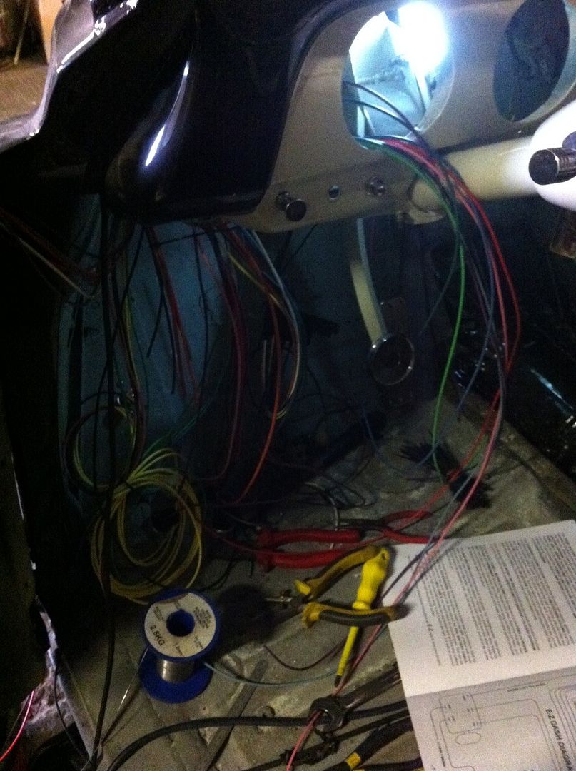

Hi all, been ages since ive updated and i do apologise but been slogging away at project and not feeling like ive been achieving much, but in the last couple of months its really started taking shape, ive managed to get 70% of the wiring done, ended up using an ez wiring harness, not the easiest to fit but it was pretty straight forward even if the instructions left a lot to be desired. Ive also had the first run out of it which sounds really nice now, ive made a custom exhaust system which i brought out through the rear bumper as later on im going to fit a taildragger but i really want to have her on the road this year so im not going to get involved in doing the taildragger till ive had some fun out of it lol. Also ive fitted my wilwood front discs and master cylinder so as soon as i have bled the brakes i will be able to have my first drive in it.
My job at the moment is trying to repair my front inner fenders as they were totally shot but as im in the uk its near on impossible to get parts.
Lastly i couldnt have done all this without my good friend jons advice and help when i got stuck lol (which was a lot more than i'd like to admit lol).
here are a few pictures i have firstly of the wiring....
as you can see its a spaghetti nightmare lol but i got there in the end...

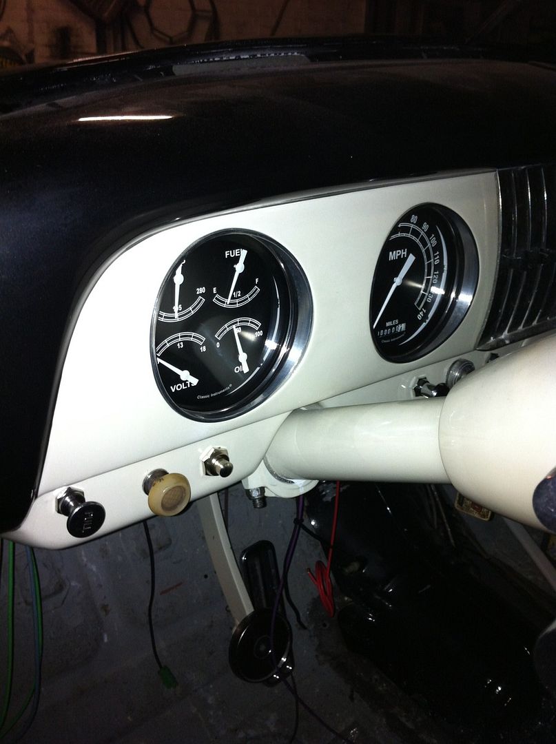

Next i fitted my new clocks, they fitted very well and can recommend classic instruments as an easy fit...

The next major job i did was to fit the wilwood front disc conversion, this again was a very easy task the instuctions were very clear and i can only say what an excellent kit this is....
I have this and the new master cylinder fitted plus all the pipework plumbed in.

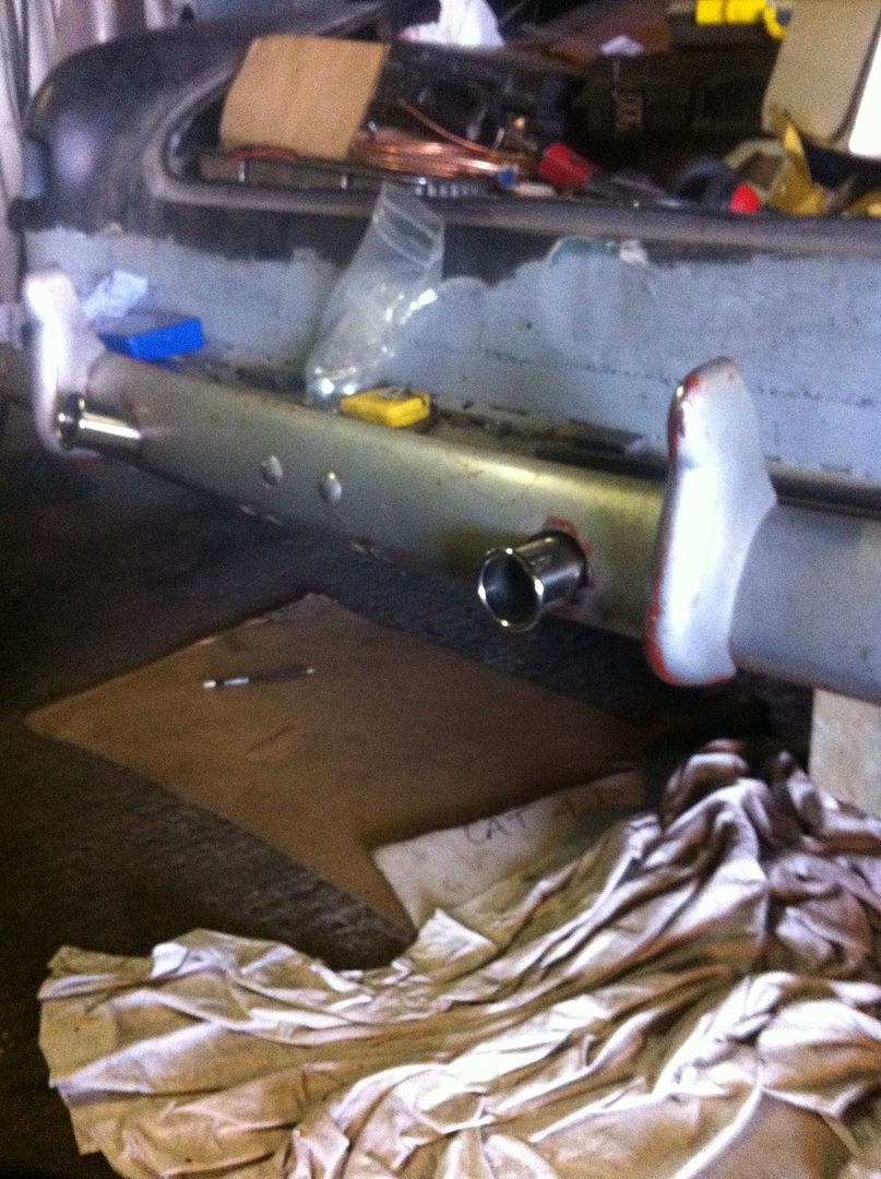

Next I made the rest of the exhaust but did do one cock up where i made it too tight to the rear axle and had to remake a bit, You can see i have it coming out of the rear bumper and will make it rattle proof lol when i finally fit it and have painted the rear bumper...
and yes i know ones pointing up in the air but its disconnected underneath so flapping about a bit lol..
these are half way through making the over axle parts...
And i had to relieve the rear crossmember but welded in 1/4 half round pipe so its as tough as before...

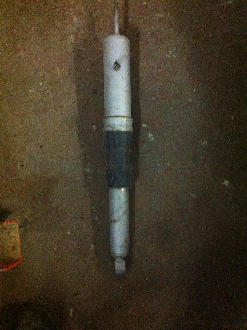

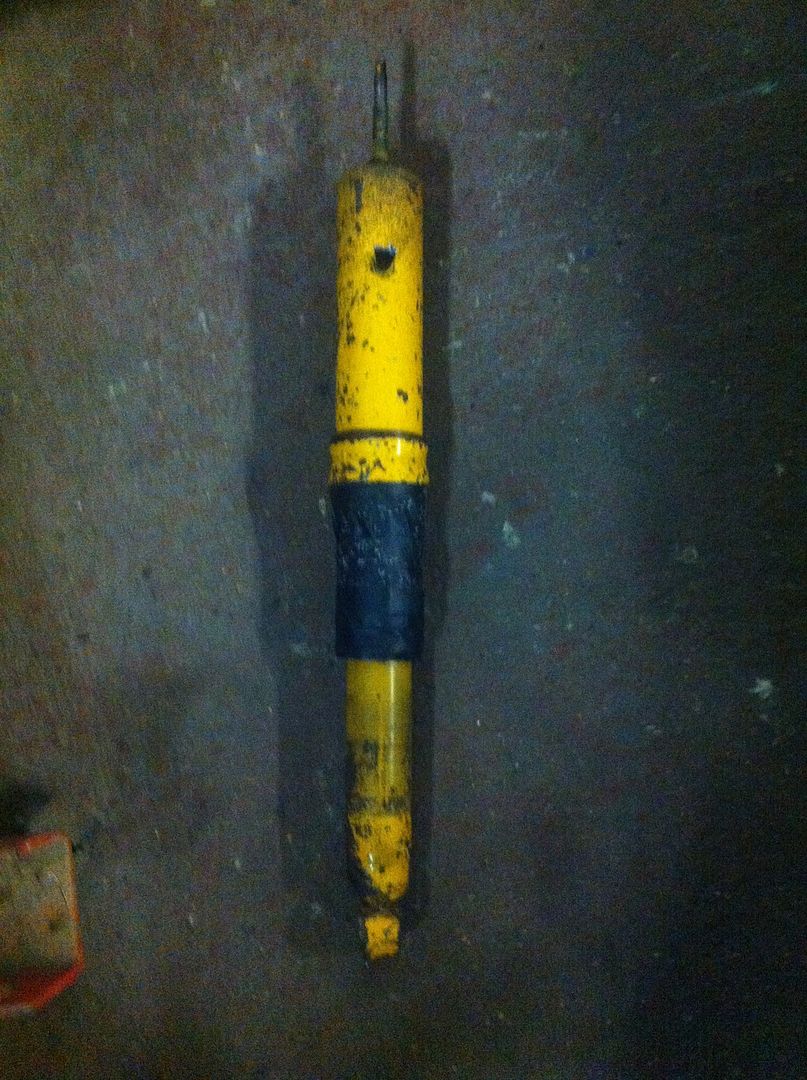

Im also at the moment using the air shocks it came with so decided to media blast them and paint them gloss black...
a quick pass through my blasting cabinet and they came out looking great, although i forgot to take pictures of them painted lol...

05-20-15 05:29 AM - Post#2548475
Time for another update, ive been getting on well with car, got all the wiring in engine bay completed plus wiring to rear end for battery, also got my inner fenders fitted, they fit well but i had a few problems lining the front fenders up but got there in the end. I only have a few iphone pics at mo which ive uploaded below, ill get some proper pics as soon as i remember to take my camera to the workshop.
