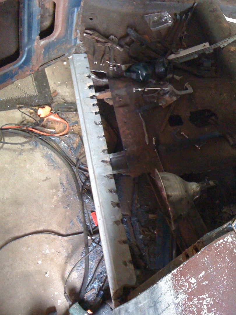

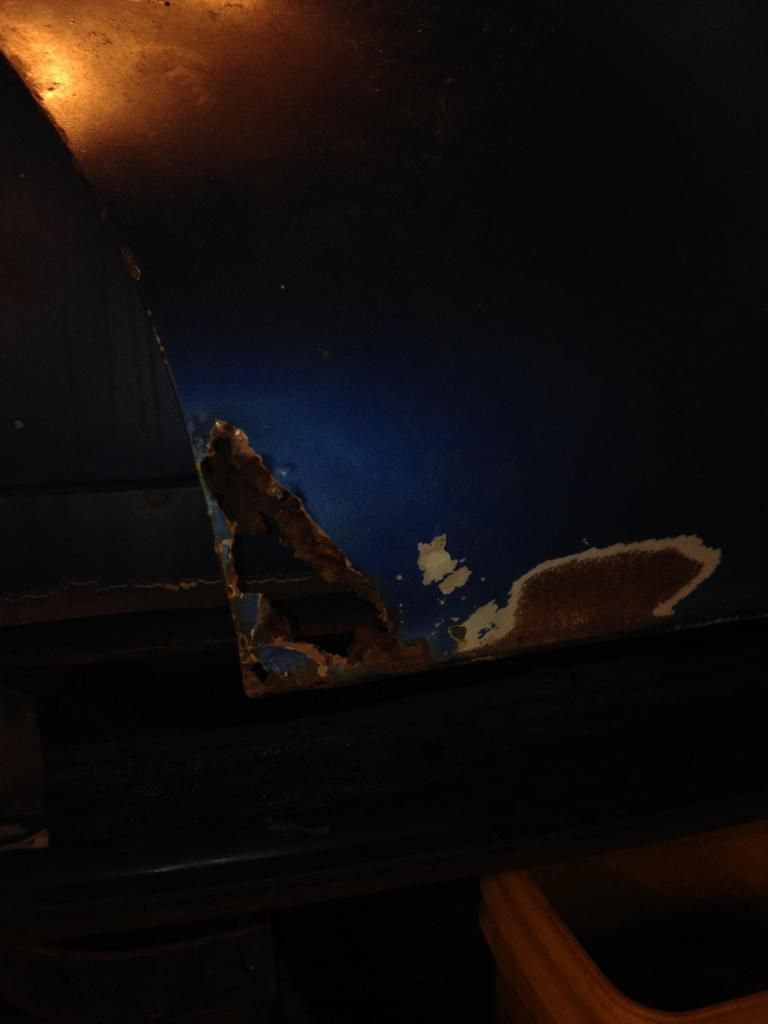

So after disassembling the rear today i found there is quite a bit of rot on the package tray on both sides the center is solid, dont know about the rear window channel yet havent got the glass out. Would it be easier to repair the rot on the package tray or replace the whole thing. How difficult is it to replace if i have to replace the whole thing? I searched for a replacement panel and found a couple but they said for 2 door coupe and had no pictures of it
heres what im looking at...
drivers side
passenger side

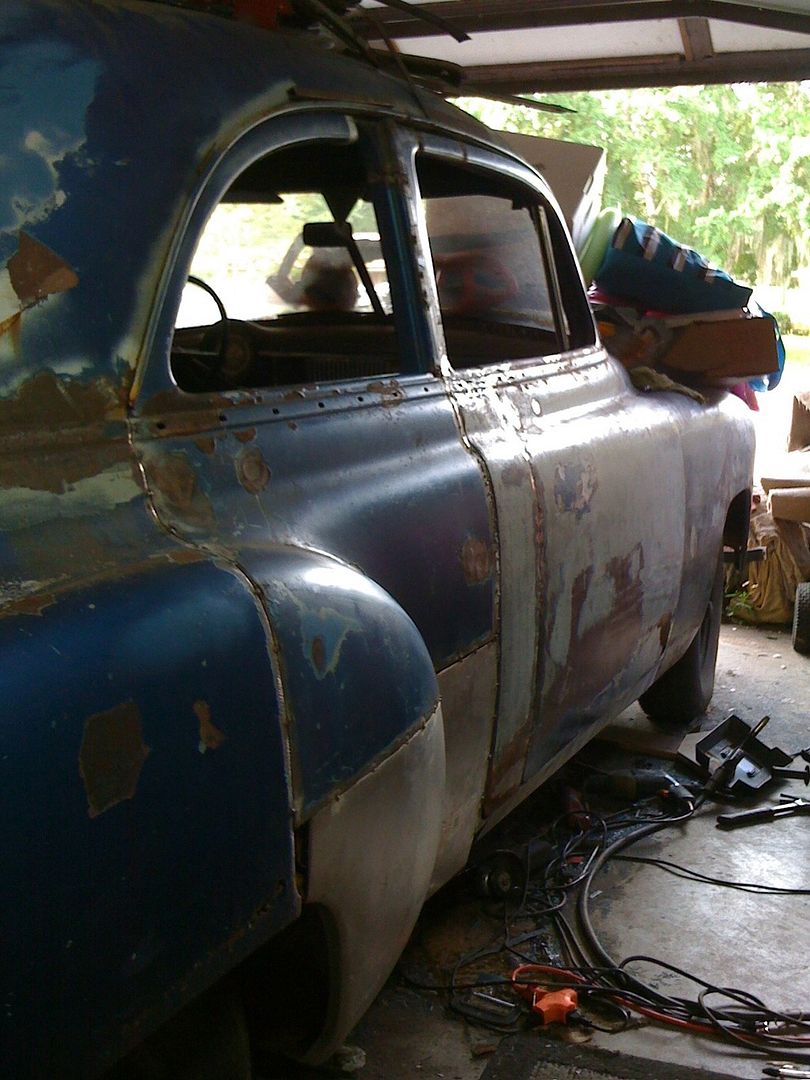

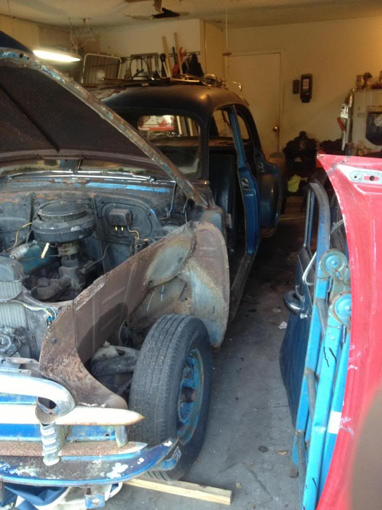

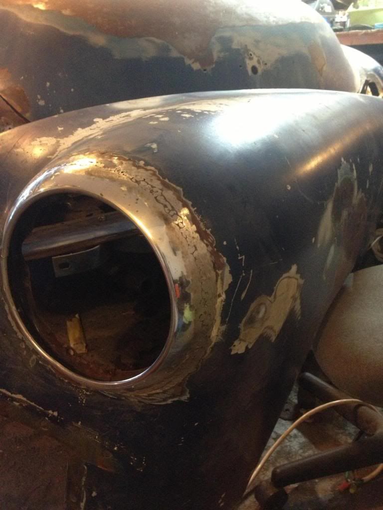

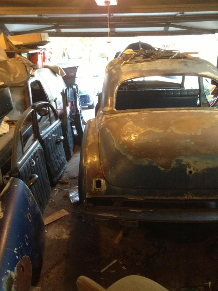

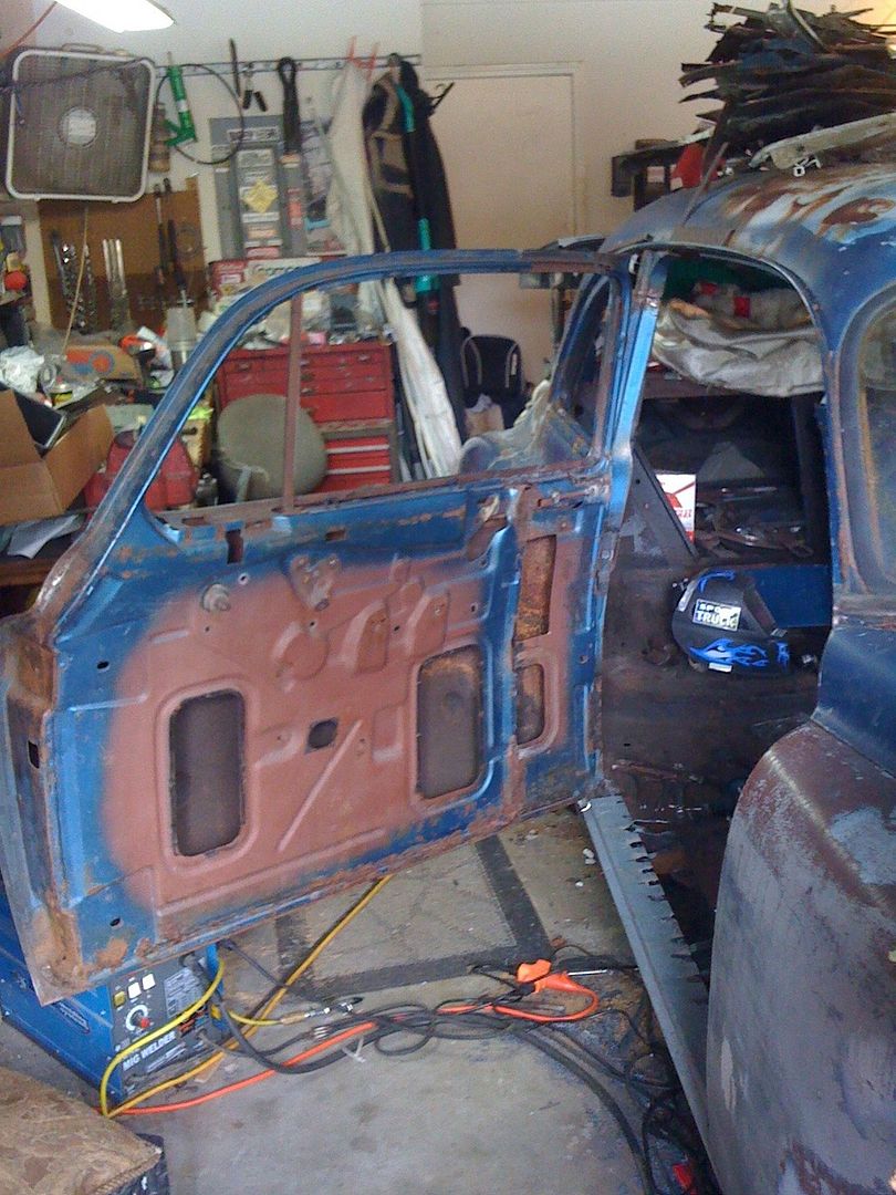

so ive been plugging away at this thing all week while ive been on vacation. got most if it disassembled, doors off, back glass out, back seat out, drivers fender off.
the more i take apart on this thing the more crappy repairs i find. there is alot more rust on this thing than i thought because it been covered over by 1/2" of bondo with a screen backing. so im just taking it one part at a time. i forgot to take pics of before the rot, but heres the after shots.
i got most of the trim holes shaved from the rear fenders.
put a good amount of work into the drivers fender. turns out the fenders were "deluxe" fenders and had the trim holes bondo'd over so i fixed that. and the bottoms of the fenders were full of rot, so i cut it all out and fabbed new metal in its place. also frenched the headlight while i was welding on it.
i started on the drivers back door when i ran out of time digging thru the inch of bondo over a rust repair.

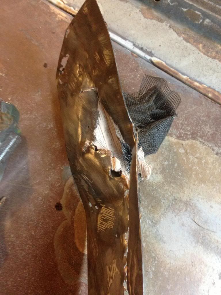

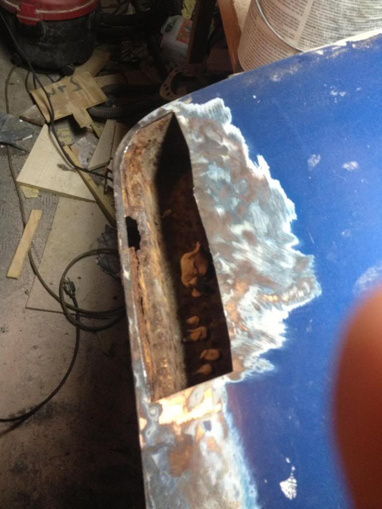

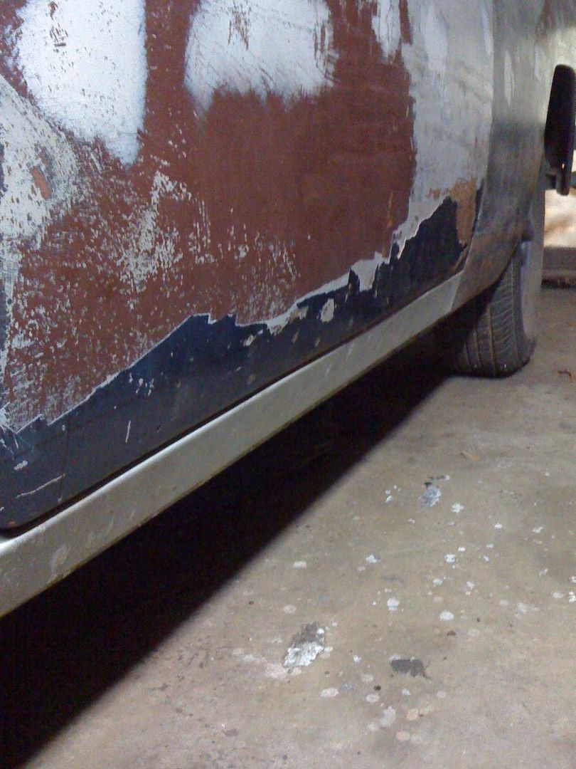

wow can't believe I forgot to update this when I was updating some of the other forums I'm on... Heres some updates to bring this thread current...

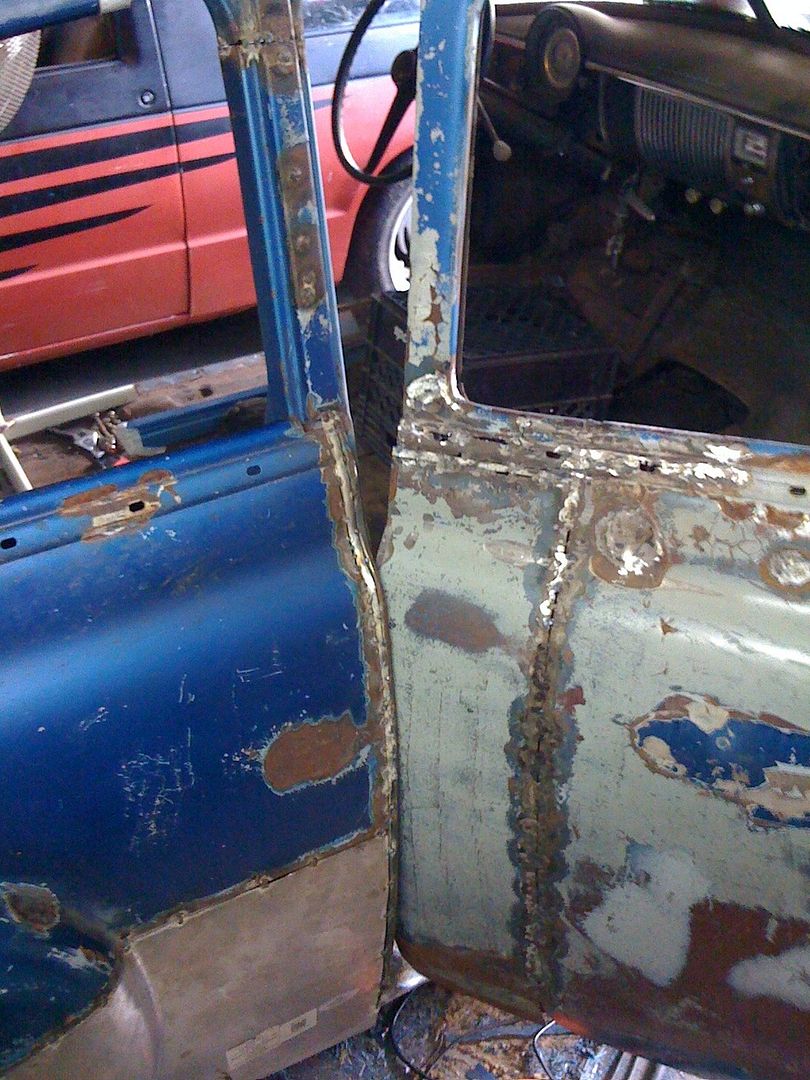

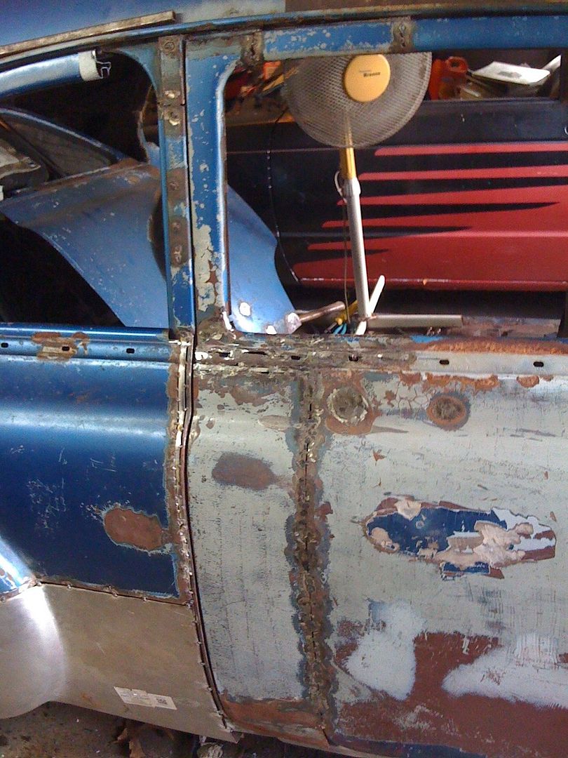

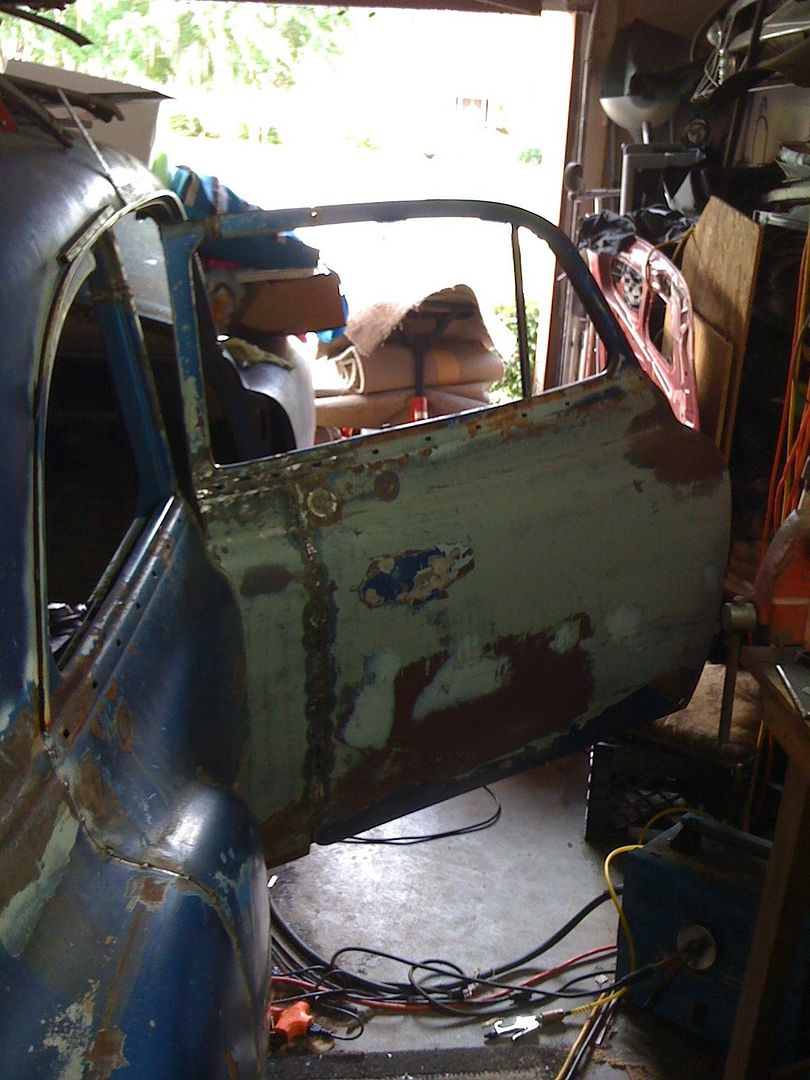

got most of the drivers back door done, still need to shave the door handle. still cant believe the amount of bondo on that door and how it didnt crack being that thick i dont know. i cut out all the bad metal and replaced it. also shaved all the gravel guard mounting holes as well...
this shows how much bondo was on this so called repair
this is what was under all the bondo
the screen backing and how much the metal was pushed in
how much i had to cut out
finshed repair

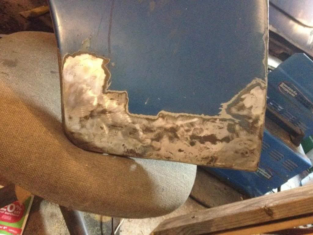

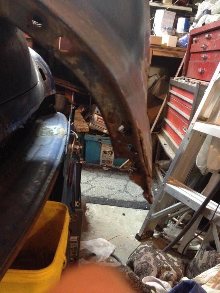

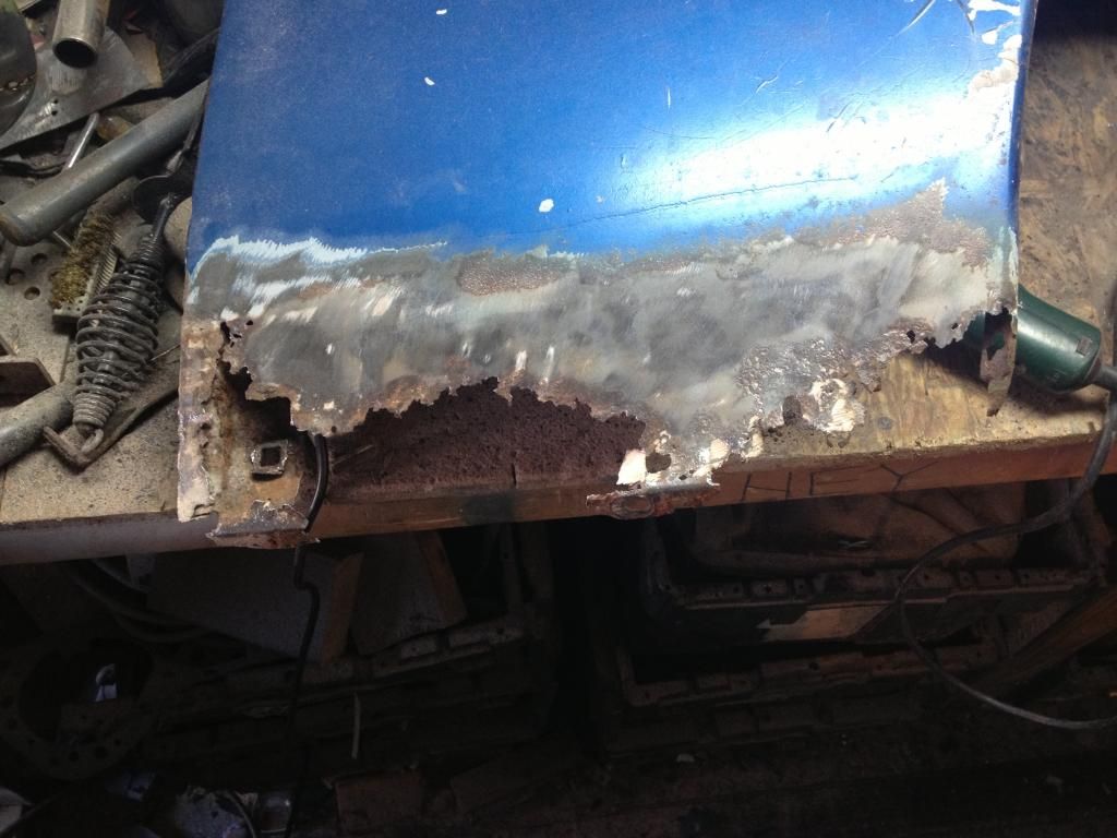

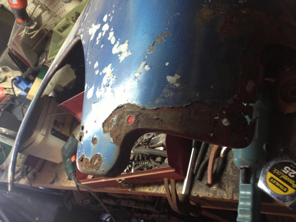

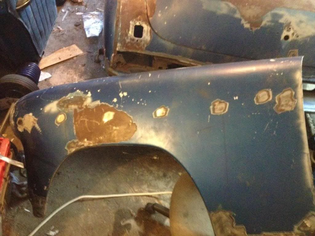

This is the bottom of the pass side fender. By far the worst panel on the outside of the car. It was literaly bondo'd on the car.
Before:

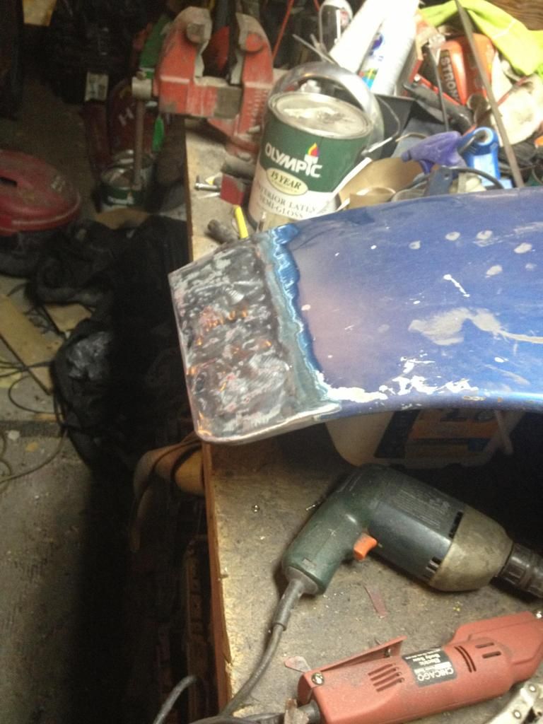

I had to completely fab the bottom half of the fender including the radius of the wheelwell since there wasnt enought to use as a template. I had to take measurements from the driverside fender to make the new piece. Also cut out and fabbed a new piece for the front of the fender by the grille opening as well.
After:

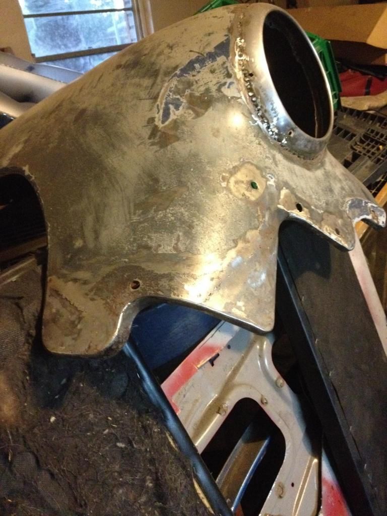

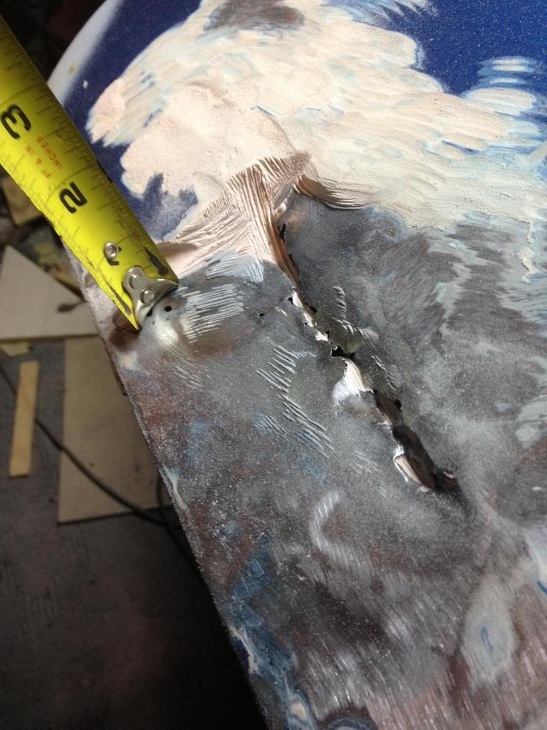

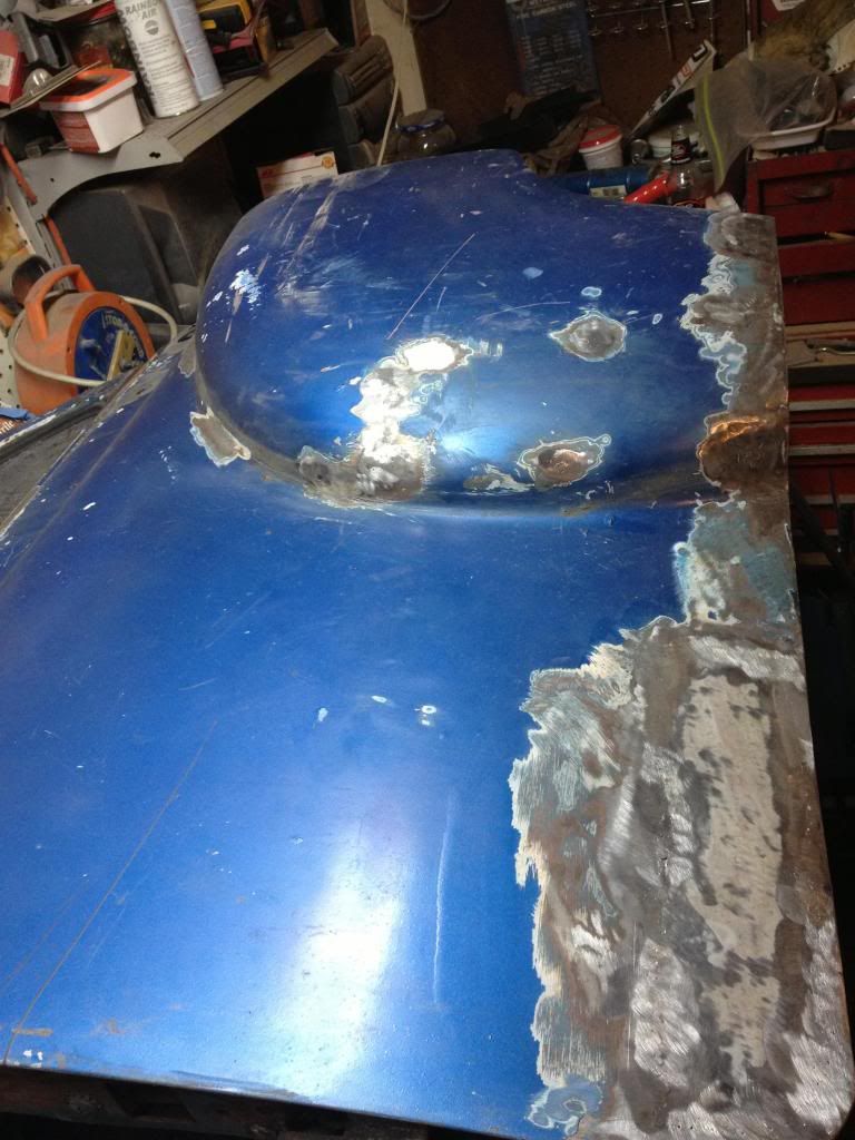

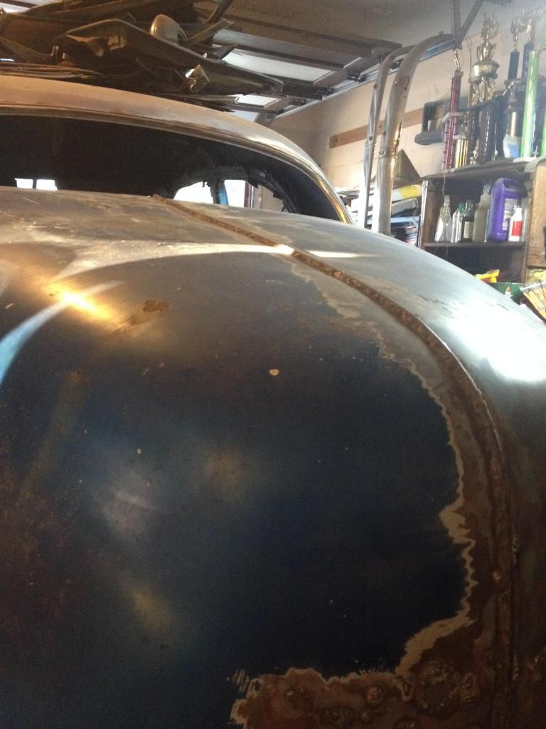

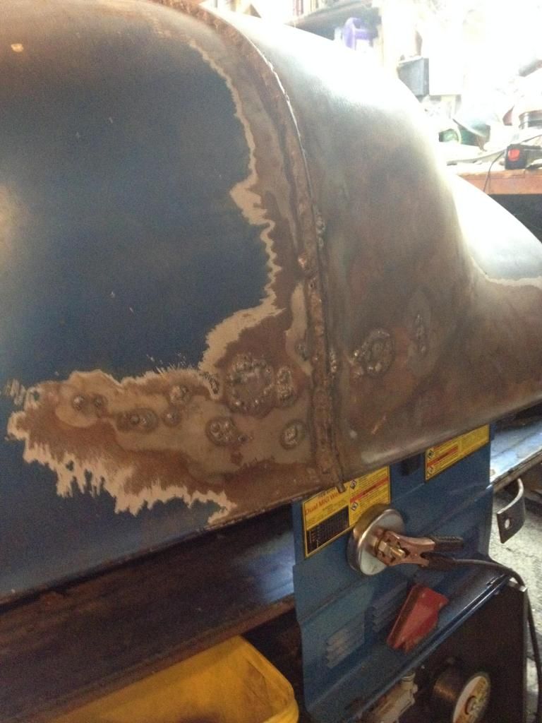

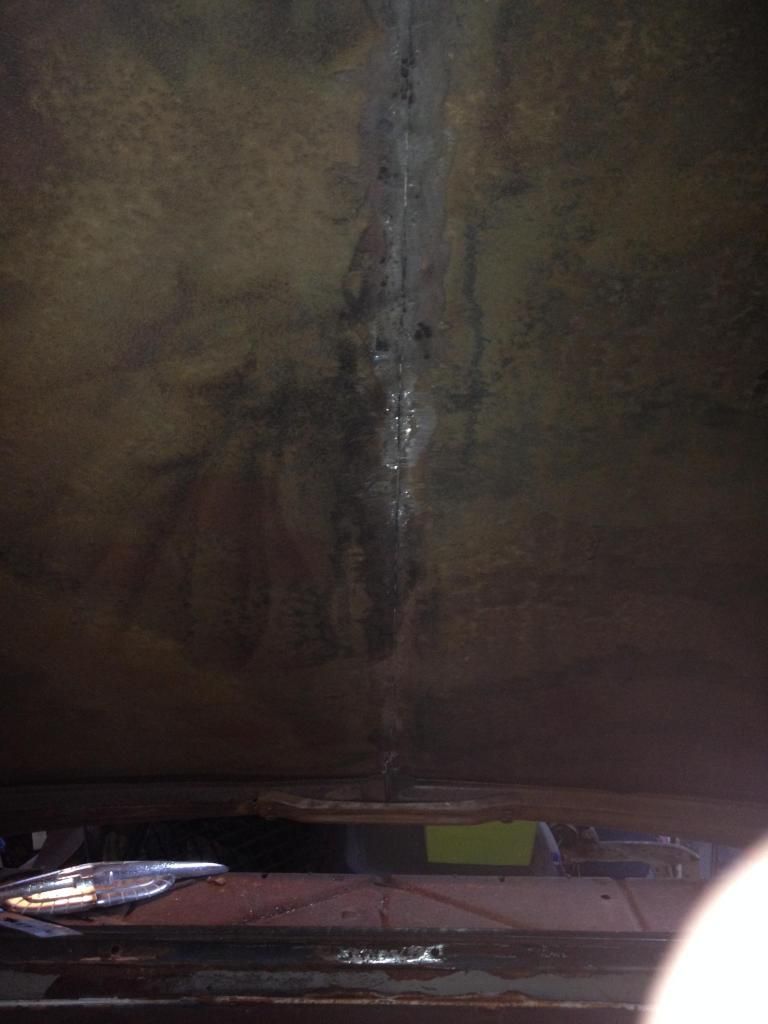

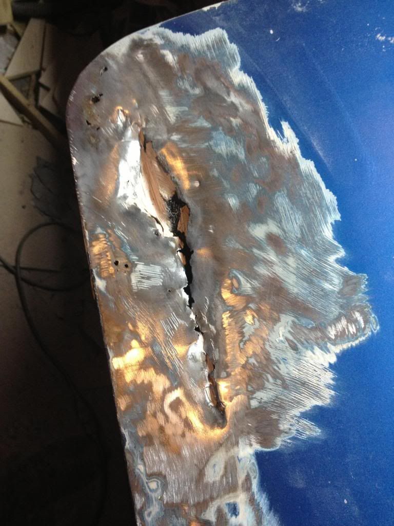

The hood I am still working on but wanted to update the thread with where I am so far. Since the PO just bondo'd the seam on the top of the hood, I decided to weld the two halfs together and create a reveal peak from front to back. I use a piece of 1/4" stock to attach the two sides together and give it some added strength. Then i cut out the flange from the bottom of the hood to clean up the appearance from the bottom. I also "nosed" it as well shaving all the emblem and badge holes. I still have to grind down all the welds on the front and sharpen the peak so it isnt as round. And I still need to cut off the rotted corner of the hood and fab a new piece, then ill clean it all up and put it aside to start working on the rockers and floors.
Nose and peak:
Bottom side:
Front corner that still needs to be fixed:
Thats all I have for now, hopefully Ill have more done soon...

I got some work done on the doors. I only have one day a week to spend in the garage so progress is slow. I got this done over the last couple weeks. Thanks to all who helped with their door dimensions a while back, it really helped with this project.
This is a 2 door conversion with stock hinge suicide doors. Im cutting the front of the drivers rear door off and welding it to the back of the passenger front door so I can use the stock back door hinges to suicide the front doors so they fold into the body instead of the barn door style hinge setup. Then Im switching the drivers and passenger B pillars relocated for the longer doors so I can use the stock hinge mounts. Then Im taking what is left of the rear doors to skin with the new lower front 1/4s to fill in what is left.
Heres the first step...
Whats left of the back door...
Backside of the door...
Hinge and side shot...
Done... more or less, needs finish welding and grinding after the b pillar is installed incase it needs some tweaking...
B pillars removed...
still need to cut the top of the pillars off and flip em so they match the angle of the roof...
Ive got the door installed on the front hinge for now so i know where to install the B pillar, hopefully I will be able to get it installed in a couple weeks when I have another weekday off. By then I should hopefully have the lower front 1/4 and rockers to put in and I can finish up the passenger side. Ill more updates then.

Pass side is mostly done, door is almost completely welded up and swinging suicide on stock hinges. Its now a 2 door with the new lower front quarter panel and remnants of the back door tacked in place. Still need to install the lower rear quarter panel and wheel arch. Inner and outer rocker panels installed, ready for floor pans when I get em.

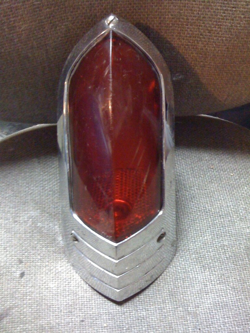

After pass side is done im gonna add these 49 buick roadmaster taillights in the rear fenders, the drivers side will be hinged for access to gas filler.
