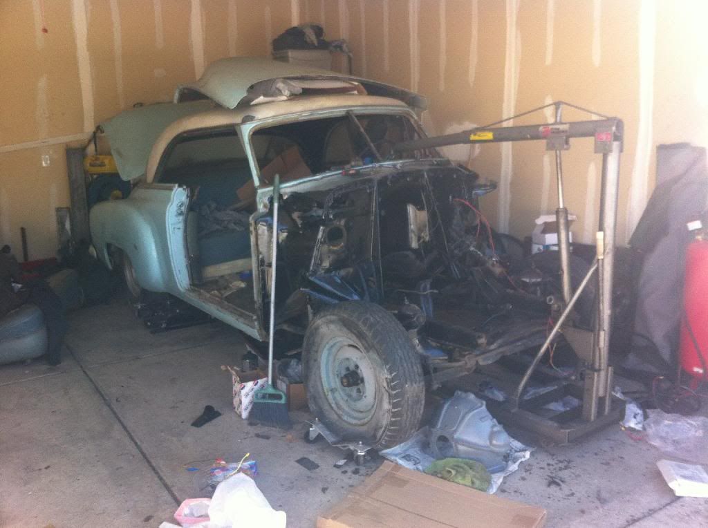

As promised... Here she is. The lock on the storage unit was rusted to the point the key wouldn't turn.
So the title says 1952 Bel Air and I'm no expert. I believe it would be more accurate to say Styleline Delux? I'll have to decode the Vin tonight. Ohh and I'm upating the profile.
1952 Chevy 2 Door Hardtop
Great body - straight
No interior to speak of - the spring pokes me in the...
Engine is officially a work in progress

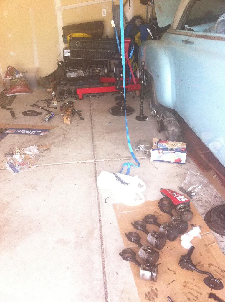

Ohh I did... its now in my garage... This weekend I'm going to get her on casters and doing me some bearings or breaks... one of them anyway. It was a monster to get off the flat bed and into the garage.
One day I plan it drive it out

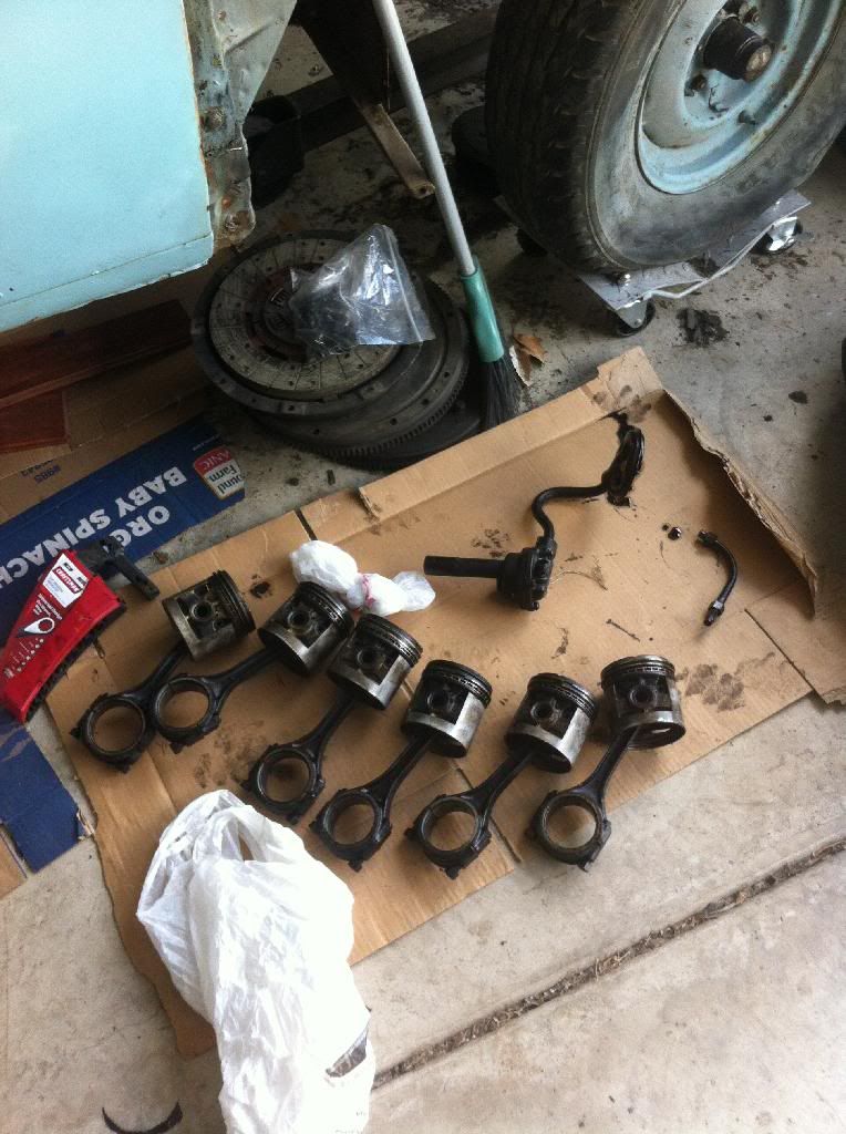

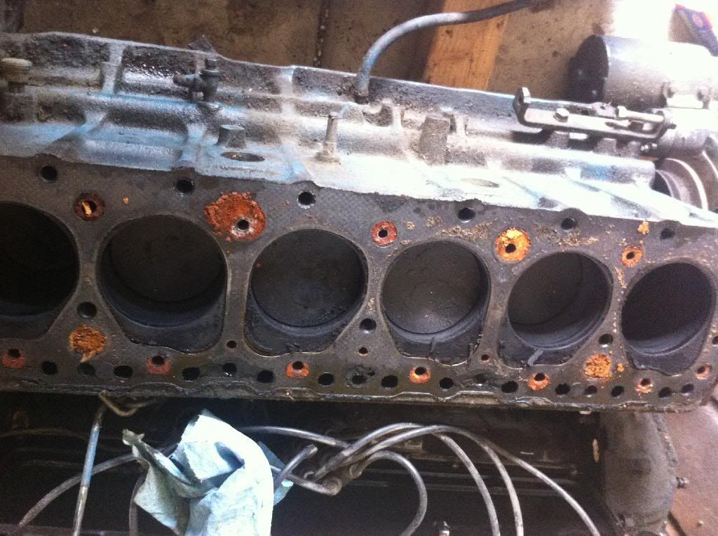

Thank you. So the casting was on the passenger side, and I knew better... but it was also some stuff on the head. (blame it on late nights in the office). But that isn't on the block...
I pulled the valve cover off and got some more info on the head. E27 3 was what I found.
another stamp
I also noticed that the copper oil line that runs up over rockers has come mighty kinks in it. I'm pretty sure this isn't an optimal config.
I hope this works out to be good news. If the motor isn't a splasher, I don't need to track a more modern one down, as I have that. Heres to hope!
If anyone has any ideas on where to get a good buy on generators - let me know
On a side note - I needed to get some of my garage back, between the Chev and the Jeep it was pretty tight in there. I went with some wheel caster dolly things from horror freight. This car isn't light, at all. There is no "push and it goes here". Point the wheels in the direction you want to go and give a mighty heave(or 3, or 10)!
I plan to start pulling wheels tomorrow, I'll see what father time has brought me. Stay tuned...

If the casting number of the head is 3836848, and the date code is E 27 3, then as I understand it the head was cast in 1963 and is a replacement head--that's good news.
My guess is that someone has replaced the engine at some point in it's life. The B53 848 350 number doesn't look like an engine casting number to me. If you could pull the starter and look on the block for the date code cast there, it would help.

Thought I would post some progress...
Pulled the engine and front clip. I'm currently working on the mechanical stuff.
1) Pull front clip off (check)
2) Remove Engine (check)
3) Rebuild Master Break Cyl (inprocess)
4) Replace the old nasty rubber break lines (inprocess)
5) Rebuild the break wheel cyl
6) Degrease the engine bay (inprocess)
7) Paint engine bay nice and pretty
8) Transplant new engine
Its amazing how fast these cars come apart...
Dave a friend of mine was nice enough to bring his son over and help with pulling the engine (as well as some other issues that came up). This guy is the MAN! Thanks Dave!!
Post Dave intervention!
This rust on the roof literally has kept me up night. I've been terrified that it had rusted through over the long sleep in the storage unit. The guy who helped me paint this years ago wasn't what you would call a pro. This is the rust spot, complete with bubbling and cracking. I think this is why preparation for painting is so important
All the various colors of my Chevy!! Hehe its been painted a few times!!!
I couldn't take the mystery of what was hiding under there... So I went at it.
Well I'm pretty sure that the breaks will get sorted out in the next little while. I think this weekend. I hope.

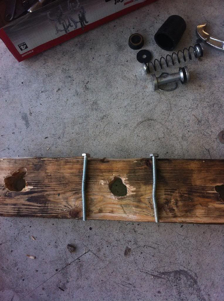

Went through the breaks, since the engine was at the machine shop. I had a frozen brake drum, and after a few hours of trying to pry it off, hitting it with a shot hammer - slowly I came to the realization it just wasn't going to be a casual affair.
[image]http://s1177.photobucket.com/user/jk_justinjames/m edia/52/AA36821D-CD32-448 3-B34C-35AB8BF12A87.jpg.html]
I rigged this to create some outward tension on the drum... and smacked the crap out of it again. It broke free just before the 2x4 which was starting to split apart. I took a pic of the bent bolts.. just for fun. If I were to build this again - a slit is better idea then a large hole for the arms. Fyi - I think this is about the best and only use for a harbor freight gear puller.
And the obligatory victory shot -
on the topic of the engine, I discovered why the engine felt starved of fuel. No wear at all on the lobe, none at all!,
fun shot of the block -
tear down was a lot of fun -
another -

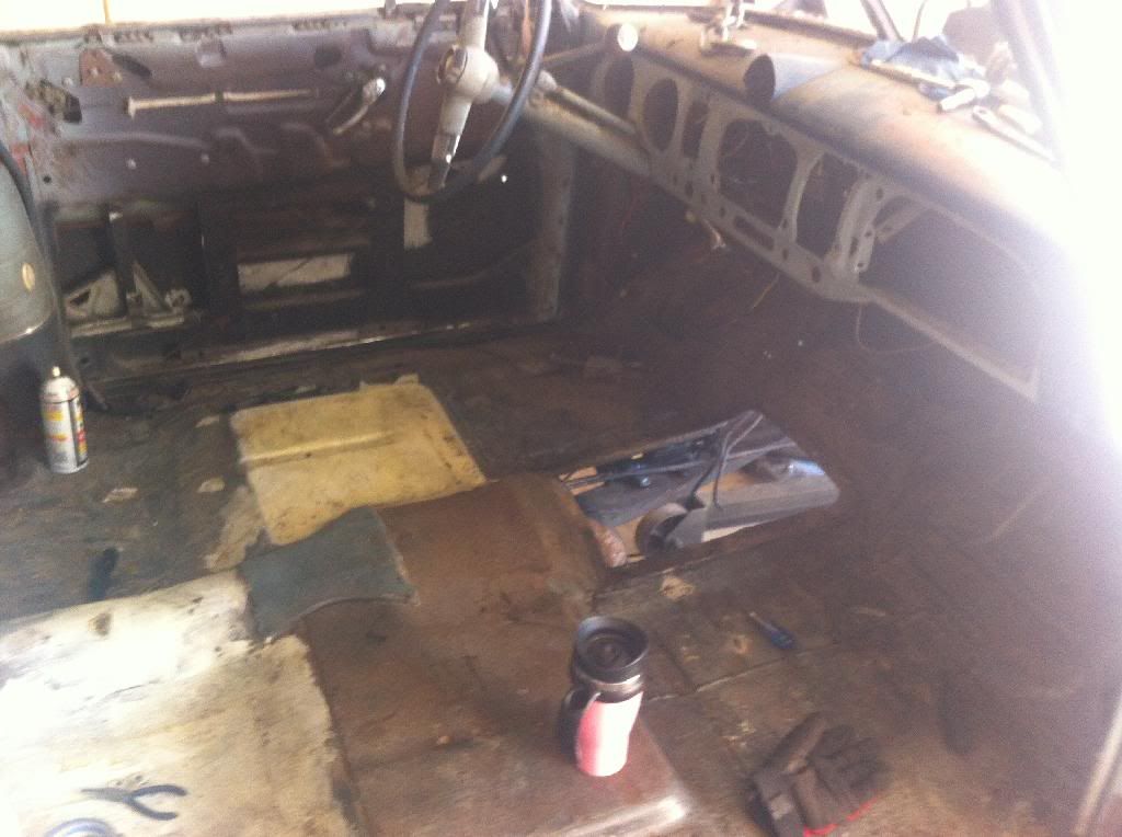

While waiting on the machine shop and forthcoming engine, I have started the dash. I sprung the passenger door years ago and it never closed right after, and there is some rust. So its off!
Going to rewrire the whole car... and paint the dash and firewall next weekend, I hope.
Incredible how much work lies between here and the road!
