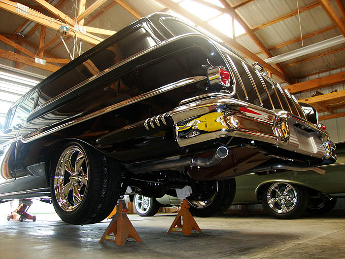

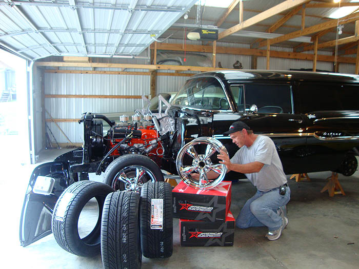

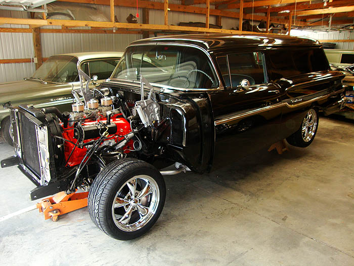

Hey guys,
It finally cooled down enough to get the brakes finished up & the new wheels put on now. The only thing left to do underneath, is to shorten up the driveshaft so she can go back on terra firma. Getting closer to starting her up now too. Here's a few pics.
Attachment: Picture_116.jpg (110.76 KB) 38 View(s)
Attachment: Picture_129.jpg (122 KB) 20 View(s)

Looks great, Jens! For reference purposes, how about telling us what your tire sizes are, and rim diameter / width / backspacing you are using?

We tried several different sized mockups with the goal of going with the tallest/widest wheel combo we could use without running into any stock body/suspension clearance issues using 17" rims.
We ended up going with American Racing torq thrust M (chrome series) part # AR605M7861C. Wheels are 17x8s with zero offset. Back spacing is @ 4.50" I believe. Tires are Hankook ventus H105 directionals ~ 255 45 17s all the way around. I guess this means the dog dish caps go back into hibernation. lol.

Just to clarify, you are using that same combo front and rear? Any exhaust clearance issues in the wheelwell? And stock drum brakes up front (no disc-kit that changes the tracking width?

Yes the same tire/wheel combo front & rear w/ stock drums/brakes all the way around. No exhaust clearance issues. The 2" exhaust is tucked an inch away from the coil springs. That leaves about 1 1/2" on the inside of tire from rubbing on the exhaust. The outside of the tire has about an inch of clearance at the wheel well opening (see previous pic).
We tried some 255 50 17s, but it didn't look like it would leave enough of a comfort zone for body roll/sway on the outside wheel well as far as I was concerned. Here's what the inside exhaust clearance looks like.

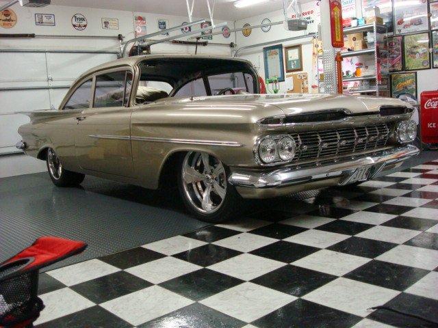

Attachment: Vista_II_1.jpg (71 KB) 11 View(s)
Attachment: Vista_II_2.jpg (50.26 KB) 13 View(s)
Not to hijack your post Jens, but I just have to share a couple of pics of the new Intro Vista II wheels and MT SR radial tires on the 59. I hope they do make her look PHAT!
