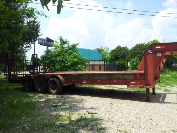

Now originally the reason I had a Crew Cab dually is I was planning on buying a Goose Neck trailer and hauling all my stuff back to Montana when I finished school, and recently I have been needing a truck with a trailer on several occasions and my C/10 just has not been cutting it.

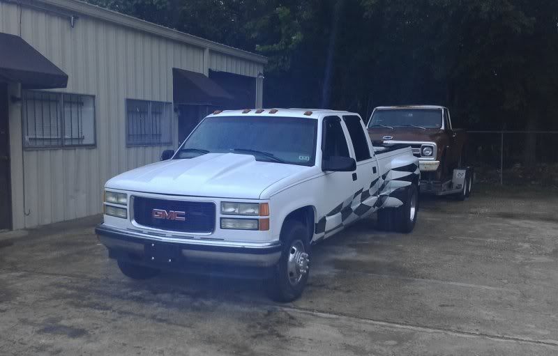

Thus I have spent the last couple of weeks truck shopping and found this one:
I made the deal on it today, and this weekend I will be driving to Dallas to pick it up.
Tomorrow the guy I am buying it from is going to get it over to a shop to have a B&W turnover ball installed in the bed. This is so I can also get this:

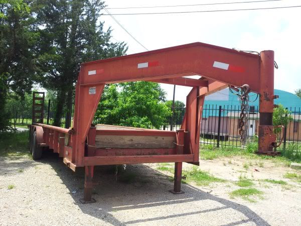

It is a 26' 21K goose neck. I am super excited about it because this is a huge mile stone for me because it is the means by in which I will be moving when I graduate college back up to Seattle. This trailer is going to get that job done for me.
I am really excited about it, I will post pictures when I get my hands on it, and show you all the little road trips I make with it.

Cool! I remember seeing that one in the links you sent me. Looks like a nice truck...and it's the right brand.

Hey, way to go Nick. I like that truck. The GMC and checkerd flag banner does it for me.

I am going to put some red lettering on the side, I think it is going to look damn sharp hooked up to that trailer :D

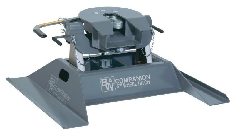

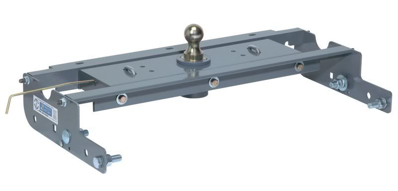

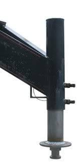

Well a small update, tomorrow it is going over to get a B&W turnover ball installed in the bed, then I will be picking it up Saturday afternoon.
When I make my trip to Montana my dad has a B&W 5th wheel coupler I am going to take off his hands.
And I am going to get one of these for the trailer:
That will convert it to a 5th wheel, which I prefer because I think they tow a lot nicer, and you don't have to crank them up super high when you are unhitching.
It will be really nice if I put air ride on the truck because I wont even have to crank the trailer up then, I can simply set the landing gear down, drop the bags and slide out from under it.

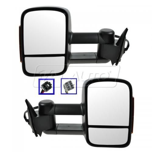

I just ordered a set of mirrors for the truck.
They are heated power adjustable and have the turn signals on them. I am going to get everything wired up proper I think it is going to be very nice having that all setup. They are going to be really nice over the stock sport mirrors.

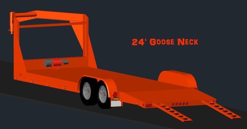

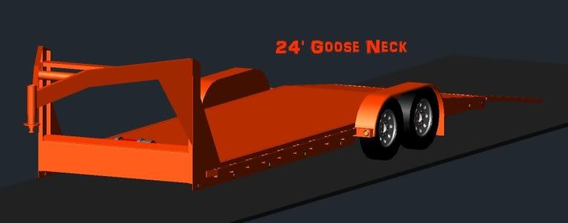

Spent the last 6 hours designing this:
I think since I have some time on my hands where I can do it I am going to build it.
It is a 24' Gooseneck, the deck is 20' with a 4' dovetail. The ramps are 72"

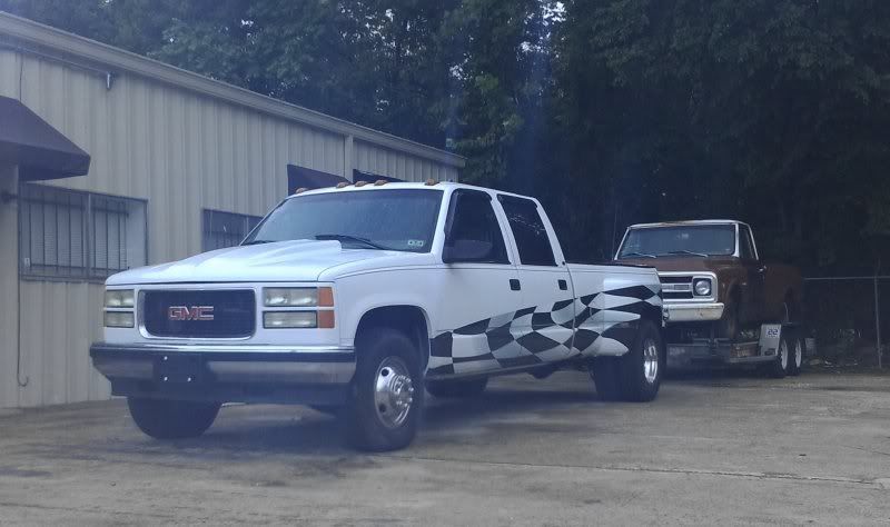

08-24-12 03:34 AM - Post#2262667
    In response to MrBeast
Things have been a little crazy for me, There was a delay in getting paid some money I was owed, so it took longer to go get the truck than I was hoping for.
Finally yesterday I got the check I was waiting on, and I scurried up to Dallas and got my truck. I was pretty happy.
I ran over and rented a uhaul trailer so I could get my other truck home. And on that note for being a 42 year old truck that old C/10 didn't skip a beat the whole way to Dallas.

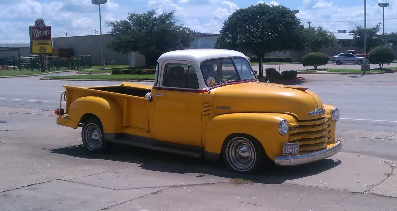

Also on the way up I saw this old guy at a shell station where I stopped for Gas.
I think it is a 53 5 window. It was a pretty cool truck none the less.

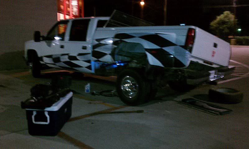

As far as the new truck goes, I did have a few issues with it, when I got there the battery would barely turn the engine over. and the the AC was not working, nor were the dash lights. I checked around for a little bit, but could not find why, so I had to get on the road.
I made it about 50 miles and the cruise control quit working, I pulled over and shut the truck off, hoping that turning it off and then back on would help, but the truck would not restart. I pulled the battery out of the C/10 and was able to get it to start, but the cruise did not work.
About 5 miles up the road there was a gas station, I stopped there and got some food and drinks, when I came back out the truck again would not start, it was just clicking. I wound up pulling the battery terminals apart to find that they were very badly screwed up, I cleaned them up the best I could, but the cables had already been shortened several times, so I was left with not much I could do.
The truck did start up after a bit of protest, and all of the sudden the AC was blowing cold, albeit out the floor vents. But that is an easy fix.
I got on the road again, I made it another 20 or so miles and the dash lights lit up and worked with out issue the rest of the trip back.
The motor has a hesitation to it, and does not idle well. I am thinking that either it is having the distributor issue many of these trucks had, or it is suffering from the leaky injectors they also suffered from. I am not sure which it is, we will see, I am going to run over to a friends shop today and set the timing.
Also the transmission as I was getting close to home started shifting really hard, and most of the trip back it wanted to stay in 3rd instead of going into 4th. I am guessing I will be putting a trans in it since it does have 151,000 on it, and with that it is about due so I am not going to get really upset about it, even with these issues I still got a pretty good deal on it.
It also appears to have a rebuilt engine, it has a couple of new pulleys on the engine, and the paint on the engine is new, as well you can see the gaskets are new.
Over all I am pretty pleased with the truck, I am going to have to find a new dash for it, a new B pillar plastic, and the trip piece for over the back window is busted, the drivers seat is a bit wore out. But other than that it is pretty clean.
The plan for today is to first get the mirrors thrown on it, then I am going over to a welding supply place to make some new battery cables. Then I will head over and kick off the uhaul.
Once I get back to the shop I am going to see about getting the AC blowing out the dash vents, then I will get to work getting my alarm installed in it.
I think all said and done after a bit of cleaning up and a transmission I am going to have a damn nice truck on my hands. It rides really nice and it did pull that C/10 like it wasn't even there. I suspect the combo weighs about 6500-7500 lbs.
I did notice the truck ran better the closer we got to being home, it may have been that the gas in it was just a bit stale and needed to work its way out of it.
I also have to get underneath and make sure nothing got damaged, I had an idiot lose a motor cycle helmet out of the back of his truck in front of me yesterday and I went right over the top of it and drug it for quite a ways.
I will post some pics later when I get the mirrors all mounted up.

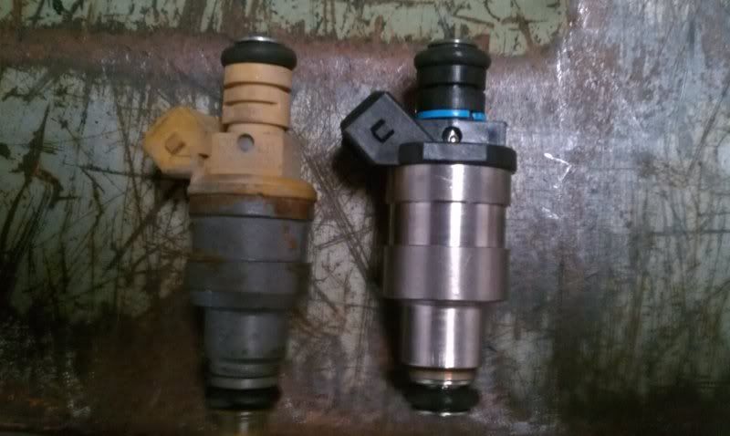

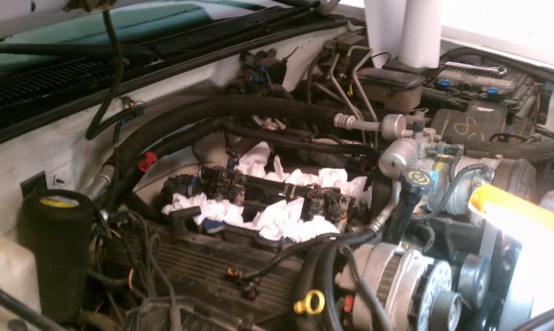

I went out tonight and started working on a few more things, I will be installing the new Injectors in the morning.
As well tonight I ran the codes, and I found out both of my O2 sensors are bad so the truck will not go into closed loop.
Between this and leaking injectors, I don't think it is hard to figure out why my fuel mileage has been sucking so bad.
Should feel like a completely different truck tomorrow afternoon. I am also going to go ahead and throw a new set of spark plugs in it.
The thing that has me concerned is I am getting a code P1870 which is saying there is a slip in the transmission, so I have a feeling it will be getting a new one pretty fast.
Not exactly thrilled about this. But it is a used truck with 150K on it, things like that are bound to be an issue.
Other than that I am going to need to get a new set of door lock motors all the way around, and I still have not found out what is keeping the dome light from working at the doors. It is frustrating because they were working when I bought the truck.

Just got the parts, fixing to tear into the tuck once it cools down, by the end of the day it will have new injectors, and O2 sensors. Picked up a fuel filter as well.
Going to go back in a bit and get spark plugs and the hose for the fuel filler vent.

Today was a day of frustration and triumph, it was a day that at moments had me furious, and at others ecstatic. Early this morning I dove into my truck and tore it apart. I yanked the plenum off, yanked the injectors out, then had a scare that they might have sent me the wrong ones.
In the picture above you can faintly see the puddle of fuel that literally leaked out of the old injector, those puppies were beyond toast. All of them were leaking.
Here you can see the new and the old injectors side by side.
I was worried they would not work, I called 50 motorsport where I bought them and was assured that they were the right ones. The metal clamps that held the injectors to the rail would not fit these new Lucas injectors, so I had to Omit them, but 50 told me this was standard practice and not an issue.
I was then able to get my truck put back together and while I as in there I replaced the fuel pressure regulator, which was toast because before when you would switch the key on the pump would not stop running, it functions as it should now. Before I lit it off however I wanted to swap out my O2 sensors, I bought a pair at the parts house this morning, got down there, pulled one of the old ones out, and sure enough they gave me the wrong parts.
The good news my shop is less than 1/8 mile from Advance, so I was easily able to walk over there. They had to go to another store to get me the sensors I needed, but they did it in about 45 minutes, I was pretty happy about that.
Finally I got the truck put back together and it runs great. It idles so smooth where as before it would surge, I just had one last thing to fix, and that is where my day got stupid.
Some knuckle head had the vent line for the fuel filler break, so they just taped it up, and left the hose barb at the filler neck uncapped. Thus what would happen when you put gas in is that you would fill about a gallon, the tank would build pressure, and shoot a couple of cups back on the ground.
With Gas being damn near 4 bucks a gallon again, I really did not want to go through this every time I needed fuel because I literally was dumping a gallon of gas on the ground every time I filled up. That gets expensive fast, and I can only assume I was losing more as the fuel sloshed going around a corner.
Thus I went to advance again, reached under the truck to pull the line, I was able to get the hose clamp off, but the hose would not budge. Laying on the ground I was able to reach up with my pocket knife and feel around, I started cutting on the old hose, then wham. Pressurized gasoline raining down on my head. I had managed to cut right through the main fuel line.
Luckily I was able to close my eye before the gas got in it. I went in the store, the guy at the counter helped me back to the bathroom, I washed my face off, went back out to the truck, started pulling the bolts off of the bed.
It took me about 20 minutes, I losened the bolts on the passenger side about 1/2 an inch, I removed all 4 on the drivers side. I then placed my floor jack on top of the duals, used a block of 2x4 to span the distance to the wheel well, then I jacked the bed up.
When I got it as high as I could before the block of wood hit too extreme of an angle, I turned around and used my receiver hitch as a spacer to set the bed on, readjusted the jack and jacked the bed the rest of the way up giving me access to the tank.
This was actually a rather effective trick. I have 3 hitches that I carry with me, I placed all 3 between the bed and the frame in case the jack let go, this gave me access to the tank.
Finally I was able to get the POS vent line hose off, and I got the fuel line patched.
My solution was to take a 4" long piece of 3/8" tubing, and 4 high pressure hose clamps, I put 2 on each side and sucked them down as tight as I could with out damaging the clamps. Turned the key on, no leaks, fired the truck up, no leaks, watched it for 10 minutes no leaks.
Broke everything down, put the bed back on, cleaned up leaving no mess behind, went to a good friends house, had a shower, ate pizza and watched some of game of thrones 2nd season.
