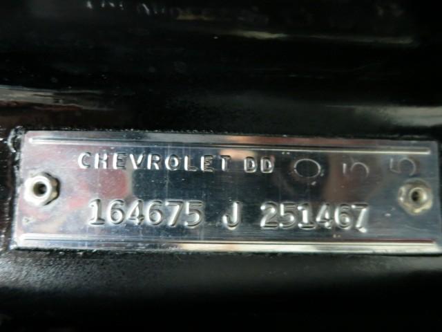

Quite a difference in appearance between the two VIN tags. Note the rosette rivits.

I think the VIN tag is correct. There are three inspector's stamps on it. The St. Louis plant did not stamp there, but rather on the cowl tag.
White interior is only available on the SS, as I remember.

If you compare the two VIN tags, the font is the clincher, the convertible with the fake L78 motor has distinctively different font than the recent black car.

Just an fyi, that L78 car was built at Doraville and should have different style font(s) on the vin tag for the actual vin number.
Now the cowl tag on the other hand, is completely wrong. lol

Greg are you saying the L78 396 motor is a 'fake' as in dressed to look authentic but is not? How do you know, as no block stamping numbers were indicated in the Ebay ad?
If it's just a run of mill big block dressed to look like an L78, the car is much less desirable, whether cloned or not.
Just to clear up any confusion, the VIN I posted above is from the black/red 409.
Here is the VIN from the black/white SS that started the thread:
As has been pointed out, there is a difference in the fonts and spacing but the obvious diffence is the rivets. Rosette rivets were original but NOS rosettes can still be found, and reproductions are being produced. That said, why would a restorer use an ordinary rivet to reattach a VIN and try to pass it as original? More to the story there.
Since the Impala VIN's were riveted to the door, how were VIN transfer's treated back in the day in a collision repair? What if one were transferred to the replacement door with ordinary rivets,....and then fast forward 40+ years. And of course, with a restoration, a door might be damaged beyond reasonable repair, necessitating a transfer of the VIN to a donor door. Nowadays, a door frame could be cut, grafted to the new door, and metal finished both sides, to preserve the original rivets, or it could be drilled and re-rivited using the correct rivets. As always, it's buyer beware, especially with the high dollar, low number, rare option cars to determine true authenticity.
