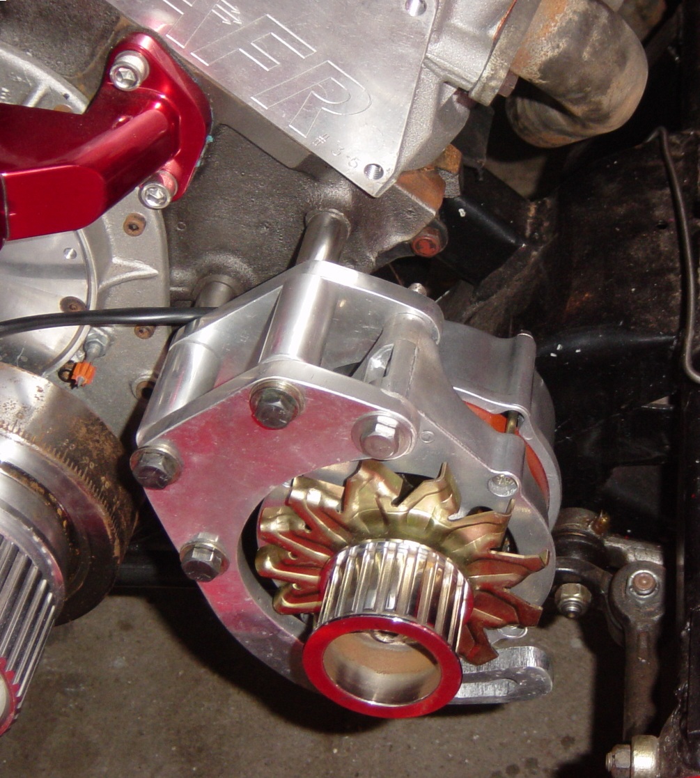

I am having trouble finding some alternator brackets to suit a Dart Big M block - I want to install the alternator down low on the drivers side of the block (our passengers side) what are you big block guys using ?

Blacky here's one I made with a jigsaw and used a rotary table on a small miller to cut the radius for the belt adjustment.You can make a template off the block with some cardboard and mark it out with a small ballpein hammer.Drill a hole for the alternator mount and bolt it on . You can scribe the arc for the belt adjustment then use the mounting hole in the centre of the rotary table to cut it out hope this helps.

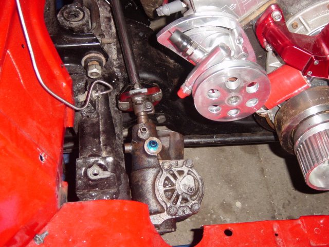

Yes it is a HZ clip it made it a lot easier for oil pan clearance and just bolt on the power steering. I did a similar thing on the other side for the power pump and used a remote oil tank.

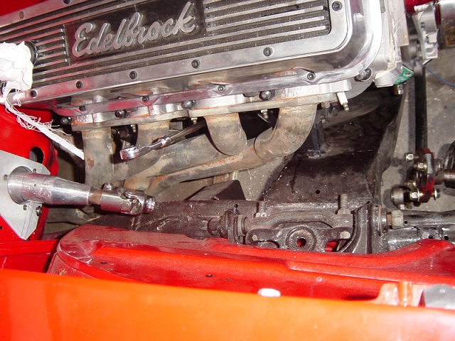

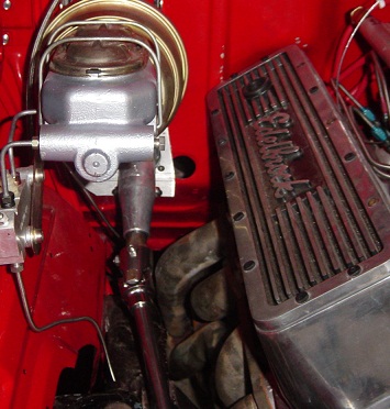

bigblock1957
Posts: 69
bigblock1957
Loc: Australia Queensland
Reg: 11-21-06
08-07-12 03:10 PM - Post#2256862
    In response to blacky
Used a Billet specialties column with a firewall mount from borgasen. I used DD to 3/4" universal also from borgasen and then 3/4" stainless shaft to the aftermarket neopreen flex joint.
Attachment: DSC00966__640x480_.jpg (97.75 KB) 10 View(s)
Attachment: DSC00953.JPG (152.32 KB) 9 View(s)
Attachment: DSC00967.JPG (64.68 KB) 9 View(s)
57 150 2 Door Sedan 505 BBC Turbo 400.
