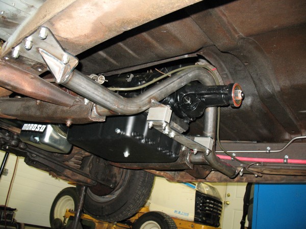

08-07-12 11:53 PM - Post#2256999
    In response to Zombie Dave
Attachment: progress_3.jpg (93.91 KB) 7 View(s)
  • Zombie Dave Said:
Just checked out Waltons. Very cool! You just answered how the tranny is to be supported. Seems simple enough and no welding needed there. Drill out the rivets, bolt in place.
Thank you!!!
I'll call Patrick tomorrow and see what else I can figure out.
Here's a picture of the Walton mount installed.

Bobg1951hevy ~ That Hydro sounds pretty cool. I gave Patrick's a call. I can't begin to tell you how impressed I am with him and his info. I at first was talking to someone else and the next thing I know another gentleman gets on the phone and introduces himself as Patrick and we begin talking about what I wanted to do and my options. He's like a lot of you guys and willingness to help. He had no dog in the fight on making money on me but was still more then willing to take the time and talk me through some options. Very nice guy and I'll open his catalog first when I need something and try and spend my money there first.
Heck of a guy.
DSactor~ I'm unsure about that exactly that is. I was wondering but thankfully I won't have to worry about it. I'll just get rid of it.
KeithKnox ~ I'll look into that harness. Was it a pretty simple install?
Bouncer~ That pic looks nice! Shows a lot of detail.

Each number goes together.
1) 235 that's in the car. Using (1) 53-54 power glide tranny and a (1) 53-54 power glide car rear end. ( Example )
I hope this makes it more clear.
1952 Chevy Styleline Deluxe Sport Coupe
1956-1962 235 Engine ( I think )
Looking for automatic transmission/steering column
Posts: 4905
Loc: Ellijay, GA
08-09-12 09:39 AM - Post#2257508
I see ... I think.
