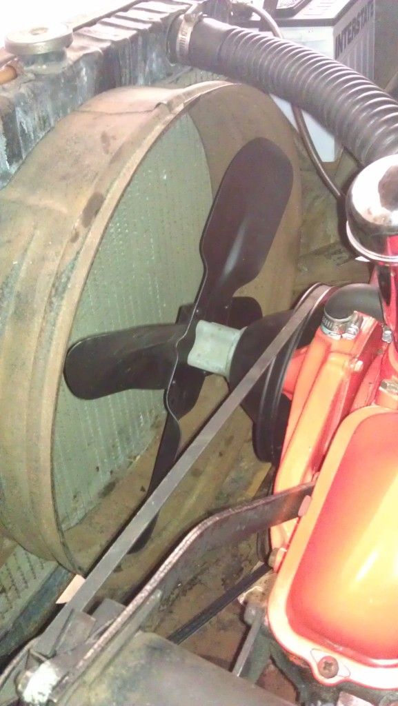

Im not sure what you ment on the fan but here is a pic.

Regarding the half in half out, yours looks OK from the pics- standing at the side if you look at the fan, the blades should be half inside the shroud, half outside.
