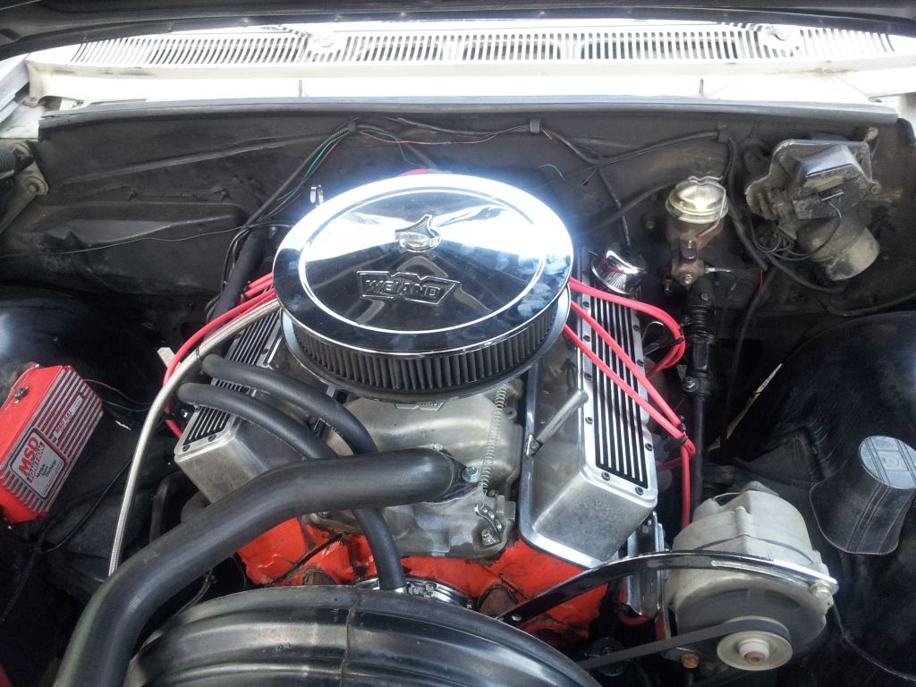

Ok ill try this again here's the link
This is the descriptions: Engine is a 350 ci. 4bolt main bored 40 over. Camel hump heads with guid plates and roller rockers. weiand intake. edlebrock carb. trw forged pistons 9.8 to 1 compression.fluid damper. new crank shaft and rods. shorty headers with dual 2.25 " pipes and flowmasters. MSD billet distributer with 6AL box and rev limiter. double roller timing chain.Impalla big block radiator. Transmission is a turbo 350 with B&M master racing overhaul kit. B&M 2800 converter. B&M quick silver shifter.

07-23-12 09:37 AM - Post#2251186
    In response to JonSalguero
Jon,
That engine appears to be sweating.
Can ya run out there and take a picture of RIGHT/Rear side of the engine from the top down.....with the air cleaner off? Right side means as viewed from the driver's seat.
I'm wondering if this guy even has a vent system of any kind.

07-23-12 10:18 AM - Post#2251198
    In response to Allan In NE
Yeah, I agree with Allan. It looks like the engine only has a breather, no suction side, which would explain occasional smoke out the breather. As I recall all 350 blocks did not have the cast in the block vent passage back by the distributer. When the 350 came out, they had switched to doing the vent/PCV system through the valve covers.
What you need is a hole in the other valve cover and a PCV valve and tube going to the carburetor (like my picture of the messy 350).
Old style block (as would be used in 64). Notice the extra hole next to the distributer hole (on the left side). The hole connects to the lifter valley. This extra hole is where the draft tube (in earlier years) would connect. By 64, there were the two vent systems, as in the diagram I posted earlier.
Later blocks the vent hole was filled in.
And then finally eliminated altogether, this is probably what your block looks like.

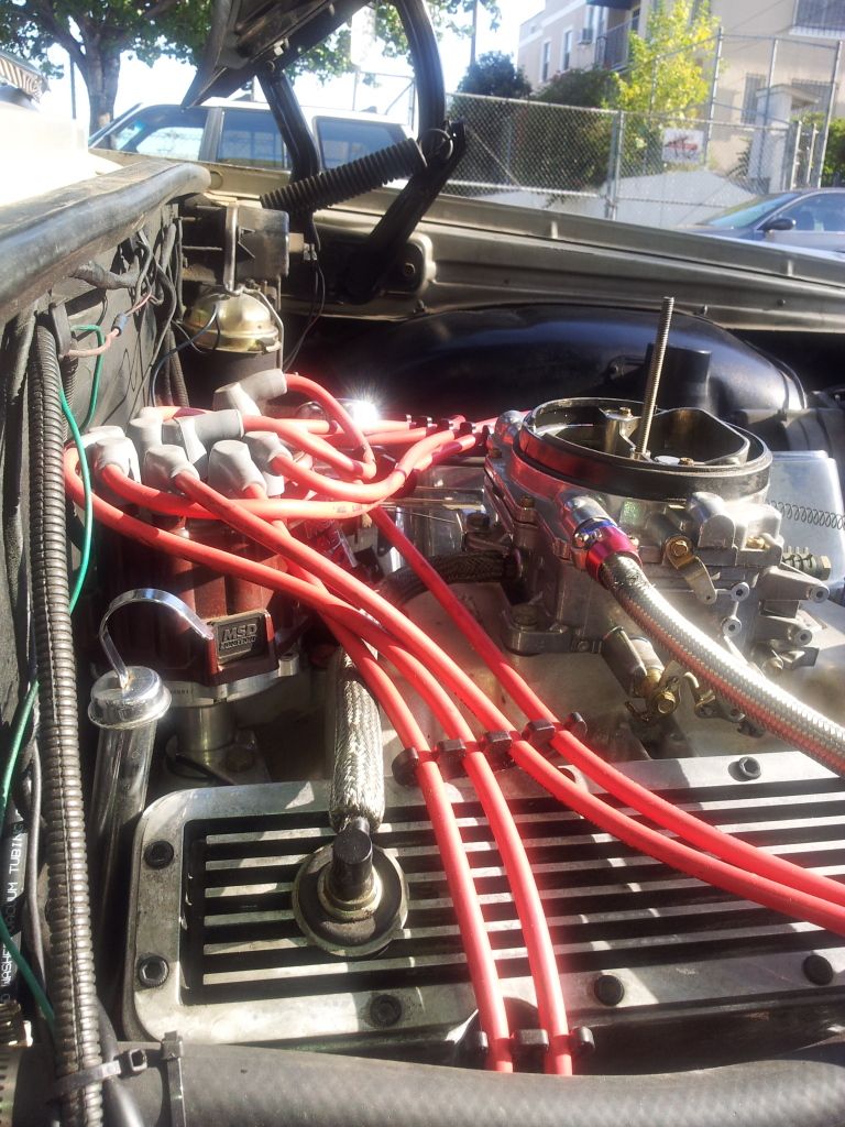

Ok so I just took some pixs of the left side of the carb where there is a pcv valve I think.
Looks like a hose is supposed to go here where I circled I am not sure

07-23-12 06:51 PM - Post#2251403
Well, that is good. You should check the PCV valve, hose and cab base to make sure they are not clogged. If those are good, then you must be getting excessive blow-by, which is not good.

07-23-12 07:06 PM - Post#2251414
Where you have it circled would go to your power break booster, you don't have one so its fine being plugged.

07-24-12 08:45 AM - Post#2251611
    In response to turbo38s10
That's the PCV alright. Much better pic. I'd replace it just to be safe.

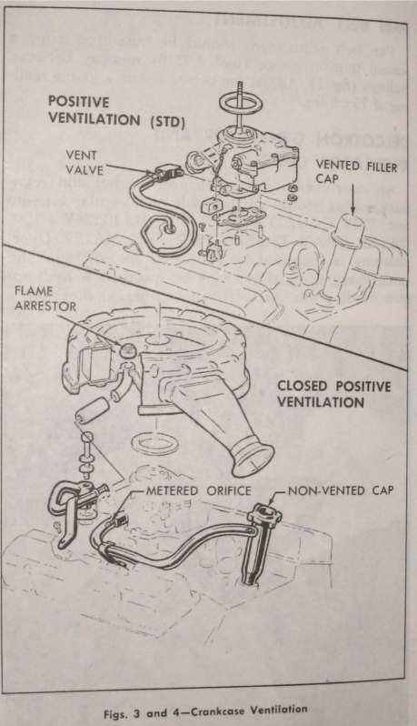

Perhaps you misunderstand what I mean by "draft tube". The term seems to be abused a bit. A draft tube is a tube extending from the opening in the block, down below the engine and is open to the atmosphere there. This was apparently used till '62 on Impalas.
A draft tube:
By '64 it should have been either the "Standard" or "Closed" vent system in the shop manual diagram I posted. Some folks still call the metal tube coming from the hole in the block in the diagram a "draft tube" although that is not very accurate.

07-24-12 11:14 AM - Post#2251666
    In response to dcairns
In the 1962 V-8 engines, the road draft tube was the standard production, and the closed crankcase ventilation system using a Positive Crankcase Ventilation Valve (PCV) was the upgrade option. I believe that it was just a few dollars more. I am looking for the small "bell" that replaces the draft tube, if anyone has a spare. I have all the rest of the parts to complete this changeover.. thanks Junk..

JS,
When using a PCV on a later sbc, like you have... as I understand it can be either an 'open' or 'closed' system. My understanding is if one of the valve covers has a breather on it (like you do) and the other v.c. has a pcv piped to a vacuum source, that is an 'open' system.
A 'closed' system is similiar except the v.c. that does not have the pcv in it, has a fitting and tubing which leads to the air cleaner housing where it gets filtered air. This is shown in the photo DCairns provided.
Also, based on the reading I've done (I'm willing to be wrong), to get maximum benefit from an open or closed system, the inlet on one valve cover should be at the opposite corner of the engine from the pcv in the other valve cover. In your photos, the PCV (passenger side) and the breather (drivers side) are both at the back of the engine. Most photos I see have the fresh air inlet at the back right vc (passenger side) and the pcv at the front left vc (driver side). May just take turning your driver side vc upside down, unless it has script that will appear upside down. Again, the photo of the engine without the aircleaner housing installed that DCairns had in his post, appears to me as typical in terms of the valve cover positions for the pcv, etc.
