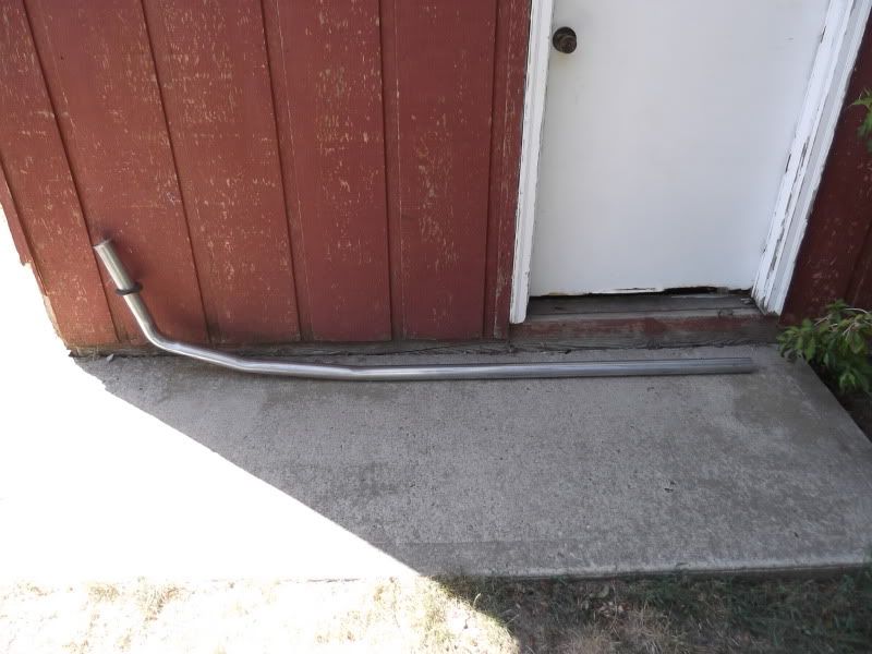

Got a little more time with the car this weekend. Got a 7' piece of exhaust pipe bent reasonably close and on the car. Unfortunately, one of the exhaust manifold flanges broke out on me. When I looked at the piece that came out, it was apparent one side had been broken a long time and the other side had been partially broken, I just finished it off.

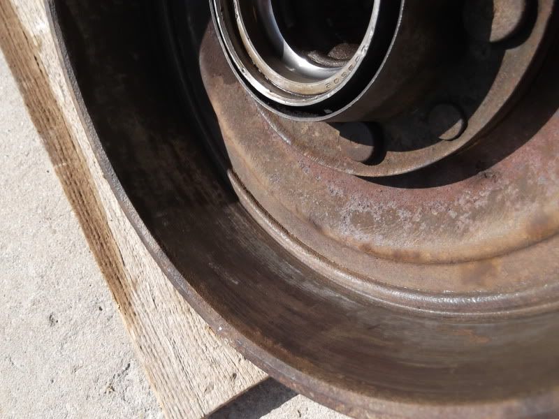

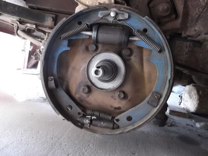

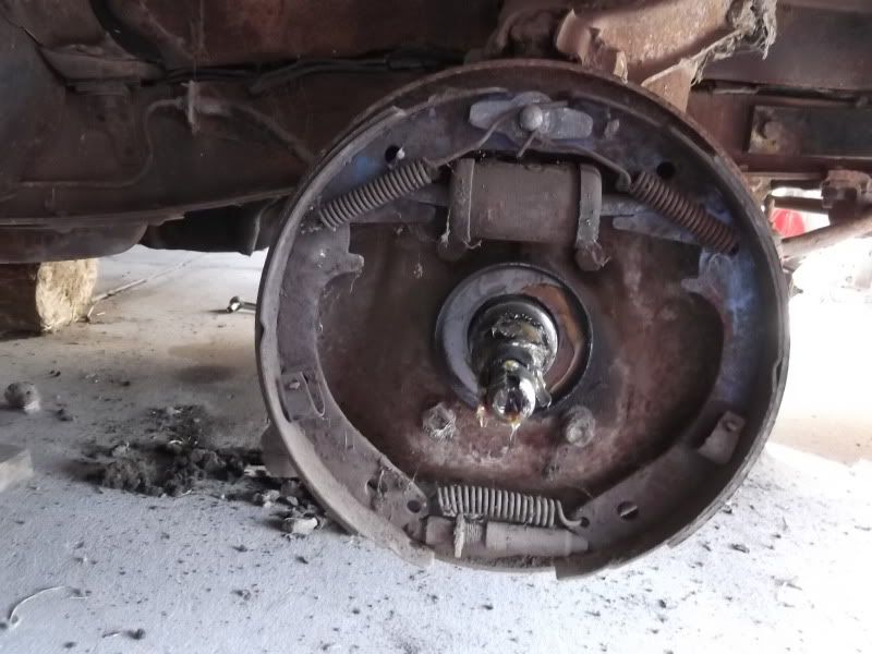

I also included the driver's side brakes, etc., after clean up photo and the passenger's side before photo. The last photo included shows where I took a small 80 grit drum sander on my drill and cleaned up the drums, worked nicely on the rough spots.
