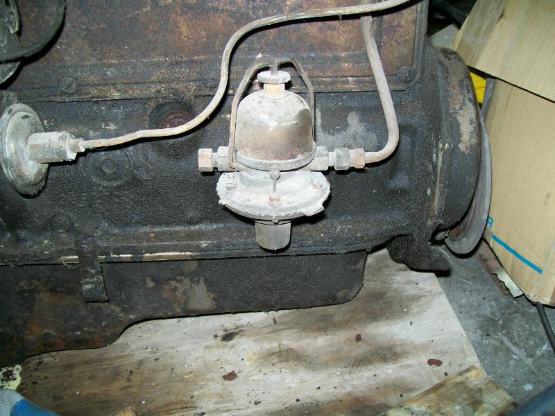

Not to throw fuel on the fire (pun intended), but the fuel pumps with a glass bowl and filter have the bowl on top, like this:
So, as you said, it can be either way. And I have no idea what would be "best."

I've got an old one from my 52' or more likely my parts 51', I will have to investigate. If there is a filter element top to bottom that the fuel has to move through, then the glass bowl is just a see-through filter housing and not acting as a sediment bowl. None of the old tractors (different I know) had more than a mesh screen filter at the top. Of course, most tractors operated with gravity fuel flow vs. a pump. I will look at the one I have and post back what I find.
