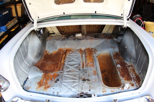

Was looking over at my Chebby and thought..."I'm gonna clean up some of that rust in the trunk today!"
Feeling cocky I strutted over to my new ride...popped the trunk and began pulling stuff out. Spare tire, complete with rust imprint up to the wheel-check. There goes the broken down and ripped trunk liner-whoosh. Ahh yess...I then survey my objective. Isn't too bad really. A little bit of surface rust here and there. All except for the wheel well. It's horrendous...but no holes. I can do this!
I begin looking around the garage. What to use here...hmmm. There's a belt sander. Still has the belt that came with it on it. Worked pretty good on that pine wood I was sanding. Let's try it! I got about 30 seconds into that train wreck and new that wasn't going to work. The trunk ate that thing like it was candy. I swiftly returned it to its place of rest...the now shredded belt barely holding on. Hmmm...I need a grinder. No grinders here. Hey I've got my Dremel! I can use that!
I ran over...pulled out the little case it was in and surveyed my assortments of loose tips to use. I use this on my reef tank...diamond blades work great cutting rocks and corals. But not a lot here for metal. Here's one! A 1/4" wide grinder bit! That'll work.
I plug it in, fire it up, and get grinding! Immediately I am engulfed in a red cloud of rust. I can TASTE rust now. "I bet a respirator would be handy at this very moment!" I think to myself. Shut the dremel off and again walk over to my sparsely filled tool chest. Ok...who am I kidding...its a cardboard box that happens to be in my garage. There's mnothing "chest" about it. I dig around and voila! One fresh new paper painters mask from Home Depot. BOOM...done. I grab the surprisinlgy thin rubber bands and begin pulling it over my head...SNAP! The bottom strap broke. Oh well...not to worry...CLEARLY that's why there's two! I pull it over my head again, this time I am careful not to break it. I pinch the flimsy little metal strip near the nose and get back to work.
Only...the short bit on this thing is so close to the Dremel...I can really only get the edge to actually touch. So now I'm basicly drawing lines in the rust. I soon start to simply scribble my way across the damaged areas. Not the most effective way to do this in the world. But stuff is flying...away...sort of. About an hour later I call myself done with the grinding. A friend recommended spraying a little WD40 on it to keep it from spreading. SO I did. Wiped off the excess and here it is...TAH DAH...my masterpiece!
What no applause? Yeah...after reconsidering...I wouldn't clap either. Pretty much a mess isnt it? Lol. So is my nose by the way. Just blew my nose and its like an auburn colored oil slick (sorry...bad visual). My wife is now looking at me and shaking her head disapprovingly.
"So honey, does this mean I get new tools?"

Sounds like quite an adventure. I don't think I would have tried either of those methods and I definitely wouldn't have sprayed WD on it. Best bet now would be to use a 3M wheel on it. It looks like a rubbery Scotchbright pad and you use it in an angle grinder (usually a pnuematic one, so bug the wife for a compressor ). They work great at removing rust. You may want to find something to clean up the WD as it may wreak havoc on whatever you use to paint the trunk floor later.

I agree with Wagonmaster, Take some Lac. thinner to it and let it dry out. 3m scotchbrite works wonders. I would recommend POR-15 on the trunk floor. You can brush it on and it'll look like you sprayed it. If your not familar with this stuff look it up online. Works great to stop rust. It's a little pricy but you could probably do your whole trunk floor with a half pint.

Hmmm...so nay on the WD huh? Okay...good to know. Where would I find those 3m pads? Does Home Cheapo carry em?
My wife said the first picture looked like the after photo.

So the thinner would be to work on the rust? Or remove the WD? (Smh)
That mechanic I was talking to recommended that as well. Is that something you have to order or is it carried by local chains somewhere?

The laquer thinner is to remove the w-d and dry out the pores of the metal. You may have to repeat this process a few times. Below is link from Eastwood products on the por products they offer, however you can buy it a tons of different places. It's good stuff for a quick fix and a PERMANENT coating on inner fenders ect. However the Por by itself is UV sensitive so you'll have to top coat it if it's exposed to light. BTW. wear gloves and make sure you clean it off yourself before it drys or you'll be wearing it for a week or two... no joke. This stuff is bad A$$
http://www.eastwood.com/rust-solutions/por-15 .html

I'd start by removing the loose rust with a sanding pad like one of these: http://solutions.3m.com/wps/portal/3M/en_US/3 MIndu... You can buy similar products in the paint departments of any hardware store. Of course flapper wheels and wire wheels will work too, where you have room for the drill.
I'd then use a chemical rust convertor. Once that's dry, I'd wash with dish soap and hot water, let dry, and apply primer and paint. I have used Rustoleum with good success on projects like yours. It holds up well even on formerly rusty suspension parts. Only drawback is it can take a day or more to completely dry.
I have also used PPG epoxy primer directly on rust (after removing the loose stuff). Did this on my pickup's bed >20 years ago, and it still looks pretty good.
POR 15 and Eastwood's Rust Encapsulator will also work, but they are not really paints, and they dry hard as a rock. And once you open the can, shelf life is next to nothing, so don't buy more than you need. For the POR15 you would skip the rust convertor step and use directly over the prepped rust. In fact, it's designed to adhere to rust.
Be sure to let us know what you end up doing and how it turns out.

What about this approach? Use a product called OSPHO which is a phosphoric acid base liquid( don't worry as you will find phosphoric acid in Coca Cola and other "soft" drinks).Treat the rusted area, let it sit overnight. The rust will turn gray. Sand the area and add more OSPHO until you'r sure the rust is gone. Then you can seal and paint. Works for me.

x2 with the Rustoleum - both primer and paint, as they don't require a perfect bare-metal surface to stick well. Just remove the surface rust, then spray the primer. You can topcoat with spray paint within the hour, then wait at least 24-hours for everything to dry hard. I use the INDUSTRIAL PRIMER first. For under 6-bucks a can, it just can't be beat!!!
I've used nothing but Rustoleum on my '57-235 car to repaint wheel-wells, front suspension, rear axle, frame areas, and the firewall. It holds up really, REALLY well.
You can use a wire wheel in a drill - but I don't like them. The wires snap off and spit back at me. I REALLY LIKE the abrasive NYLON 4" wheels made by WEILER - VORTEC. The nylon bristles don't break off and they wear very well. I haven't seen them at Lowe's or H-D, so try ACE or TRU-VALUE hardware stores. Worth the search!!!
PROTECT YOUR EYES - use safety glasses or safety goggles. Take the time to WORK SAFE. A trip to the ER takes the fun out of any project.
I have a DEWALT variable-speed drill with a 3/8" keyless chuck - LOVE IT!!! Take a look at Lowe's.

Here's another great rust encapsulator / neutralizer thats quick, easy to use, and does a great job. Should be available at most hardware stores (Lowes, HomeDepot, Ace, TrueValue, etc.) Ace sells a 10-1/2 oz spray can for under $6.00.
Spray it on wire-brushed rusty areas and the clear spray will turn black when it's done its job and is dry. I've used it a few time with excellent results.

I use the ospho as well, but mainly because I got 3 gallons of it at a surplus salvage store for cheap. It works well. Turns rust black when it's got enough coats.
(sounds like what that Loc-tite product does)
Works great for removing surface rust ( ie.stripped sheet metal that has sat for a while) by applying with steel wool or scrubbing with a fine wire brush. Use gloves and long sleeves. It will burn you if it splashes on your arm and especially if it gets under a ring, for example.

I've used both Ospho and POR15 with good results, I probably overdo it, but I like to get it as clean as I can before using the coatings. The Ospho converts the iron oxide to iron phosphate, which is relatively stable, at least that's what I've been told. Before I got an air compressor, I've used a wood handle wire brush, a vacuum cleaner (to suck up the crap with), and lots of elbow grease, then the ospho (rubber cloves, safety glasses, and a rag and carefully swab it on so I'm not leaving puddles of it around....)let it dry, brush off the white residue (there's always some it seems), and even wipe it down with clean water and a rag if it seems sticky in places, let it dry thoroughly, then the primer and finish coat of your choice. Rustoleum has always worked well for me.
I like the POR15, but if you need to rework the area later, man that stuff is miserable to get off, and you need to get it off if you are going to do any welding or other heat work. I did some '55 stock rims with it once and they came out quite nice, and still look good 10 years later. I did topcoat them with a gloss black to prevent the UV effects. Our local paint store sells it, I buy the smallest cans, it costs more that way, but then I don't have leftovers turning hard almost immediately and having to throw it away....
The trunk in my '55 hardtop is worse then you pix and I will be doing it with Ospho, after welding up a couple of holes.....
