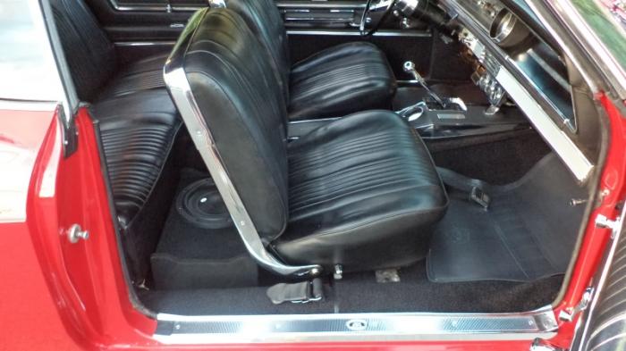

Attachment: __65_Interior_1_sm.jpg (163.8 KB) 21 View(s)
Attachment: __65_Interior_2_sm.jpg (164.59 KB) 20 View(s)
Attachment: __65_Interior_3_sm.jpg (178.24 KB) 16 View(s)
Attachment: __65_Trunk_1.JPG (153.75 KB) 16 View(s)
Attachment: __65_Trunk_2.JPG (168.64 KB) 16 View(s)

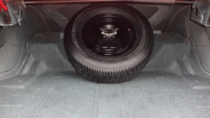

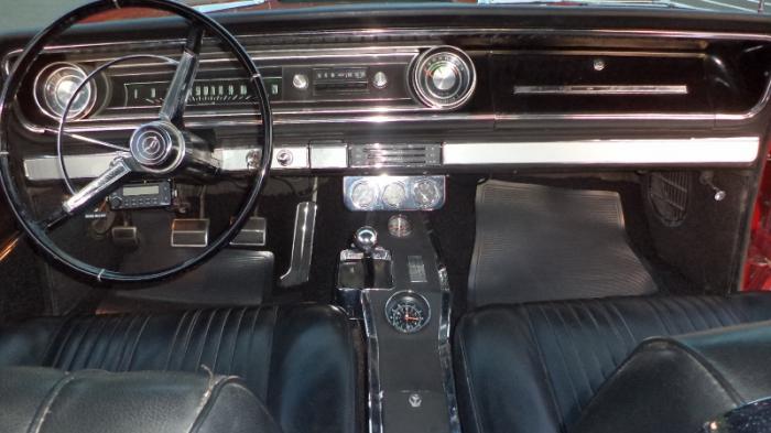

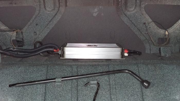

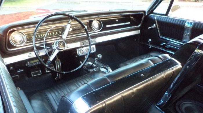

Donnie,
Part of the restoration on my '65 involved some music. I'm sorry, but am radio played through a small paper speaker wasn't going to cut it, even though the trips in my car are barely long enough to listen to a few songs. Having the L78 425 hp 396 with moderately quiet Magnaflow mufflers makes my car kinda loud, but the stereo system I put in in will [barely] drown everything out.
Here's a description of the pictures, even though they're kinda self-descriptive: 1) A side-shot of the front interior 2) A head-on shot of the same front interior If you look just to the right of the parking brake handle, you'll see the "Head Unit" for my stereo (I'll list all the stereo equipment at the end) 3) There's a side-shot of my interior, so you can see the low-profile subwoofers 4) Obviously my spare tire... that one should be a no-brainer 5) There's the amp that's hiding behind my spare tire 6) That's where the 'door' to the kick-panel vent should be, which happens to be a Great spot for the front speakers.
When I laid-out where the stereo components would be located, I wanted to make sure that it was going to be difficult, if not impossible to tell that there was an aftermarket stereo system in the car. I found a speaker online that fits in the stock location in the dash, and that one speaker was actually two speakers, in one housing, but I wasn't too sure on how good that would sound. So, I removed the doors in the kick-panel vents, made a mounting plate from 3/8" plywood, mounted a 5 1/4" 2-way speaker to the plywood, and mounted the plywood to the stock holes for the vent doors.
Equipmet: Secret Audio Remote Stereo System... This is the head unit. It has a small display unit that you can see in the pictures of my interior, and the bulk of the unit [in my car] is mounted under the left rear arm rest. I have the cable for my ipod routed under the carpet & up into the console. The heart of my system is a Memphis 5.570 5-channel amp [the 5th channel is for the subs]. In the rear-speaker mount, you know... the silver grill that's mounted in the back of the rear seat, has an Alpine SPE 6000, 5 1/2" 2-way speaker mounted to it. The speakers mounted in the front kick-panel vents are Memphis 15-MCS5, 5 1/4" 2-ways. And... The subwoofers are two Memphis 15-MR10D4 low-profile subs in these really cool Pioneer low-profile sealed boxes.
That's probably more than you asked for, but at least now you know the sizes of what will fit where, if you chose to go the same route. I'm really happy with the way things turned out... my system sounds great, and, except for the subs on the floor in the backseat & the small head unit by the parking brake handle, things look stock. I even bought an antenna cable 'Y' so that I could tap into the antenna for my Secret Stereo, and leave the stock radio hooked up (it turns on & plays through the stock speaker in the dash).

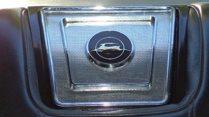

07-15-12 07:06 PM - Post#2248543
    In response to SS_in_Seattle
Attachment: __65_Secret_Speaker.JPG (198.82 KB) 15 View(s)
One Last Piture...
1965 Impala SS L78
1966 Impala SS Convertible

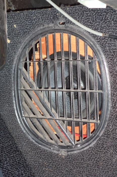

I installed 5-1/2" speakers in my kick panels simular to you. I gutted the vent door assembly and sealed off the back by glueing a sheet of thick flat plastic. After reading some speaker buffs suggestions I then filled the cavity with pillow stuffing. After making the speaker mount to the face of the damper I fitted/glued sheet plastic to covere the remaining open area. I routed the speaker wire through the hole previously used by the damper shaft. So that the speaker could not be seen I covered/glued thin black cloth to the backside of the kick panel opening. To complement the kick panel speakers I installed a duel cone Retro-Sound speaker arrangement in the dash. A Retro-Sound unit powers these speakers while an Alpine amp powers a couple of JBL 6x9's in the back. I was amazed at the sound clarity and balance of the arrangement.

I agree with ya, I'm really surprised at how well the stereo in a '65 Impala can sound. One of the nice things about the Secret Stereo, is the ability to manipulate all of the speakers. Since the rear speaker in my car is higher & pointing right at the back of your head, I adjusted the fader down, and now all of the speakers sound like they're at the same volume.
I like the description of how you have your speakers mounted, That's definately something I'm going to copy, uh... reverse engineer this winter
