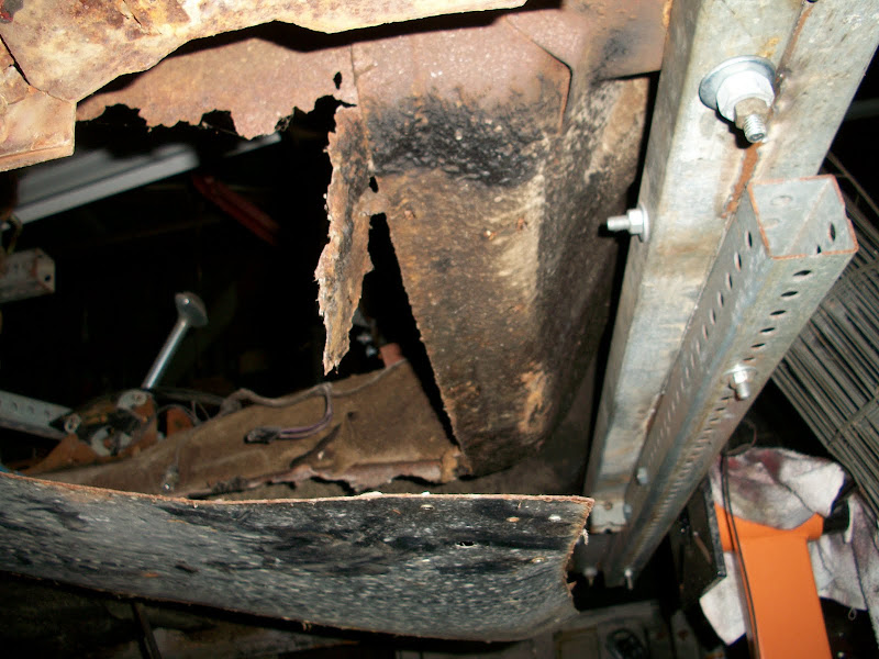

I would recommend looking around for street signs knocked over with the square strut.
Collect about 10 of them. Measure the front mounting points on the frame or get them from the assembly manual. you will double them up to get a mounting point for the front of the body. Depending on your garage, you could tie these into the structure of the garage or make a saw horse style setup. with the legs outside the car and then bolt the strut to the top of the horse.
As for the rear, I would recommend the same strut across the car at some body mounting points rear of the wheel well. I am assuming you have a hard top, otherwise you would be best suited to remove the doors and brack the whole frame.
Doubling or tripling the strut together with a mig weld should pretty much eliminate the flexing of the metal. It did in my case.
from what you are telling us, a rotisserie is out of the question. no way to roll the frame under a rotisserie.
I was going to rotisserie until I chose to replace complete floor pans.
front mounting point....
rear point (in the background). horse is orange.
or this...
