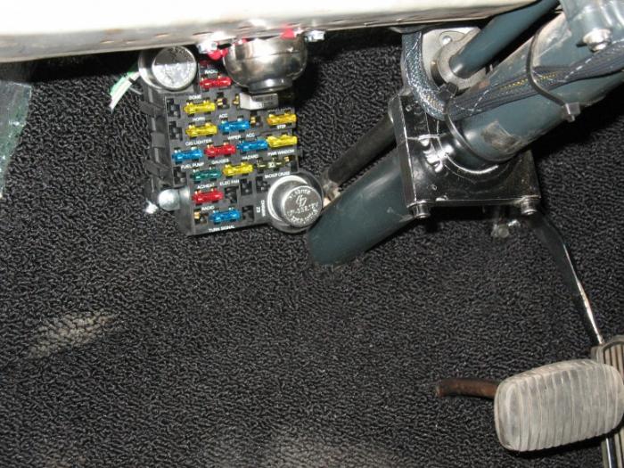

Just curious as to where you guys mounted your fuse panels. any chance for pics?

Attachment: fuse_pannel.jpg (196.3 KB) 14 View(s)
[quote=Sir X Loin]Just curious as to where you guys mounted your fuse panels. any chance for pics?[/quote]
