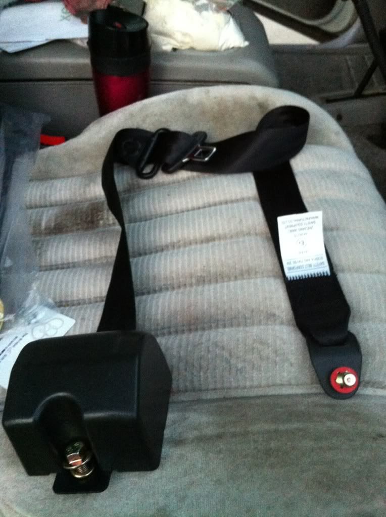

Also, the female end of my seatbelt on the passenger side was busted. I ordered a universal kit from JC Witney and went to install it today... It's a three bolt system that looks like this:
Not sure if anyone has had any success with these. Doesn't seem like a plug and play fix with the bolt configuration that exist. The good news is that the plug from the kit works with the stock belt. Only thing is that the kit was $100 and I would like to get the whole thing replaced, if possible.
