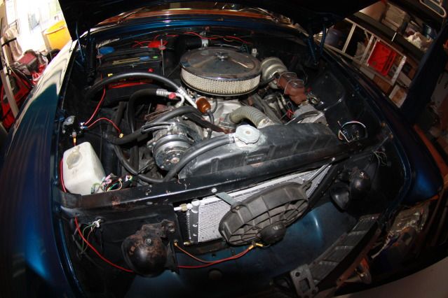

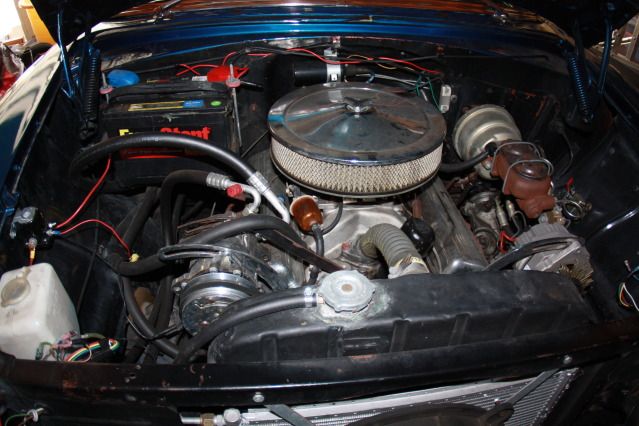

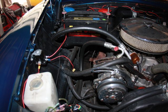

Here's some pictures...although what your describing probably cant be seen in these...

    In response to iRiE
Forgot to mention that early 283 heads ('57, '58, and...'59?) had the staggered bolt valve covers. Later 283 heads had the straight across valve cover bolts.

I'm pretty sure the valve cover bolts are right across from each other top to bottom. But I'll have to double check.

If your oil fill tube is operational and you have a working road draft tube, then I don't think you have a 350 crate motor. My guess is you have either a...
265 (no side motor mounts)
early 283 (no side motor mounts)
later 283 (side motor mounts)
327
possible, but chances are slim you have the one year only ('68?) 350 with roaddraft tube.
