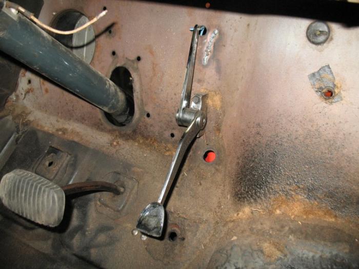

07-05-12 05:18 AM - Post#2244651
    In response to Zombie Dave
Attachment: php0Iy3DOAM.jpg (135.67 KB) 10 View(s)
This is how I installed my gas peddle.

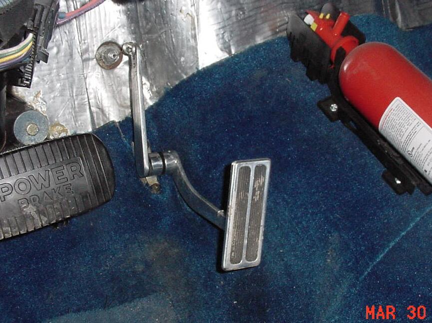

07-05-12 06:59 AM - Post#2244674
    In response to 50hotrod
I too used the Locar pedal.
Attachment: Pedal2.jpg (95.3 KB) 8 View(s)

Think you would have to use your ankle to push it down without moving your whole body down on it. Don't know how you could just push with your leg. Not saying that you can't but.... Like I said, it is a Lokar pedal asssembly with cable that goes to the carb. Hope you can make it work!!! Can you get one like in the picture and modify it to work for you?
Posts: 5742
07-06-12 04:42 AM - Post#2244993
    In response to Bob_Hayden
DUH!!! Forgot about your knees! Does your knee bend? If so then I bet this one would work.
