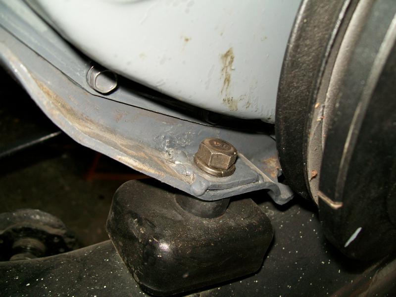

Here are photos of the tops of mine. I would guess that they are a high strength steel of some sort.
Attachment: 1951_Motor_Mount_Bolts_001_resized.jpg (67.73 KB) 16 View(s)
Attachment: 1951_Motor_Mount_Bolts_002_resized.jpg (56.06 KB) 9 View(s)

Thanks for posting the photos. Those are the bolts I'm looking for. BTW - if those are stainless, they are grade 5.
