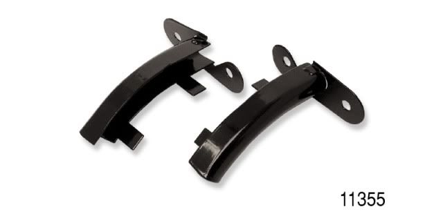

These sheet metal OEM type door wire protecters I link to here came to my attention in another thread.
http://www.classicchevy.com/chevy-power-window-do o...
Of course the supplier states they are the best. I am wondering if any of you have them & what you think is the best. This is for my daily driver so functional means more than appearance to me. I'm gonna move up to power windows soon & would like to get it right the first time.
Thanks, Doug

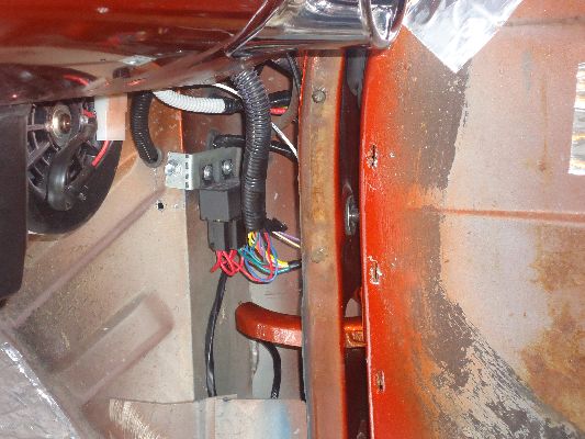

Attachment: 001_small.jpg (48.08 KB) 37 View(s)
I went with the original style wire looms.They were not to bad to install with out removing the doors.

Farrel - your pic is a million words - could you elaborate on what style drill or saw you used? I'm guessing a rt. angle drill. I was already decided for that style wire protector & was resigned to pulling the doors to do it. Is that a relay that your wires are plugged into?

The relays are fot the vintage air and I did use a right angle drill with a short bitt on the door. There are several posts with the measurements for the hole sizes and location.If you can't find them I'll look it up for you.

Ralph Roberts
[url]http://56chevy.com/cgi-bin/find.pl[/url]
Part Number
11355
The factory has the dimple already made into the pillar.
Mine were installed without removing door.

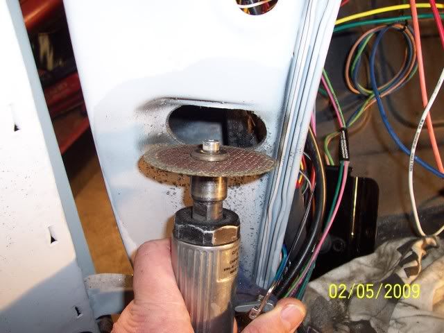

Great drilling diagrams - Thanks. I assume you also ran a rt. angle drill back thru the cowl side & into the door? I have the cowl side insets & dimples in pretty good shape. But, the doors are another story. I also have a rt. angle drill - one old monster made for wall stud elect. & plumbing hole drilling. Maybe time to get a Makita 3/8" one.

No right handed drill necessary.
Drill the holes in the door by putting drill in kick panel area after drilling pillar.
Drill bit goes through hole made in pillar.
