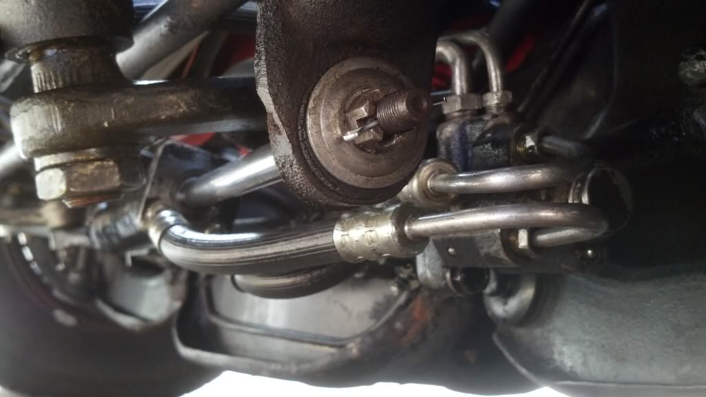

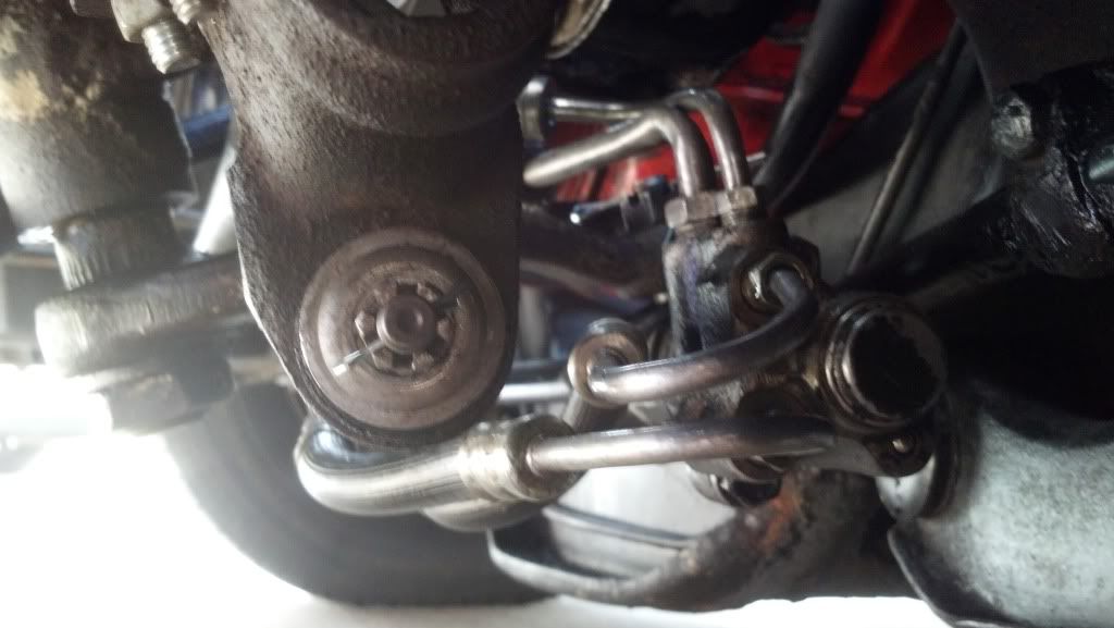

ok got some better pics and video. the video is still uploading. i almost want to say that its not doing it as bad as yesterday. the install is 32hrs old now. unfortunately as soon as i was about to say its not doing it anymore, it started doing it. here are some pictures of the plumbing.
i will upload the video as it finishes....keep in mind it only acts like this when the tires/front end are on the ground. when the front end is up on jacks it turns smooth no funny business.

one of the causes of the loud vibration i found is the passenger side wheel well is missing a bolt or 2, the previous owner removed the front clip to paint i guess he lost a couple bolts. but that still doesnt explain the tire/front end shaking the way it does....i thought it could be the power steering pump putting a load on the 283 and cause it to idle rough, but after having someone else turn the wheel and i watch, clearly its not that and theres something going on with this system.
please excuse the grease and grime, this car does get highway miles put on it.

Thanks for the pix lone star. Looks like the valve to cyl lines are plumbed right.
I still think it's probably air in the system.
