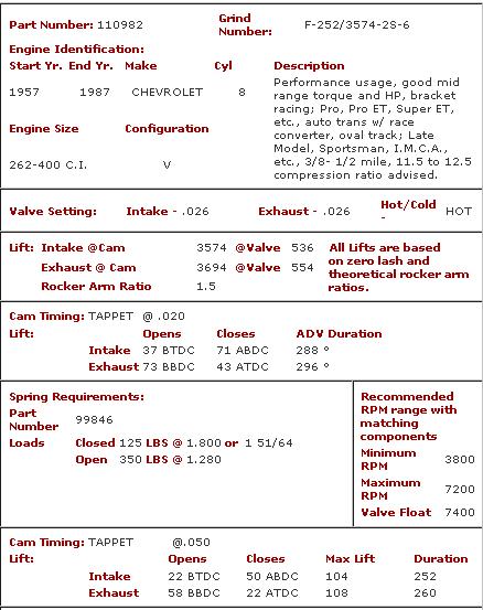

Ive had friends use it and in every case swapping too one of the similar crane cams listed below resulted in better performance,because once you expect to exceed 6400rpm your in solid lifter territory, use a hydraulic and your working at a disadvantage, you can,t throw a cam like that in a lower compression engine with a 2.57:1-3.07:1 rear gear and a stock stall speed converter without killing the power curve, on a basically stock engine.
XE294H
Rpm Range 2800 to 7000
Dur @ .050
Intake 250 Exhaust 256
Valve Lift
Intake 0.519 Exhaust 0.523
Hydraulic lifter
