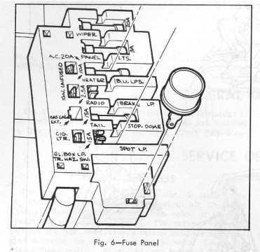

What amp fuses are supposed to be in the fusebox of a 66 chevy truck. All of mine are different and I'm not sure what the factory calls for.

Attachment: 8317713.jpg (40.75 KB) 19 View(s)
