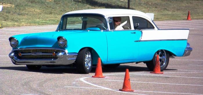

elkhornranger
Posts: 289
elkhornranger
Loc: Northern Colorado
Reg: 04-11-06
06-12-12 11:21 AM - Post#2236227
    In response to bowtiefan
Attachment: cutting_cones_ct.jpg (106.93 KB) 14 View(s)
I went out the first time in the same street trim i built just to get by in Denver rush hour traffic. I have what turned out to be decent setup for a good mix of street and still have fun doing this. I had lots of people come up and ask about the set up since I was doing so well against the camaros, vettes and mustangs. I have cpp dropped spindles, tube a arms, 500 steering box, QA1 coil overs and a helwig sway bar up front. In the back I have posies dropped springs, eldebrock shocks and helwig sway bar and 1 1/2 lowering blocks with spring pockets. Bowtiefan is right, too much power will get you in trouble if you cant keep good contact with the tires. My problem was no disipline and couldnt stay off the gas. I did have a few good passes where I stayed off the gas a little. It is addicting for sure.
This pic is the most lean it had.
