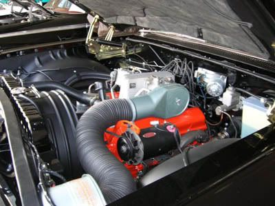

This is the best picture I have of what the air cleaner setup would look like on a 58. The adapter attaches to the FI air intake, then a flex hose leads over to the air cleaner on the radiator support. Just these pieces alone would be worth a small fortune!!!

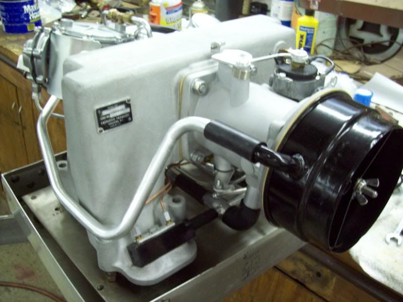

Finned top (57-59 units), this is a 4800 unit
Smooth top (60-62, ONLY used on Vettes)

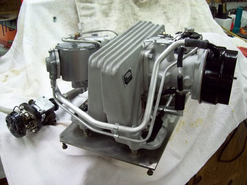

Here are some that maybe you have never seen.
This is a Corvette SR2 which now has a hard core all alum 350 engine and an FI unit (below) that I built.

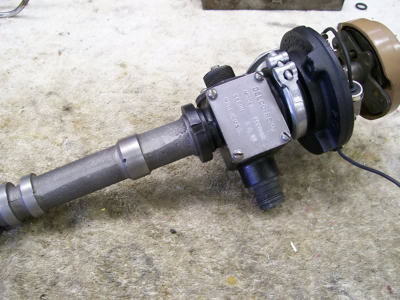

NO it is not.
CORVETTES were the ONLY cars to get a tach drive dist. A tach drive dist has a fitting on one side that faces the firewall. That fitting is EXACTLY the same size as as the speedo cable fitting on the tail housing of a transmission.
An FI dist has a SIMILAR fitting (as seen above) on the front side of the dist which is LARGER than a speedo/tach drive fitting. SOME, but not all, FI distributors have BOTH a fitting for the FI cable AND a tach drive cable.
Below is an FI dist that also has a tach drive (both sides).
Also, something that I haven't mentioned. ALLLLLLLLLLLLLLL FI distributors have their own oil feed line. It is an oil line that comes off of the threaded hole in the top rear of the block where the oil pressure fitting screws into. FI engines have a T-fitting at that location, one end of the T is for the oil line to the dist and the other is for the oil pressure sending unit.
You can see the T in this picture.
Tom Parsons

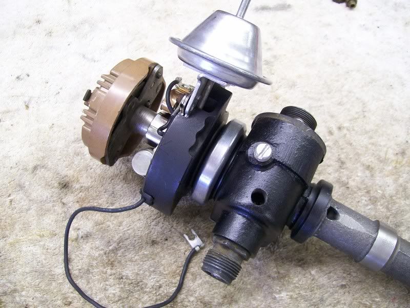

Last, because of the high load that occurs on the gears inside the dist for the shaft, it MUST have a very direct oil supply.
Here is a disassembled FI dist that also drives a tach (notice the double ended shaft which has the gear in the middle). I don't know why, but the gear that mates with the cross shaft gear is not in the picture. The gear that is not in the picture goes on the main shaft and looks nearly identical to the gear on the cross shaft. An FI dist that does not have a tach drive has a shorter cross shaft.

The picture of the "parking meter" adaptor on the air meter is a 59. The 58 used the air cleaner that attached directly to the air meter as would a 57, although the 58-59 air cleaner had the balance tube nipple centered in the air cleaner body whereas the 57 has the balance tube nipple near the top edge of the air cleaner body. The reason for the "parking meter" adaptor was that the 59 had a much lower hood clearance, causing all the 59 air cleaners to be lower, using paper elements for the carburetors instead of oil bath air cleaners. The 57 FI air cleaners( passenger and Corvette) were the first Chevies to use paper air cleaner elements.
