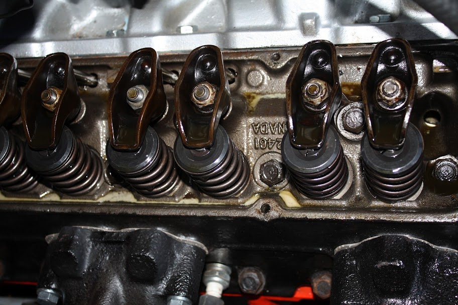

Okay- so- this is a "fresh" motor, built over the winter freshly 'broken in'. 350 Chevy, Edelbrock C4B intake, camel hump heads (461s). Mild cam. I'm using those finned corvette valve covers. Not running a PCV valve yet.
Was running it today, and the rad overflowed for a moment. I had just filled it- probably overfilled it, actually). Temperatures were around 210 when it flowed over, but it was only for a second before it dropped down again to around 180ish, maybe 190.
Oil pressure stayed up around 40-60lbs the whole time.
I did notice that I had a film/drip of oil coming from the oil cap, so I know I need to work out a PCV solution to keep the thing clean.
After the baby was asleep, and before the sun set completely, I went out and checked the oil. (I was planning on changing it). The dipstick looked clean. But then I popped off the oil cap/breather and...
Woah. That can't be good. Started to drain the oil from the pan, and it looks okay to me. I dipped a plastic cup into the pan to check it- it's oil... not at all milky. This is from the 'end of the pan' - meaning, after the oil had drained out...
Yanked off the valve covers... and more milk.
Ok, so I'm admittedly a "little" lost now. I'm definately learning as I go, so I'm looking for guideance and knowledge.
  • Is it possible that this is merely the result of condensation? It's obviously not a lot of water.
  • While setting up I had a leaky water temperature sender- could water have seeped in that way?
  • Could it have been sucked in by the breather/cap on the C4B when the rad bubbled over? (I think this is a stretch)
  • Could this be seeping up the head bolts? (I'm sure I used sealant, but I'm open to anything).
Please share your thoughts, comments. As I said, I'm learning as I go...

sealer on the head bolts. get a rad pressure checker and pump up the water pressure and look for bubbles around the head bolts

Well, I changed the oil and fliter, and re-ran the motor, just bringing it up to temperature. (Hottest it got today was 200, it settled back down to around 170). And it was damn hot out when I did it...
Compression is acceptable, but low (in the 130s, with a 10% variance from low to high).
Popped off the driver's side valve cover and I've got more milk. Looks like I've got a head gasket replacement in my future.
Anyway, this is a good opportunity to drill/baffle the C4B intake for a pcv, anyway.
I'll play around with it tonight after the sun sets, but it looks like I didn't install the head gaskets correctly (?) because they're new felpro gaskets.
Also, I'm sure I dabbed sealer on the head bolt threads, but I might pull them one by one (in order) and check.
I'll also pull the intake - if water is seeping past the intake gasket, is there a tell? What should I look for?

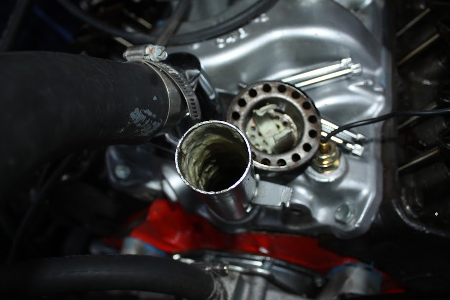

Just thought I'd jump back in with an update- I figured I'd start "from the top" - and I'm pretty sure it was the intake gaskets / intake that was leaking water.
I pulled the intake, cleaned the crud off, and replaced the gaskets. This time I used sealer around the water ports on the intake (just to be safe).
While I had the intake off, I drilled the back of the intake and put in a PCV in a baffled grommet, which, surprisingly I found at my local Canadian Tire (which is sort of like Walmart, but with an only slightly better auto section).
I put it all back together last night, but it was way too late to start the motor- and I was tired so I wanted to get a good-nights sleep before kicking the motor over again.
Reset the timing and idle (now with the PCV). Good vacuum @ 13-14
Ran it up to operating temperature and revved it up a little (2.5k rpm or so). Oil pressure stayed good, temp creeped slightly over 200, but hovered around 175 at idle.
No more water.
I repeated it again this evening and we're all good.
