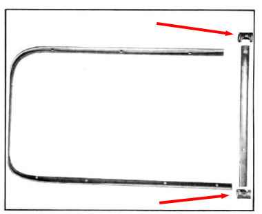

These are what I need to know about. I have one of them.
Attachment: Screen_Shot_2012-05-24_at_8.31.16_AM.jpg (39.39 KB) 17 View(s)

Thanks Bob, do you know if they are the same top and bottom? I have one but don't know which one it is if they are different.

Bill,
Looking at my parts car (51'), they are not the same. The top one has a curve or bend in it to overlap the center, the bottom one is pretty well flat.

Bill,
The upper escutcheon fits 49-51, part #4593048.
The lower escutcheon fits 51 only, part # 4593046.

OK, so they are different. Now how do I tell which one I have? ARe there any clues as to how to tell them apart since the moldings are not on the car at this time and the windshield is out?

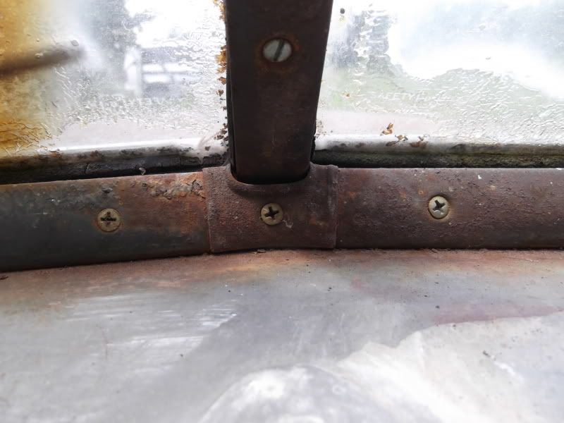

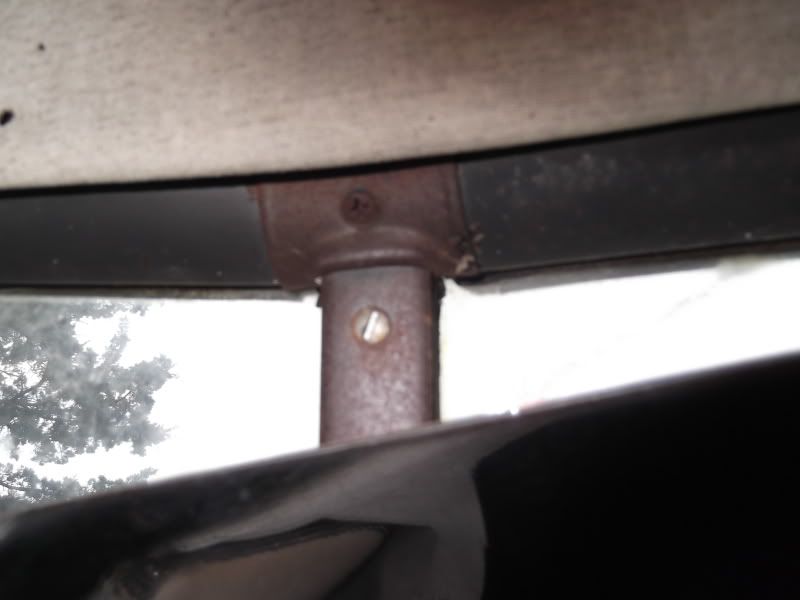

Here you go Bill,
"TOP"
"BOTTOM"
"TOP ON RIGHT"
If you can wait until the 8th, I can bring it out when I pick up the rear end.

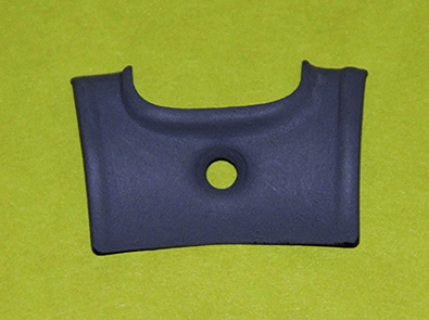

Chris,
I can wait.
It looks to me from your pictures that I have the bottom one.
Attachment: clip.jpg (53.19 KB) 15 View(s)

I know part numbers are different, but I don't see any difference in the pics, do you ?
Take that all back, now I see.

Maybe it's my eyes, but the top one looks like it has more of ridge in the "U" than the bottom one. It could just be the way the picture is too.
Bill Gommel
Posts: 4897
Loc: Ellijay, GA
05-26-12 07:01 PM - Post#2230177
    In response to usmile4
Yes, I agree.

Hey guys,
The bottom one is virtually straight, it just fits around the middle piece. The top one is contoured or bent to match the center piece. It's easiest to see the difference if you look at the photos where they are still in place.
