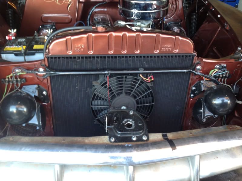

Hey fellas, so I spent crazy dough getting stuff chromed out in the engine bay and one of the nicest thing in my opinion was the rad fan. But a couple weeks ago while I was shifting my engine shifted a lil forward and it hit the radiator and at 450 to recore the darn thing it can get pricey so I decided to ditch the mechanical and go electric, the one I put on was too small and over heats when idling for a while. So my question is what size will work and is it better to have it pushing or pulling. I'll try to post sum pics up soon. Thanks guys.

Not remembering what set up you have, I have a 350 with a Superior aluminum radiator. I am useing a 16 inch puller. I used a puller because I didn't want anything in front to block off the radiatopr any more than the AC unit does. I think my fan is 1600 RPM's.

A stock motor/fan/radiator should NOT be shifting around causing damage. I would take a serious look at your motor mounts/trans mounts and radiator support. Find out why things are moving and fix it.

I know a lot of folks that have used the stock radiator to cool a mild small block V8. That leads me to think that it takes about the same airflow to cool the stock six. Most 'sperts seem to recommend 2,000 rpm and up. I used a flex a lite black magic with about 2,200 rpm and around 3,000 CFM of air flow. The link below gives some info about fans from flex a lite that might help even if you use somebody else's fan. A shroud makes a ton of difference.

Here are a few basics for using electric fans to cool your engine.
Pusher fans are about 20% less effective that puller fans.
Without a shroud the only portion of your radiator that is cooling is the surface area of the fan.
Most manufacturers other than Spal over rate their CFM's
The average small block needs 2700 CFM with a shroud, average big block needs 3500 CFM with a shroud, for high HP add more CFM's
Finally can't over stress the need for a shroud, as it spreads the airflow over the entire radiator, using the entire surface rather than the area of the fan.
