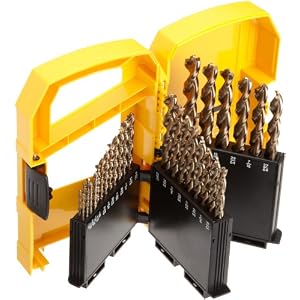

These seem to be popular:
DEWALT DW1969 29 Piece Pilot Point Twist Drill Bit Assortment with Metal Index

"The Point" are exactly the ones I'm talking about that are difficult to sharpen, at least traditional style on a grinder. Dunno if the Drill Doctor thing can do them or not.

I don't think you can sharpen those with a drill doctor or simple home shop means. If you do, they will become a "normal" drill bit.
If you feel the need for those, and I find them handy in the small sizes for sheet metal, just buy replacements individually. For myself, they are only useful in the the 1/8" and 3/16" sizes, the rest are unnecessary. Use the 1/8" or 3/16" for pilot holes, and a plain drill bit or a step bit to get the size you need.
Drilling with a small bit to start and then progressively bigger is a smart thing to do anyway.

Those are also good if you need a flat bottomed hole.
For what, I don't know, woodworking, I guess.
Those points are easy to snap off in metal, if you're not careful.
