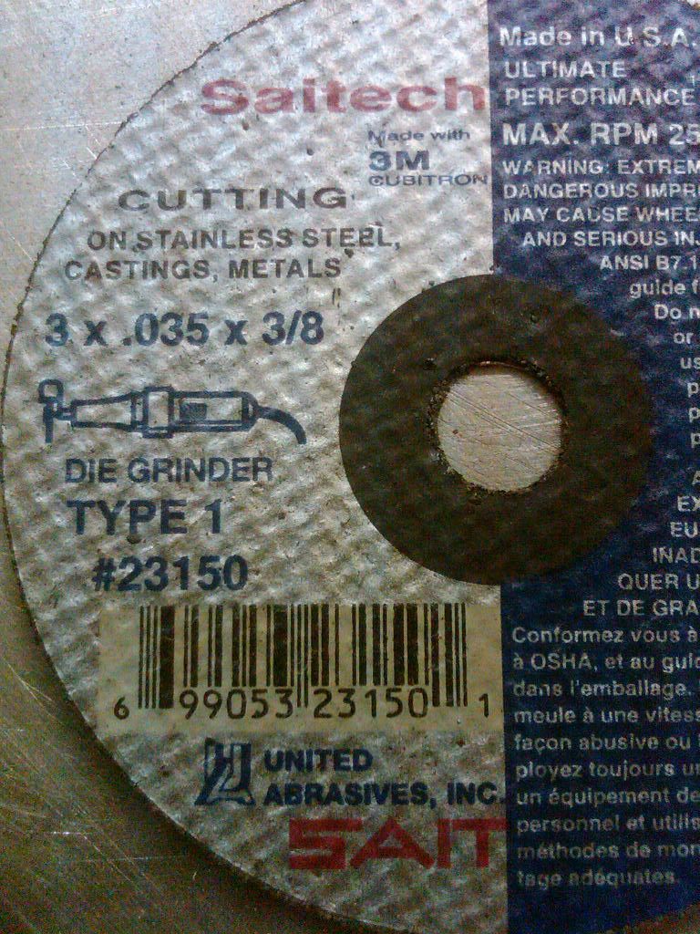

Rick, I've noticed similar results. But the added benefit to the more expensive discs (I typically use the ones rated for stainless) is that because the disc lasts longer, you'll have much less brown abrasive particulate floating around in the air, and less frequency in changing out the discs. When I see the no-name discs at flea markets any more I don't even slow down to look..

What brand and p/n do you use?
The name brand I tried was 3M "Green Corps".

05-01-12 05:27 PM - Post#2221279
    In response to Rick_L
Sait:
Robert

I'll try those if I can find them reasonably.
Thanks.
I never really thought about the amount of aluminum oxide and resin in the air vs. steel "dust". I'm not convinced there's anything noticeable.
