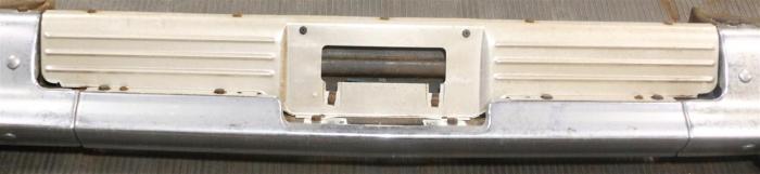

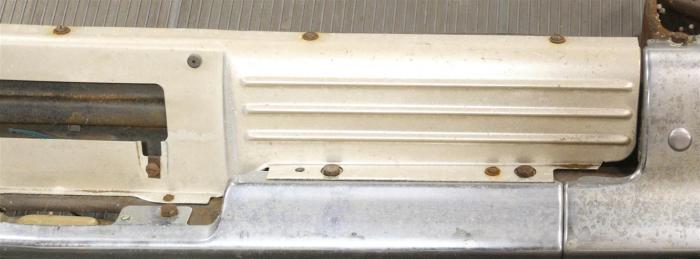

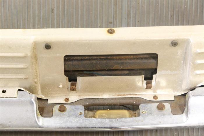

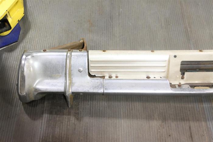

04-26-12 08:07 AM - Post#2219302
    In response to brucebodyman
Attachment: tag_mount__Medium_.jpg (55.5 KB) 16 View(s)
Attachment: tag_mount3__Medium_.jpg (89.68 KB) 17 View(s)
Attachment: tag_mount2__Medium_.jpg (125.26 KB) 13 View(s)
Attachment: IMG_8275__Medium_.JPG (105.64 KB) 11 View(s)
Rear bumper pics.

I just took my original rear bumper apart and I have never seen any clips like the ones shown from Impala Bob's.

04-26-12 10:48 AM - Post#2219343
    In response to mpris
The valance/liscense panel clips like those from Impala Bobs are correct for 62,63 and 64 valance panels.
I have about 40 - NOS GM clips in the original packages. they look just like the clips from Impala Bobs.
Use a pliers on the flat ends of the clips(hold them without squeezing them togehter). Push them into the hole -hold against the hole and then squeeze the clip flat, so the two flat surfaces touch each other. Sometimes the holes in the bumper and the new valance panel do not line up good and only one site of the clip will hold. The aluminum clips will break if you try to remove them after they are in place.
