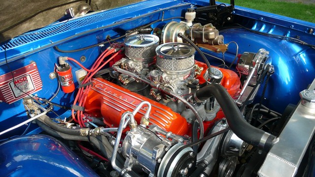

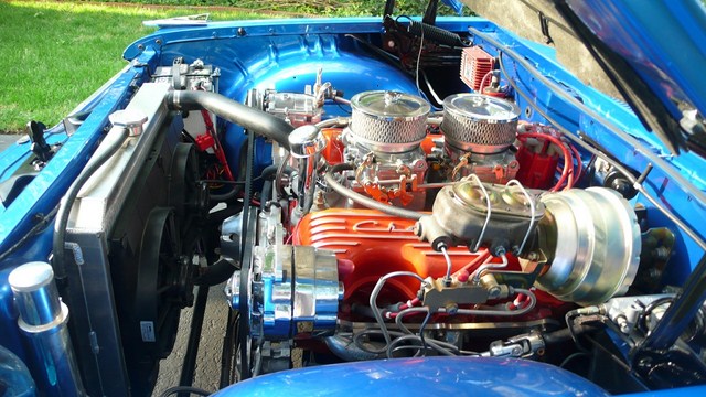

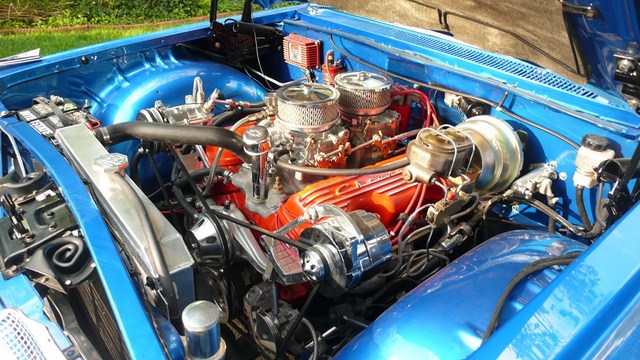

I have the same dual quad setup on my 409. Runs great. Large brake booster to the front carb vacuum port and the road draft tube converted over to a PVC connected to the rear carb. Idle is consistent. Seems to have no vacuum realted issues. I do have a crankcase pressure issue where it wants to push the oil fill cap up if I step on it a little. You can see how it tilts up in the pics.

I don't think it is internal pressure forcing the cap up. I have the very same aftermarket cap on my 327 and it does the same thing. I beleive it is the fault of the spring clip failing to keep the cap in place.
