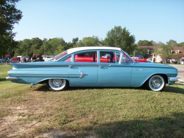

Last weekend I installed Jamco 3" loweirng springs and shocks all around. The spring rate is increase 30%. It drives evenn better than before.
I also replaced the D/S support bushing since it was shot.
I got her up on jack stands now to replace my front suspension bushings.

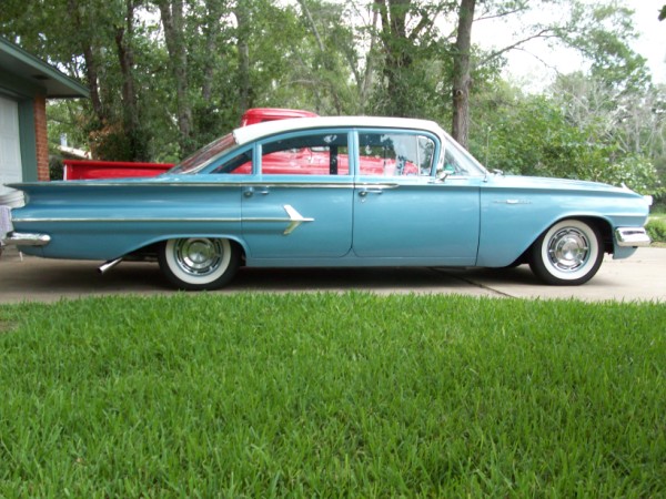

Just put my JAMCO kit in last week. The looks and rides amazing! I want to drive it all the time now or just stare at it..
60tuxblk
Posts: 7
Reg: 07-12-04
06-19-12 08:12 PM - Post#2239305
    In response to 60tuxblk
[image]http://www.jalopyjournal.com/forum/picture.php?albumid=26931&pic tureid=394312[/image]

I have to be careful of speed bumps&dips-my exhaust tips will scrape some but the stance is where it needs to be
Attachment: sunktheBA_002__600_x_450_.jpg (86.45 KB) 15 View(s)
Attachment: sunktheBA_003__600_x_450_.jpg (95.15 KB) 10 View(s)
Danny
1960 BelAir 4dr sedan, lowered3",235engine,3/4ca m,848head,2Carter/Weber carbs(TomLangdons),Fenton intake&Fenton headers,Wayne valve&side cover,BeeHiveOil filter,Pertronix ignition&flamethrower coil,3spd OD trans

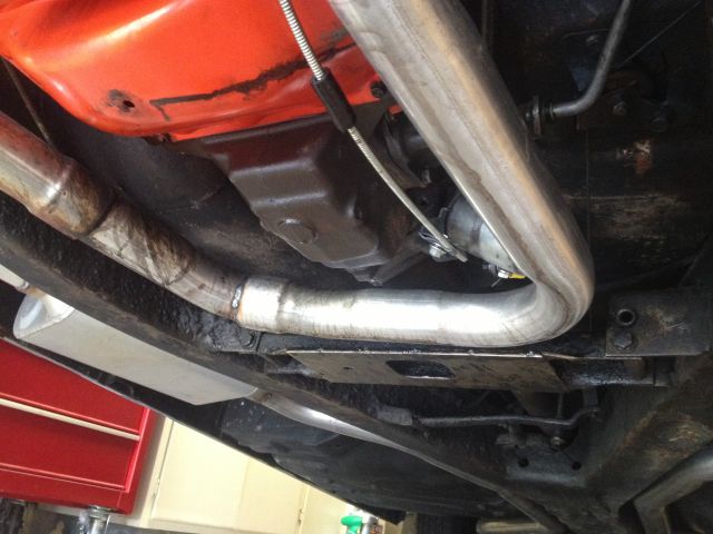

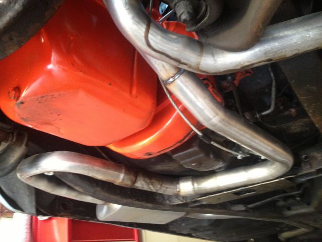

Went to harbor freight and bought one of those low profile high lift floor jacks.Maybe these will help.See how the pipe is "tucked up"so the frame is the lowest point now
Attachment: crossmember.jpg (59.97 KB) 2 View(s)
Attachment: exhaustroute.jpg (57 KB) 3 View(s)
Danny

Thanks Danny,
The pics help ALOT!!! I have a OEM Vette dual exhaust manifoly I am going to use.
Did you go with the Jamco Springs? I put over 5K on my car last somemer with no problems. Sorry to here of your troubles.
Also, I picked up a Carter YF 3211S to replace the origimal Rochester. LOVE IT!!!!! Night and day difference.
