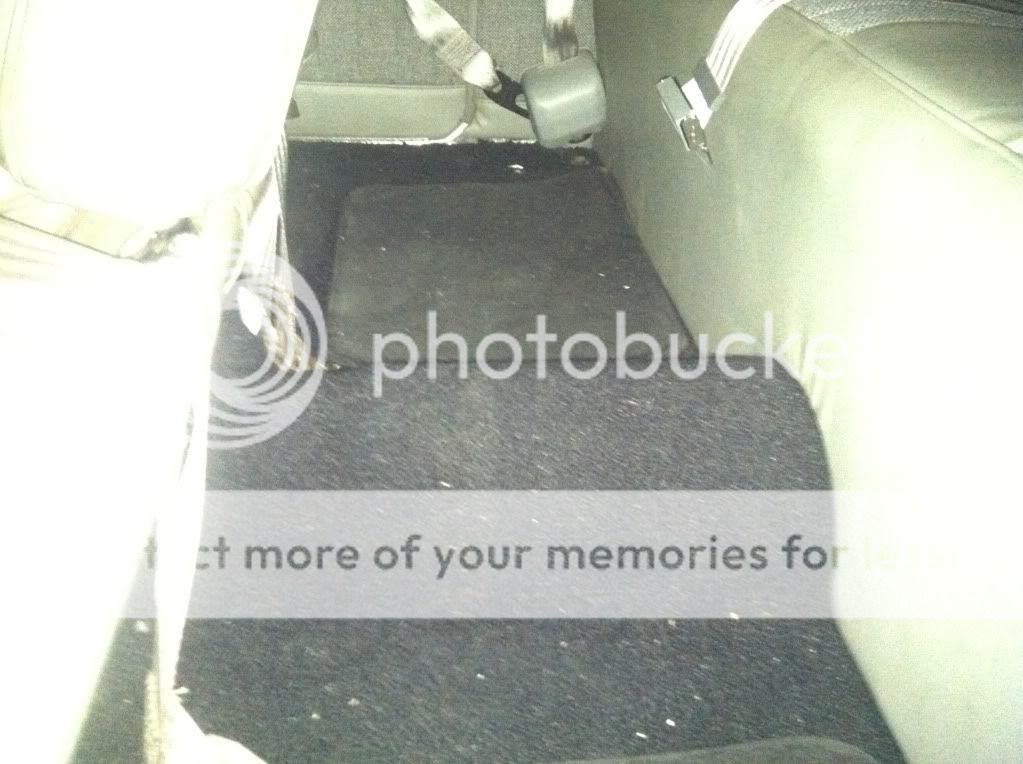

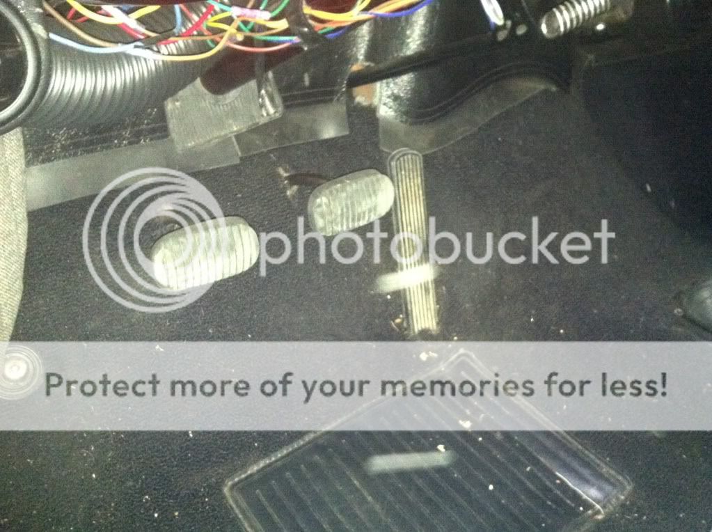

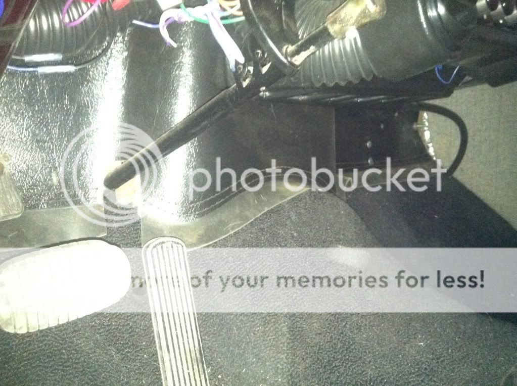

RhinoRay
Posts: 505
RhinoRay
Age: 61
Loc: Kelseyville
Reg: 02-27-07
04-14-12 09:55 PM - Post#2215215
    In response to Cruzin Okie
Hope this helps.

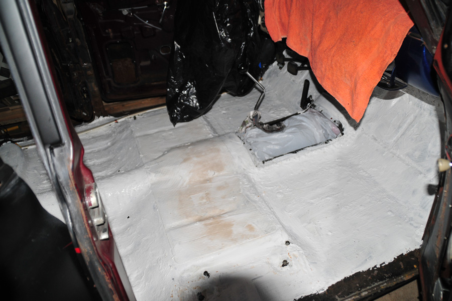

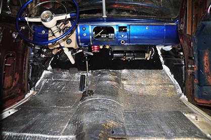

usmile4
Posts: 3081
Loc: Naperville, Illinois
Reg: 08-12-05
04-15-12 03:43 PM - Post#2215451
When I did the 49 and I plan on doing it the same on my 51, I used EZkool also. For the carpet, on the center above the trans cover, I just glued black indoor-outdoor carpet to the EZkool and ran it a couple inches on either side of the upper firewall on the edges. Then on the upper part above the toe boards, I took 1/8" hard board, cut it to shape to fit around the vent openings, steering column, e-brake handle, heater and AC hose bulkhead fittings, etc. I made one panel for each side and then screwed it to the firewall. I made the bottom edge even with the seam where the toe board meets the vertical of the firewall. Then the carpet from the floor just tucked up under the bottom edge of each of the panels.

usmile4
Posts: 3081
Reg: 08-12-05
04-15-12 06:13 PM - Post#2215510
    In response to OldDad
This is the Kool Seal coating that has been applied to the floor.
This is the EZ Cool and you can see the carpeted panels under the dash.
You can just see the edge of the floor carpet in this photo. I thought it tucked up under the front panel, but in this photo it looks like it was on top of the front panel. The floor carpet I believe was from NCA that the PO had put in the car.

Cruzin Okie
Posts: 565
Cruzin Okie
Loc: Jay, Oklahoma
Reg: 10-26-11
04-15-12 07:27 PM - Post#2215538
    In response to usmile4
Thanks, Bill. I think I see what you did, looks good. I am putting a Gen IV Vintage air in and think I'm going to have to have the carpet behind it. I am trying to get it as flat behind the dash as I can. I may try to do something like you have done though.

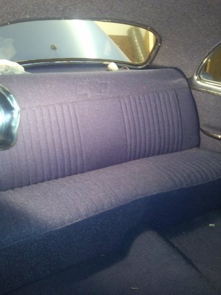

Cruzin Okie
Posts: 565
Cruzin Okie
Loc: Jay, Oklahoma
Reg: 10-26-11

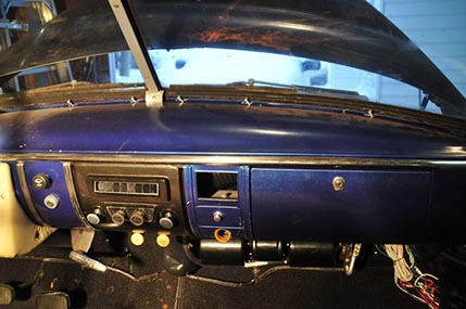

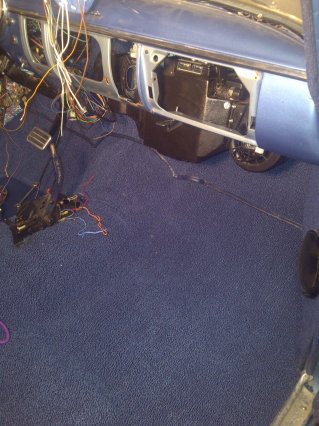

04-18-12 08:34 PM - Post#2216739
Attachment: 402156232.jpg (35.49 KB) 15 View(s)
Attachment: 402156243.jpg (23.17 KB) 15 View(s)
Thanks for the input. This is what I was talking about for the firewall carpet. I got the firewall carpet back from the upholsterer today. Stuck it in to see what it looked like, this is the look I was shooting for. Got a couple of wrinkles but I just have the A/C stuck up in there.
Got the back seat in too.
What do you think?
Johnnie
Johnnie
John 3:16
53Chevy
Posts: 163
53Chevy
Loc: Davenport, IA
Reg: 02-18-04
04-19-12 04:18 AM - Post#2216794
Johnnie: I got you PM.
That is a really clean look on the firewall!!!! I like it. Are you doing the a/c next? The way you are going you'll have it running for the wedding with no problems.
