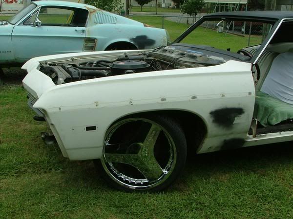

I began a new project to remove rust around vinyl roof trim but things quickly got out of control.

Looks like you got a little carried away. Now what is your plan??

Well Fossil a previous owner had painted her right over the original laquer without even prepping the surface, after removing all the emblems bezels and marker lights I found the original Ermine white. The current paint is horrendous,pitted bubbling and flaking not to mention all the fish eyes. At this point I'm currently going full bore prepping the old gal for a complete exterior repaint after fully removing all rust and repairing thee meetal work to the best of my ability. She won't be Riddler worthy, but at least cruise worthy and rust free. Sure would be nice to have a shop right about now.

I have actually removed crappy un prep'd paint jobs with a razor blade down to the original paint,there were some scrapes and such from it but it was faster and cheaper than using a sander and all the paper that would have been needed.
My last paint strip was on a 80 camaro that had been painted once badly prepped.I used one small can of air craft stripper and the stuff just bubbled right off down to the bare metal.

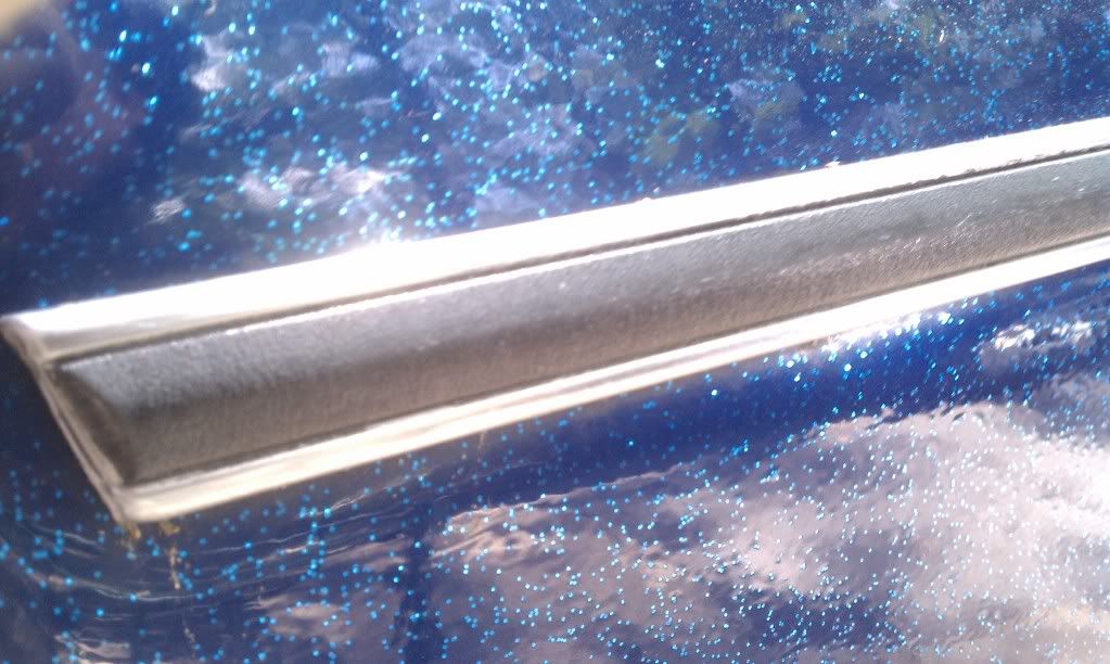

Ok today I made quite a bit of progress. BUT-can anyone tell me why the body side molding on the front fender is held on with speed nuts the entire length of the fender?? I wascable to remove the front fender extensions, the rocker panel trim and the door & rear quarter panel side molding but not on the front fender. what aggrivation! I sanded down the pitted fender extensions with 3 layers of paint got them smooth primed and chrome painted & cleared-came out great.

keep up the good work,those moldings can be quite irritating at times.Is why we removed ours and filled in the holes.

yea buddy, go ahead and remove that fender trim...if i can remember right, i started off accessing the area between the headlights and the inner fender wheel (under the hood) then i went inbetween the fender (door jam)..

Thanks I'll give that a try, from you pic I count 6 cliips I can reach 3 from front I'll ttry from rear saw 1 may be hardeer with door on. That's only trrim left besides on top lip of hood and can't see how that's attached. I redid fender extensions and headlight bezels with chrome paint and clearcoat I love the look better than chrome may end up redoing bumpers- kind of looks like pearlized aluminum.

PRAISE THE LORD. After getting the front 3 speed nuts 1 turn the clips popped out of the molding same with back 2 cause rusted nut to clip. one damn clip I could not access getting frustrated was about to just say screw it and snap trim in half wheh i dropped my hold the molding spun and last clip fell out back of trim. they are finally off needless to say they will be reattached using a much updated type of retaining clip. clips still bolted to car nothing a chissel and hammer won't fix/ only thing partially an obstuction now is the window ledge trim w squegee

More progress pics for you to peruse;
Painted inner fender and col lips and clearcoated.
Also painted & cleeareed door jambbs.

yeah its definatly tricky but wasnt too bad, i guess my bolts werent too rusty so mine just spun off.
i was going to fill my holes in with bondo, but noticed they popped out too easy and didnt want to weld each hole so i just put the trim back on and painted the trim from black to blue to match..
